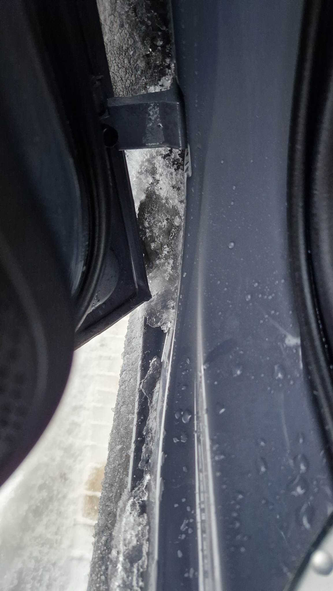

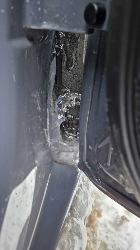

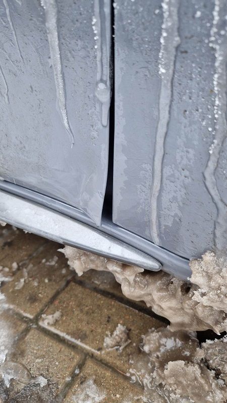

It seems there might be an issue with the car in cold weather. Apparently ice forms inside the door and by that I managed to bend the corner of a front door. Safe to say not feeling happy, since it was impossible to see from the outside before you open the door. Seems like a design issue on draining side, because the block of ice formed was massive (hence the bent door). I will be visiting the dealer tomorrow - to address the bent door and hopefully more importantly - how to fix the issue of it happening again. Looking it up in the internet revealed VW has had the same issue in the past and some models had a TSB issued, that included fixing a foam block in that location to not let the ice form. So I would like to hope this falls under warranty. But anyways - something to look out for when driving in the winter for Leon owners.

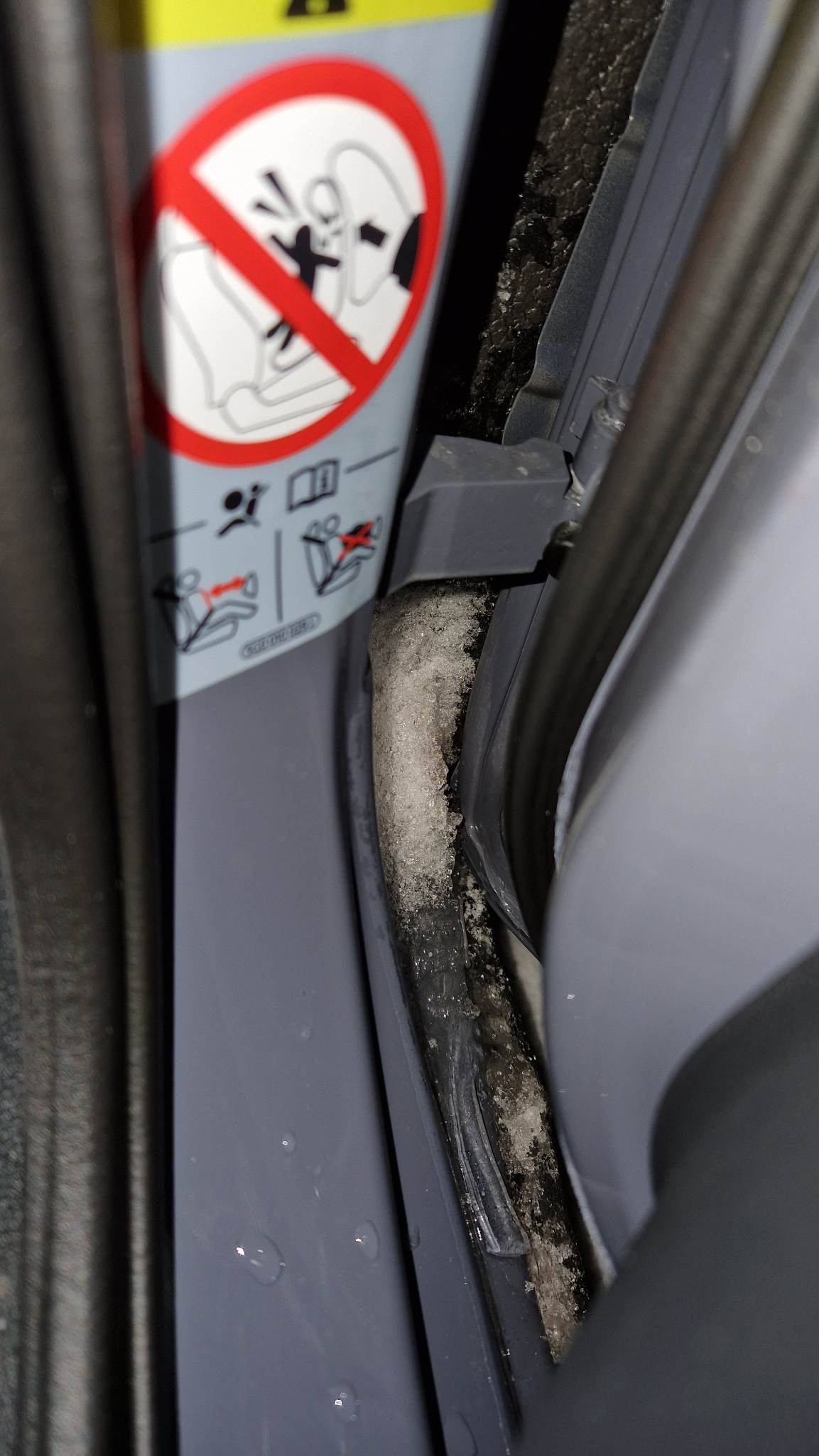

The issue with the door was solved a couple of months later with a new door and a paintjob. To all that are interested - Cupra did not recognize it as a warranty case (!), but the dealer was kind to accept the issue and do the repair. All in all - I'm glad it got sorted, but safe to say I'm not feeling confident in the upcoming winter and warranty terms, and probably will check the door sills more than a normal person should.
It's worth mentioning, that the ice build up was not a one-time thing. It happened 2-3 times during the winter, but since now I was aware of the problem, I kept an eye on it and used warm water to melt the ice down before opening the door (funny enough - I did not find a chapter on that procedure in the owner's manual and did not know it was a prerequisite for owning this car :)).
For anyone living in a colder climate, I would suggest keeping an eye on this issue and would be good to know, if other people have had that problem.
Added a couple of photos, how the build-up looked at other times.
