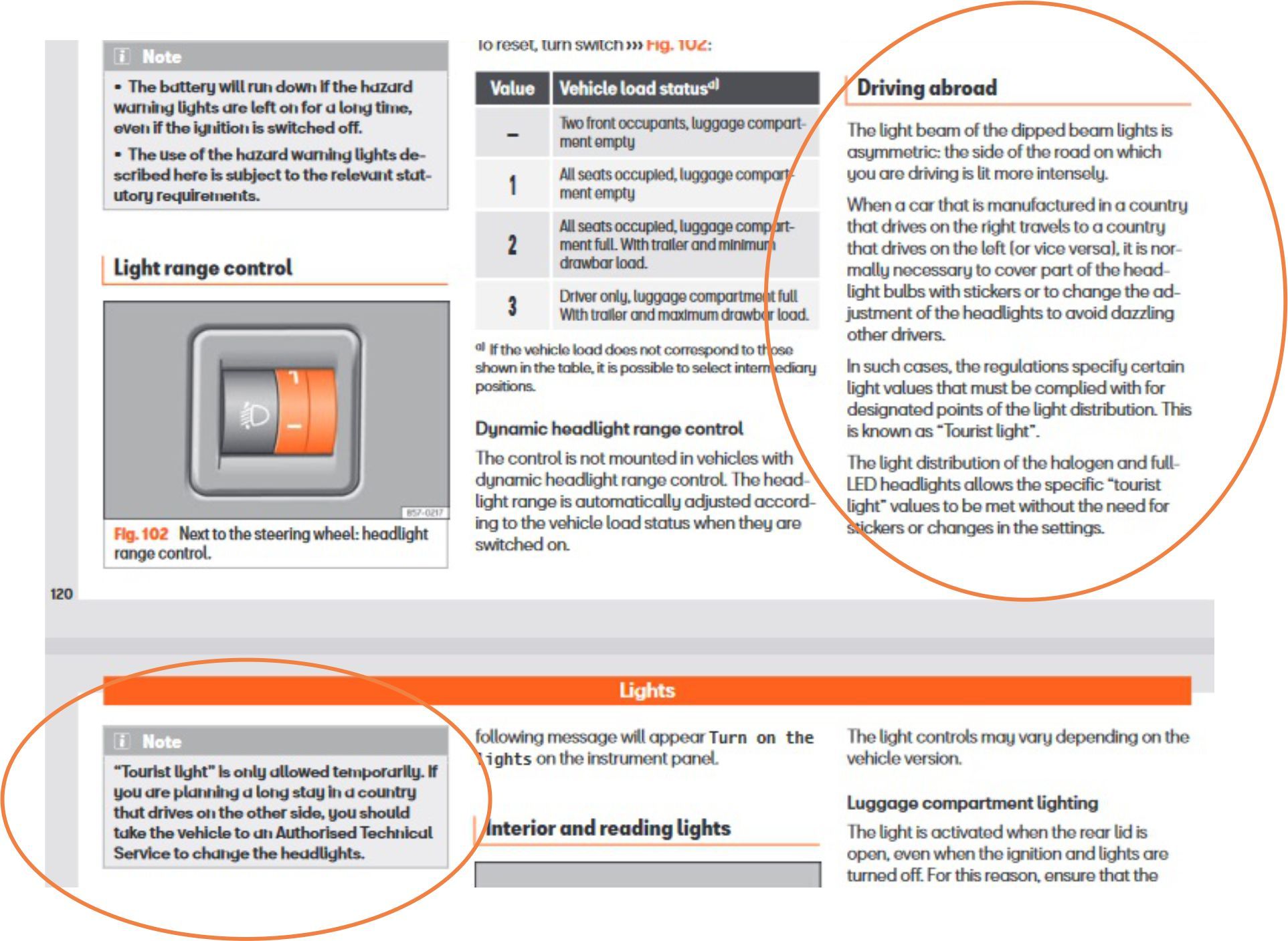

Hi - I have a late-2021 (post-facelift) Ibiza FR 1.0 TSI 110 with "Full LED headlights" and will be going on a long road trip to France (from the UK) in a week.
When driving in France, is there a setting I need to change to avoid dazzling other road users with my headlights, or is this not necessary with the Full LED lights? If there is a setting, where is it?
Also, is it possible to have the small central display between the speedo and tacho to display speeds in KM/H? Thanks!
Is it covered in the owner’s manual?
I don’t have an Ibiza so can’t answer your question. However, you could check in your vehicle settings via the infotainment screen to see if there’s a setting to switch the headlamps from driving on the left to driving on the right. Some VW’s have such a setting to alter the headlamp beam for driving on the opposite side of the road when in countries where the norm is LHD cars driving on the right.
From the November 2020 owners manual:
