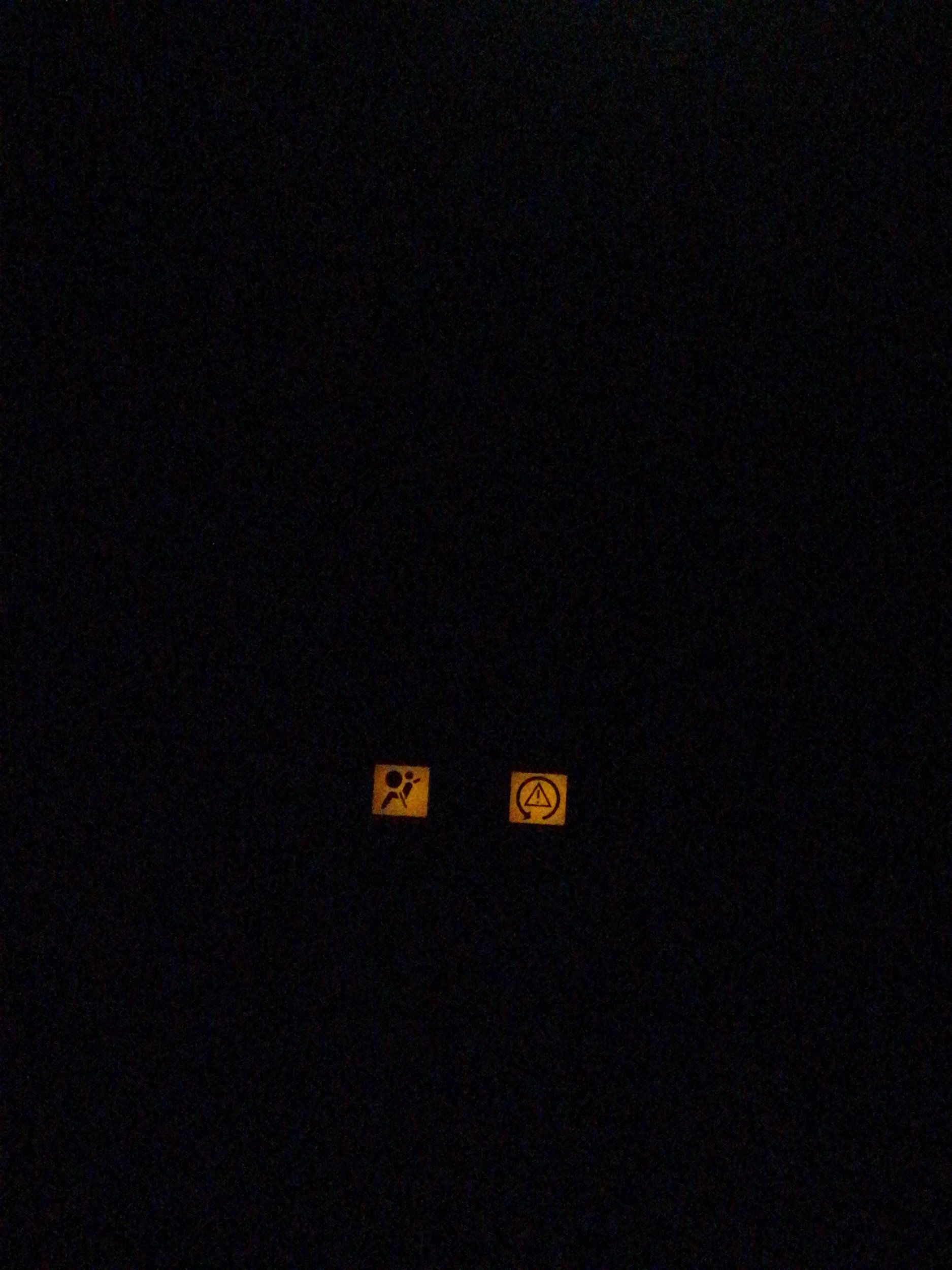

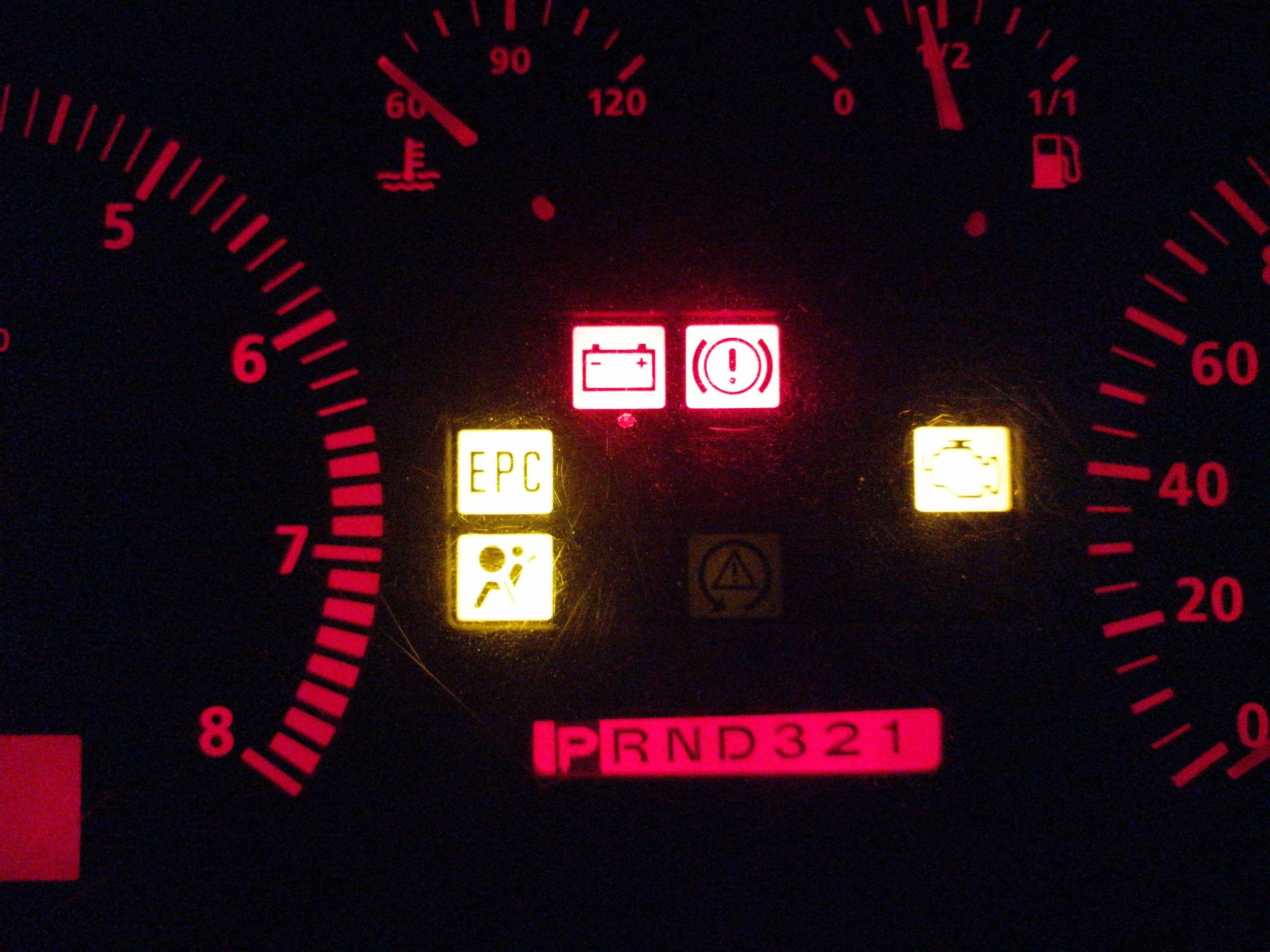

I have taken a few pics for you guys. When the car is turned off and the key is out of the ignition, the airbag light and TCS light are on. Sometimes they or the whole backlight of the dashboard turn on or off again or start flickering.
When the ignition is on, the TCS light still lights up, but it is very dimmed.
While the ignition is on, sometimes the fuel gauge goes to 0.
My car also started with beeping in the morning today and the red light for the engine temperature started flashing even though I just started my car and there was still enough cooling fluid.
After I came back from work, the symptoms of beeping and the red light flashing where gone. These are all problems that come and go again.
As I also mentioned, my car really smells damp and these symptoms all occur when there has been a lot of rain. After a long period of having the sun outside, most of the problems are gone again.

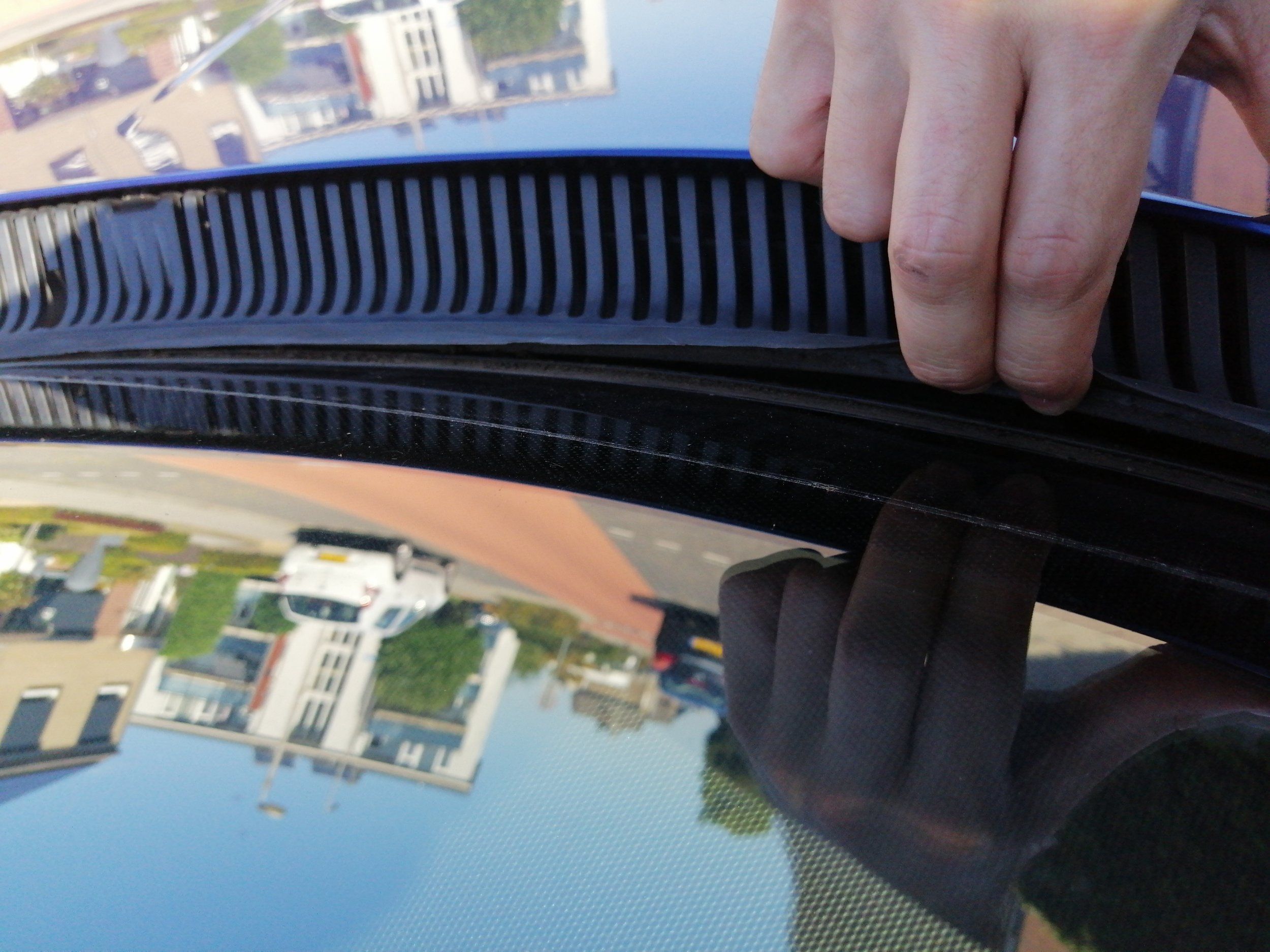

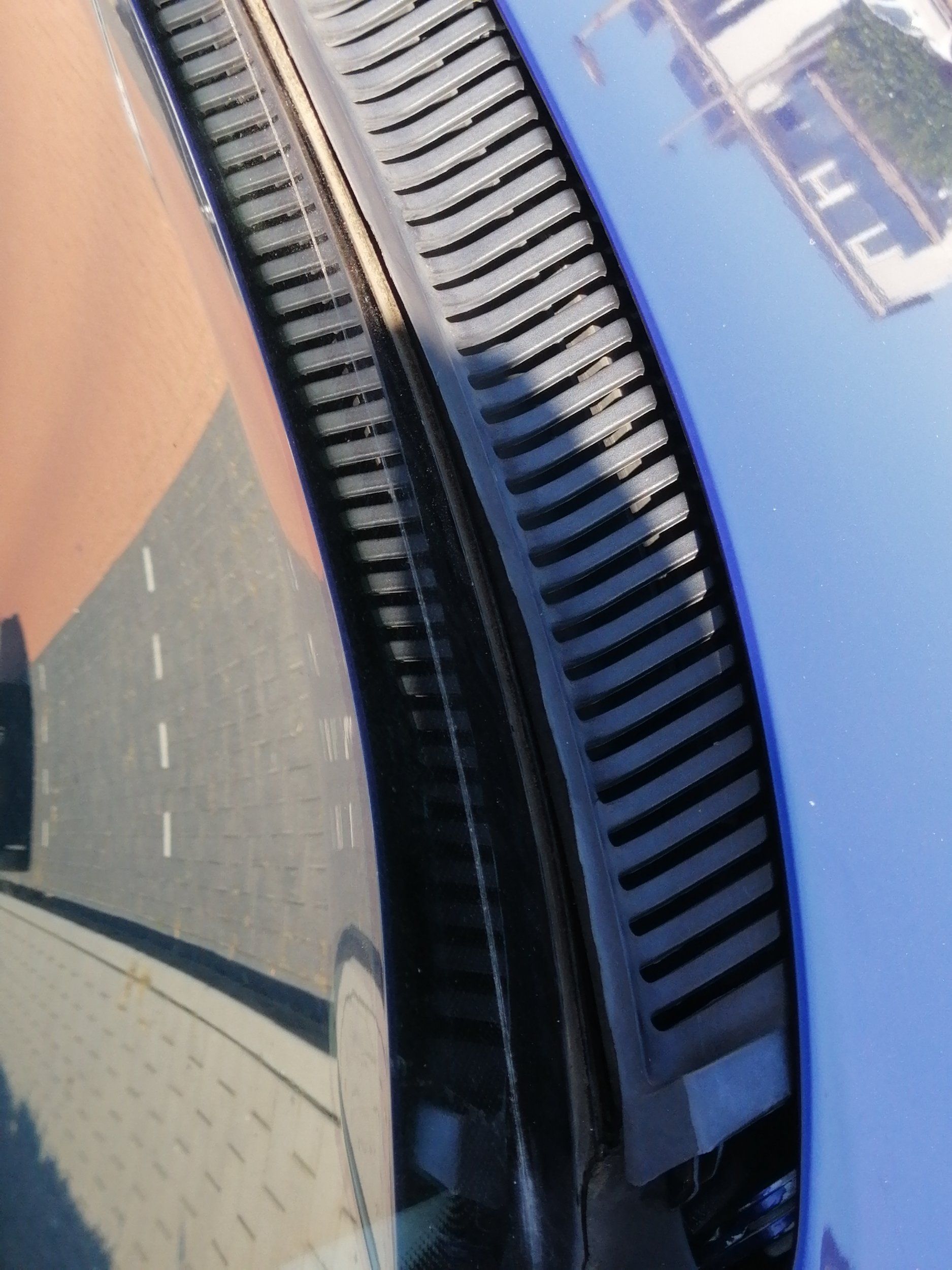

You mean that this seal is the problem? If so, I know enough and will give it a try tomorrow. Bought butyl tape too, except it isn't the same as the door seals.

MoToJoJo
Mar 25, 2014
823
653
Northants
No.
Under that you'll find a cover with a black bundle of wires coming out. That's the problem area.
Once you have access to it, undo the 2 10mm nuts, lift the cover and you will see if the seal is gone. If so, clean up the area, apply the butyl tape (be very generous with it), put the wiring back, tighten up the two nuts and that should do it
