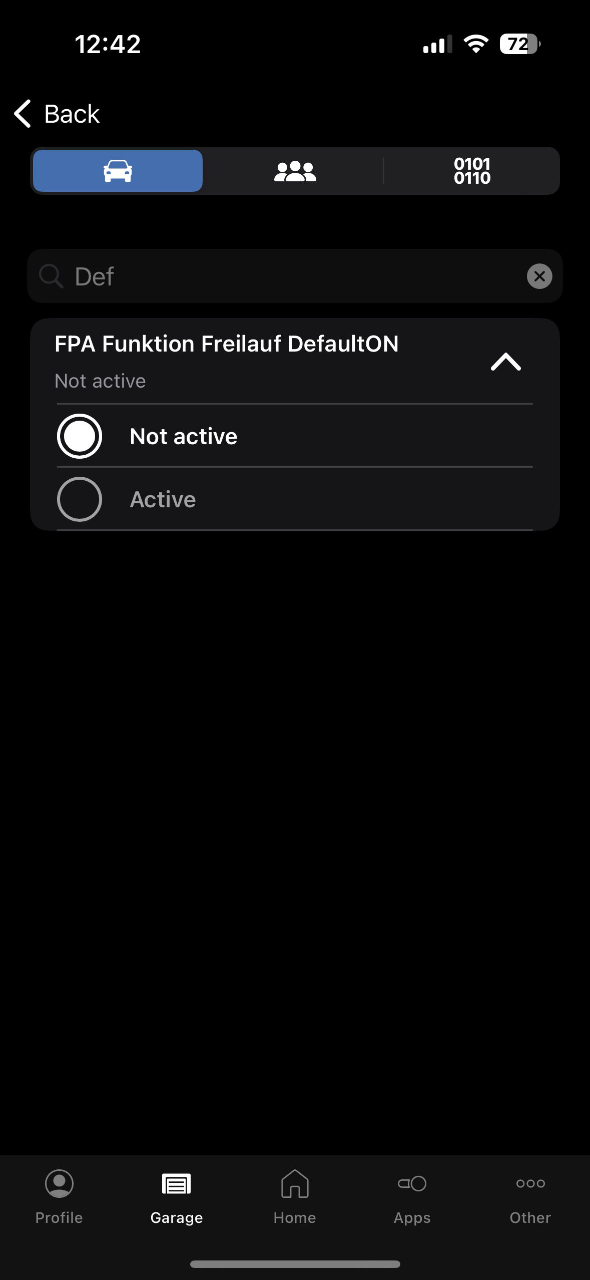

Thank you so much for your very comprehensive answer. I found a procedure online for deactivating inertia mode.
https://forum.obdeleven.com/thread/9155/disable-sailing-function-normal-profile
Unfortunately I don't currently have any tools to do the coding 😕
