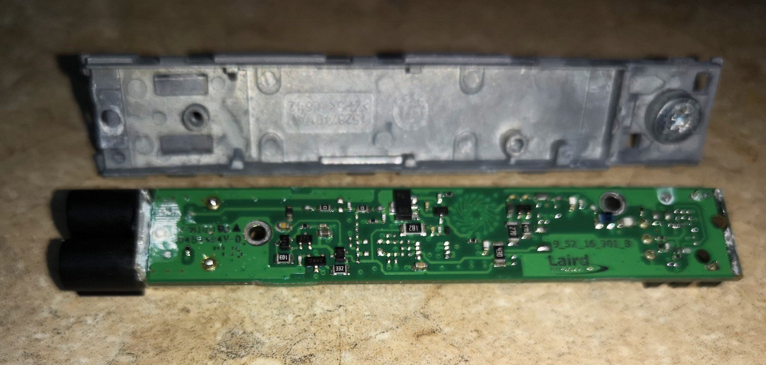

Fitted a new DAB amplifier yesterday, I wrapped it in cling film and covered it with insulation tape, as I suspect it shorted out due to water getting into it. Anyway after fitting all DAB stations now working.
Took the faulty amplifier apart to see if I could see any signs of water ingress, and there is white residue on the circuit board, could this be water that has done this.

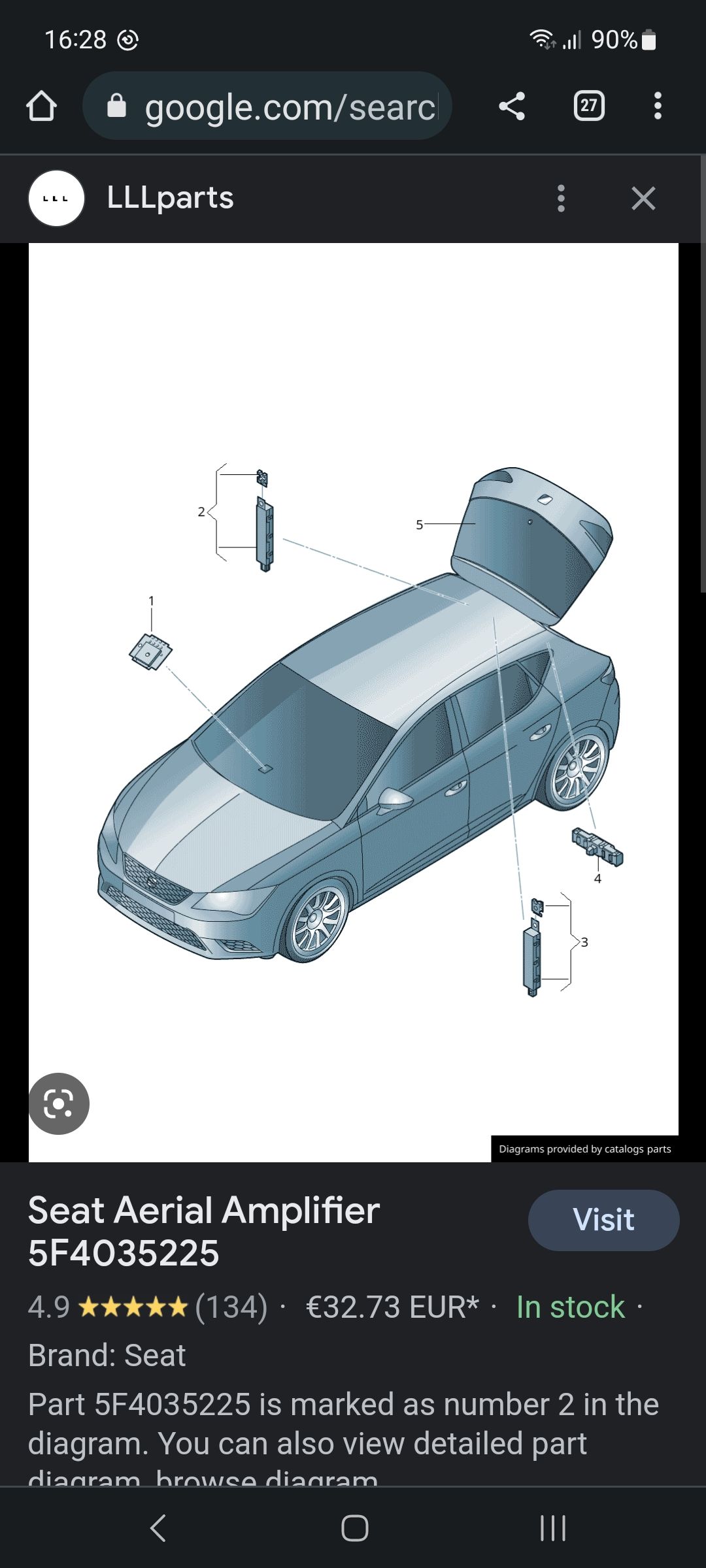

Hi mate, the part number I needed for my car is
5F4035225B had mine from Seat parts direct, hardly any difference in price from main dealer prices, chose them because my main dealer is 20 miles away and I had it delivered for £61 I think

Quick update,
Took the faulty amplifier apart to see if I could see any signs of water ingress, and there is white residue on the circuit board, could this be water that has done this. View attachment 35299
That's definitely water damage.
