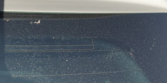

Looked on hatch I have can see additional lines / wires in glass on rear hatch window top drivers side 3 extra lines going towards the centre varying lengths assume this some sort of aerial but on the ST I also have no additional lines just the normal heated window lines..
Is Hatch to ST different for location of aerials both 18 model years and same variation DAB and normal FM aerials or are these 3 wires / lines unrelated

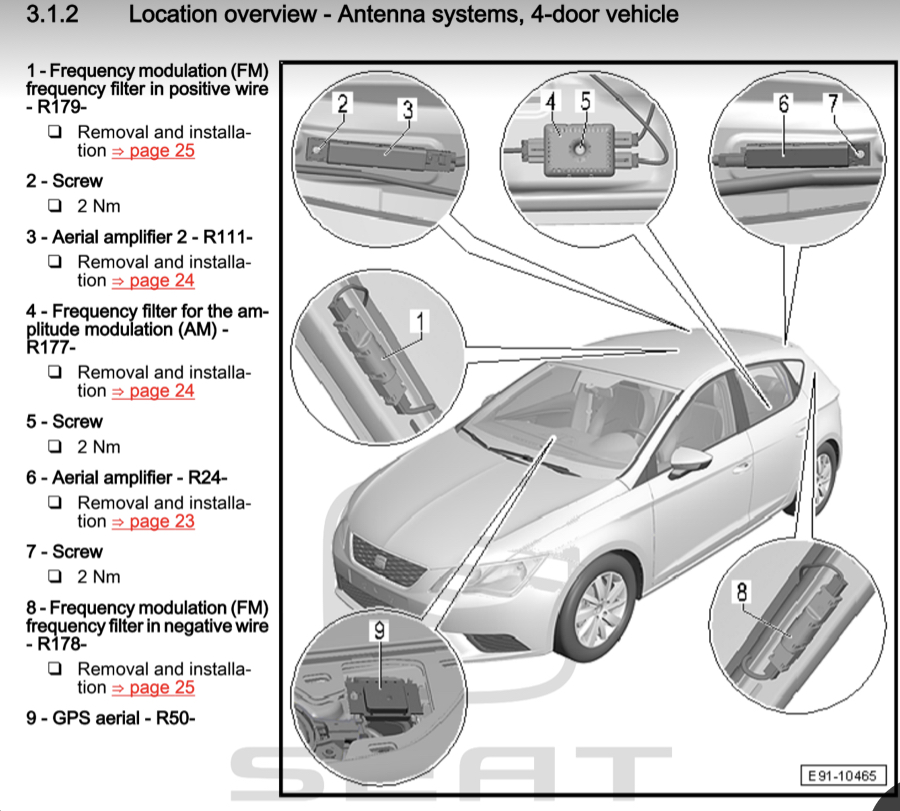

In response to the locations of antennas, locations should be the same for hatch and ST according to the workshop manual (attachment is from the ST manual). I have just had a quick physical check of the car too, because antennas were usually built into the side glass rather than rear screen on most of the estates that I’ve owned recently.

Seems the hatch has some little extra look like heated window wires top right (wife’s car) but my ST does not and nothing in the sides as like you I assumed that too... was assuming be the same and guess you have estate also... see pic hatch
