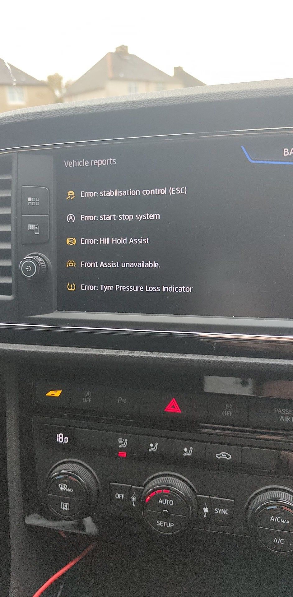

I've got a 2019 Leon Cupra 290, had the car for a year and it's got roughly 29k miles. I've had the car for 1 year now and had 0 issues with it until today.

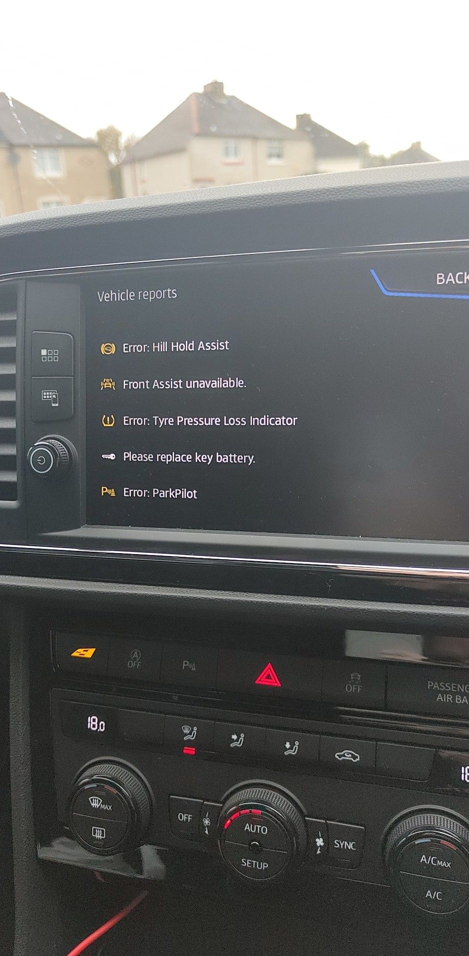

Got in the car and as soon as I started moving I got multiple errors pop up one after another.
Attached photos showing all the errors, the change key battery was already there for a couple weeks.
Has anyone ever experienced something like this happen with these cars before. Just wondering if there's a known issue before I start going through the hassle of taking the car to the dealer.

If you dashboard is lit up like a xmas tree its probably the ABS Speed sensor (I have had that twice). Do you have access to a code reader if so that should confirm it.

There was a bunch of lights coming on the dash as well yeah. I don't have a code reader myself but can get access to one. I'll give that a go, cheers for the advice.
