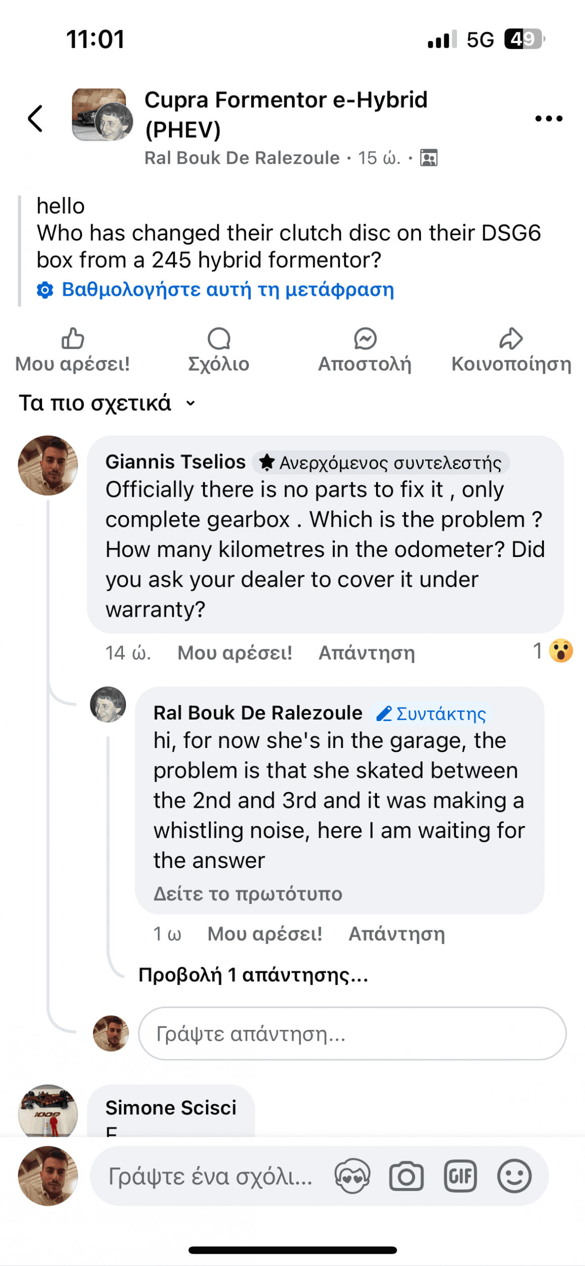

I have too a 1.4 VZ 245 Hybrid , i didn't understand any ''whoop'' noise or clutch slipping , BUT just to know that the E-Boost is just for 8sec at the 245 version , then you have power down because the boost from the electric motor is much lower , you can feel it that the power drops BUT you can get again power if you release the kickdown button and press it again , i can do it without leave the throttle .
