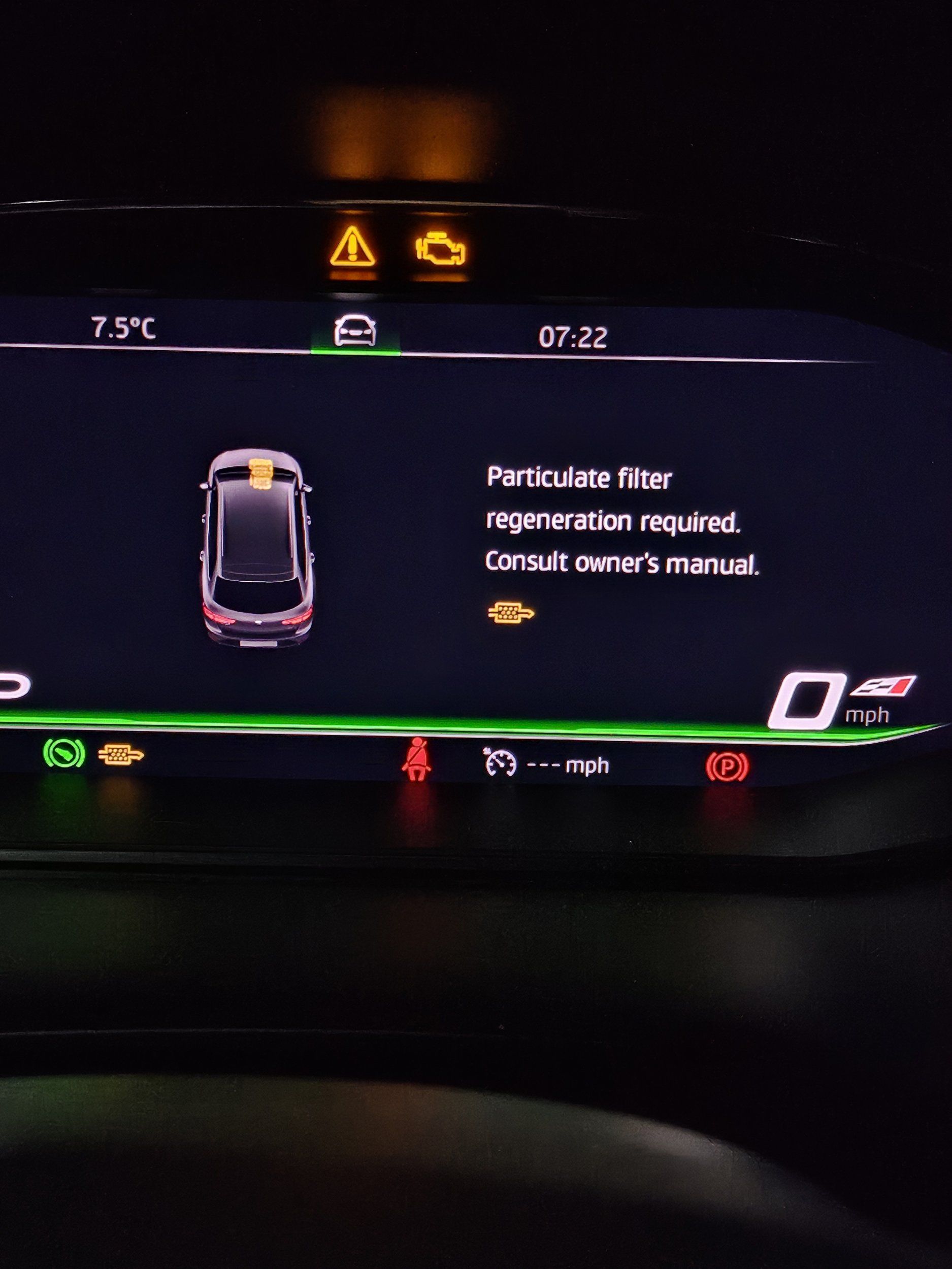

Hi all so I got this message on display this morning probably my own fault for having car idling for ages. I have done as it says in book but the light won't go, anyone else had problem and sorted it out. It's got the GPF.
Thanks?

I had this after the car never moved for 3 months. Dealer told me to take it out and thrash it…..cleared after 5 miles.

Thanks pal yeah doing what it says in the book does nothing, went out gave it some and cleared after 10 mins

My VW has a GPF and decided a forced regeneration was necessary Thursday just gone. I think it was the third one in just over three years. Lasted around 20 minutes and the ‘tell tale’ signs were there; louder exhaust note, slight hesitancy / lumpiness to the engine when accelerating and significant worsening (around 30-35%) in fuel consumption. I’ve never had the same or similar warning message to @DaveMac though.

Yeah exactly that pal I have a full straight through sport exhaust and it because stupidly loud and I was thinking what's happened here and there was a massive flat spot in performance then next min that message flagged up on dash board. Its sorted now after 20 mins of heavy foot in sports mode it gone
