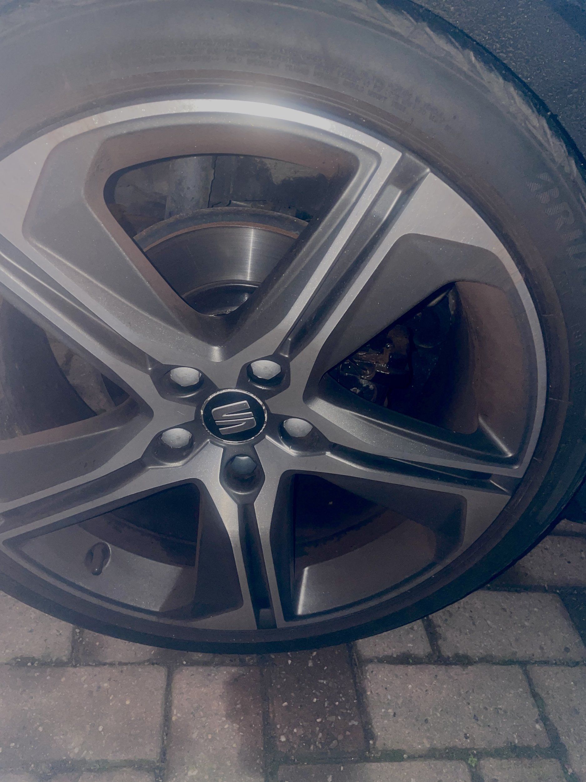

Here's my rear discs, they are just over 2 yrs old and i do around 5k a yr, mainly a to b with very little spirited driving and no rust issues.
There is scoring but other than that they're fine.
