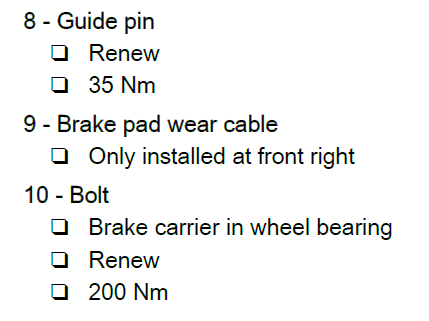

Yes, I tend to clean up and apply new blue Loctite to callipers that have "bolts with blue Loctite" bolting into guide pins.
Some of these calliper carrier to hub bolts have something similar to NORD-LOCK captive washers on them, so as well being "torque to yield" in the case of the rear ones, I'd always replace if there were any locking elements built into fixings.
The front ones having a 200Nm torque figure, even where not advised to replace, I'd always replace, even if only to get rid of a rusted up headed set of bolts.

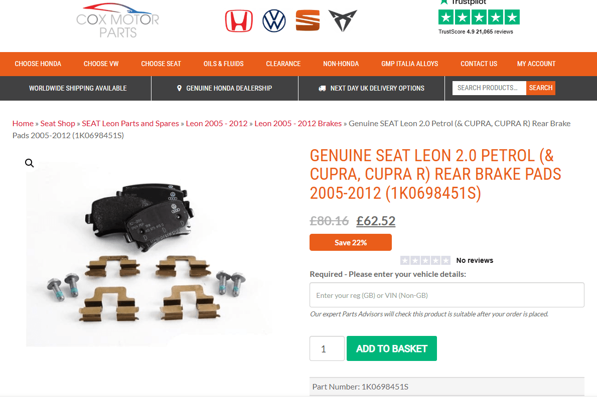

The rear pads don't come with the anti rattle shims either - I had to buy some Mintex MBA1679 for my Cupra 280 ST.

When I bought mine from the forum sponsor Cox Motor Parts back in 2023 they didn't come with them. The parts advisor checked all their boxes of pads and confirmed they weren't included. Cost me £14.15 for 4 delivered which was quite annoying as I could have saved on the postage if I'd known they needed to be ordered separately and could have been included in the original pad and disc order.

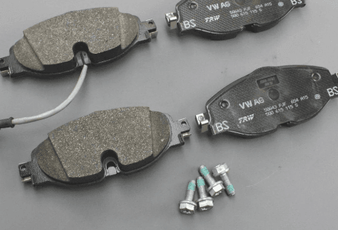

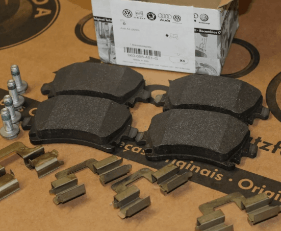

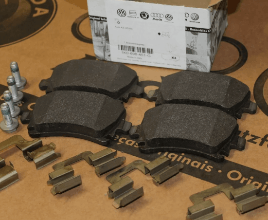

Not sure what parts you have brought - but the OEM pads do come with the caliper abutment clips & bolts.
strange:

I don't work in the dealer network so I can't vouch for whether or not VW / SEAT have decided to become more generous in recent years and started including bolts and shims again. It was just a bit of an unpleasant surprise to find them no longer included as it meant additional hassle and expense I could have done without.
I would just recommend that anyone seeking to buy these parts checks whether or not they will be included and get them sorted as part of the same delivery package if needed so as to avoid unnecessary further postage.

Just a heads up - when I changed the rear discs on my Cupra 300 - The discs came out without removing the caliper carrier.
Also managed to get the new ones in the same way.
My sons 184tdi with the 272mm rear brakes needed the carrier removing to do his discs.
Useful info if in a pinch - but I would always recommend undoing the caliper carrier bolts at each brake service from a corrosion point of view - if left a few years they can get very hard to remove.
I did my Audi A4 quattro rear brakes and couldn't remove the caliper carrier bolts as it has even worse access than the Leon with it's 5 link rear axle and driveshafts in the way - so I just slid out the old disc - and slid in the new, to find the new disc binding on the carrier! Corrosion had distorted the carrier enough to bind on the new full thickness disc, and that also made the bolts mega tight!
