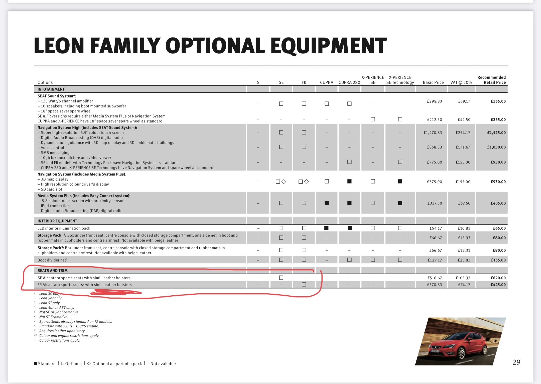

@hewittinspain; Page 29 of brochure at the link below is from 2015 (same year as your car) suggests the seat side bolsters on the optional alcanata seats in the mk3 Leon FR are simulated leather (i.e. vinyl) and not real leather. I don’t think applying a leather care cream to vinyl would help to prevent it splitting. It might be worth speaking to a car upholstery re-trimmer who could replace the cracked section of the bolster with new vinyl, matched to the existing vinyl. An upholstery trimmer would also be able to advise if it would be possible to patch the cracked area - glueing a vinyl patch on the reverse side of the crack so it can’t be seen, which would strengthen the damaged area and close up the edges of the crack together. My preference would be to replace the damaged section.
Screenshot below of the relevant page from the brochure;

Yeah, it's not real leather. The cloth backing is probably quite tough though so I'd be tempted to leave it, could be a long time before it actually cracks.
Or what you could do is take the cover off and glue a strengthening piece on the back?
