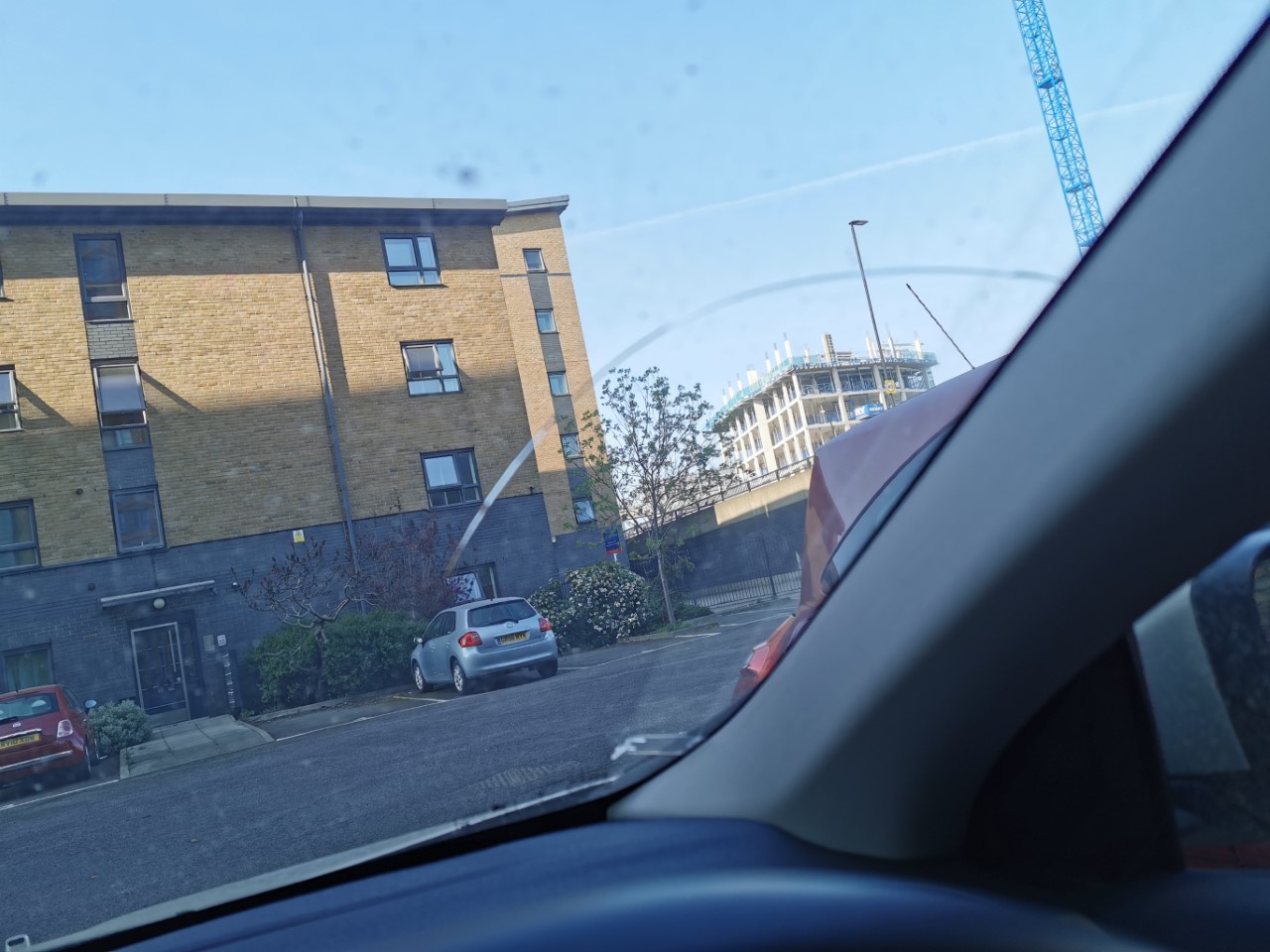

Just wondering if anyone has any advice / experience on cracked windscreen. Crack is about 20 cm, outer layer only.
From your experience (if any) are these usually repairable or full windscreen replacement? I am aware these don't affect NCB, and excess is £10 - £75 depending if repair or replacement. I suspect it cracked as a branch from a nearby tree fell and hit the car there. Found few large branches around.
Do you know if it also needs to be car / brand specific glass?
THanks!

Definitely not repairable and illegal to drive with it like that i believe.
Had mine replaced Christmas eve by Autoglass did a good job but used non Seat/Pilkington branded glass, AGC Automotive who apparently make a lot of OEM glass.
You also need to make sure it's correct for the sensors you may have on your car, and may need calibration as well.

As @Walone has said, the damage is far too extensive for a repair, so screen will need to be replaced.
The article at the link below explains the extent of permissible damage for MOT purposes in ‘zones A and B’ on the screen;
https://www.rac.co.uk/drive/advice/car-maintenance/how-to-deal-with-damaged-windscreens/
IMO, a windscreen without Seat branding is likely to be as good as an OEM Seat branded screen - many of the unbranded and branded screens are made by the same manufacturer in the same factory; probably the only difference being the Seat Logo on the branded screen. If you insist on a Seat branded screen, you may find your insurer applies a higher excess than they do with a non branded screen.

I'd ask SEAT Ensurance, they might be able to assist with sourcing OEM glass. They negotiate with your insurer to make sure any repair your insurer authorises is completed using OEM parts, and where possible, at a SEAT approved vehicle repair shop. They offer the service free of charge whether you have Seat insurance or not since they probably make a premium on making sure you use SEAT parts.
https://www.seat.co.uk/buying-guide/insurance/ensurance.html
