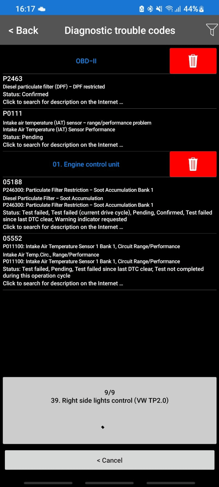

I got a code p0111 a while back, iat sensor is bad, it shows 130 degree as temperature
I deleted the error twice thinking I will change it soon enough and forgot about it, didn't drive for 2 months
My dpf light then came on when i did drive it, because it hasn't regen in 900 miles and it woudn't regen, tried stationary regen and running regen all failed, forced 3k rpm for 30 mins no joy, only the first stationary did go on for 20 minute and temp went 570 degree, went from 38 to 33g, now my temps won't go over 270.

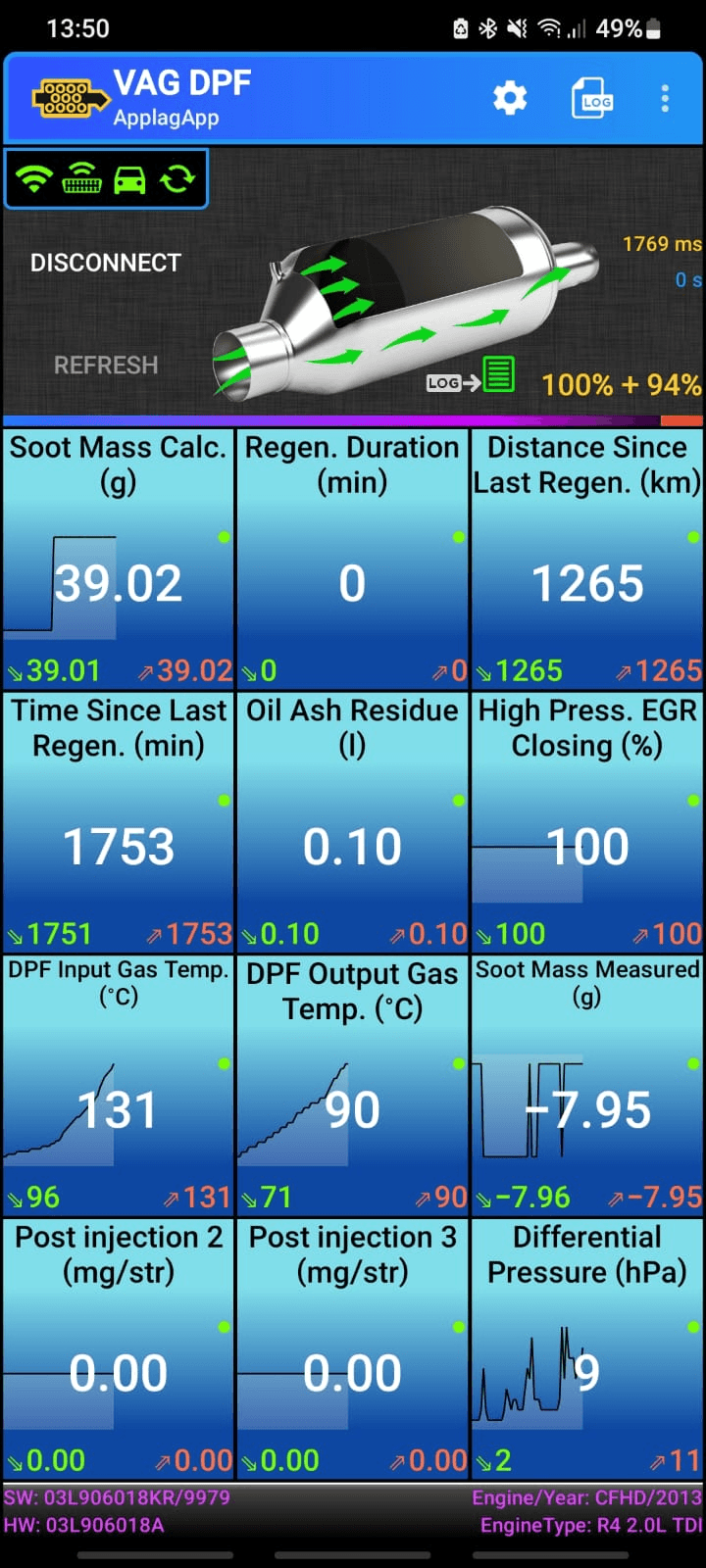

My soot calculated is now 45g
Soot measured goes up and down -5 -6
The pressure is 4-5hpa when is idling at 800rpm and 10 when idling at 1000rpm and goes up as far as 58 in 4000rpm,

Will insert 2 pic, they're older info but close enough

Standing Regen still starts as it's 44.5 soot but stops after 15 minutes .
I used an app, car scanner to start the regens, the standing one worked(started) so I assumed the driving regen also started and drove it hard for 40 mins several times, no joy.
