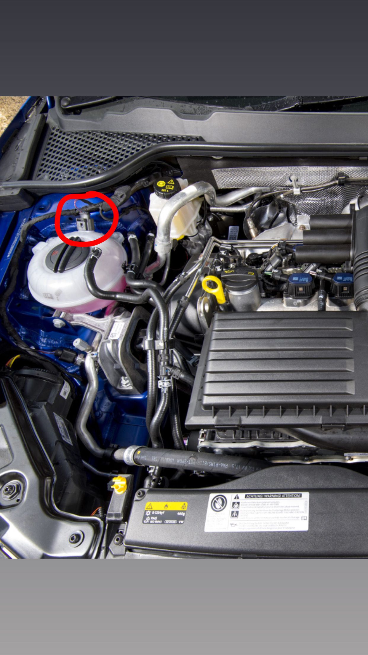

Have a look here - it may help
Reactions: tony20

Still having problems with this, changed the coolant temp sensor, paid £800 to replace the thermostat housing and waterpump.. 30 minutes after picking the car up from being repaired.. boom engine management light- P2681.. I'm losing the will to live.
i had the same issue but thermostat housing fixed mine, i used a 538036010 from ebay and just paid garage for labour.
you may need the n82 valve as well it shows the same error, or maybe the plug to the thermostat was not cleaned properly when they replaced it as the old one leaks onto it. 4H0121671D is the n82 its at the right side of the engine you will need to take the airbox out to get to it.
it`s a pig of a job to get to the plug for the thermostat underneath i cleaned it with electronic cleaner and fault went away for a few days but came back. i reckon they did not clean it properly or the n82
p28100 is the thermostate housing
p2681 is the n82 valve
This fixed the issue thanks Dean0, after changing the thermostat and water pump, I was still getting the error code.. after showing this to the mechanic it's now fixed and the code has gone :) cheers mate
