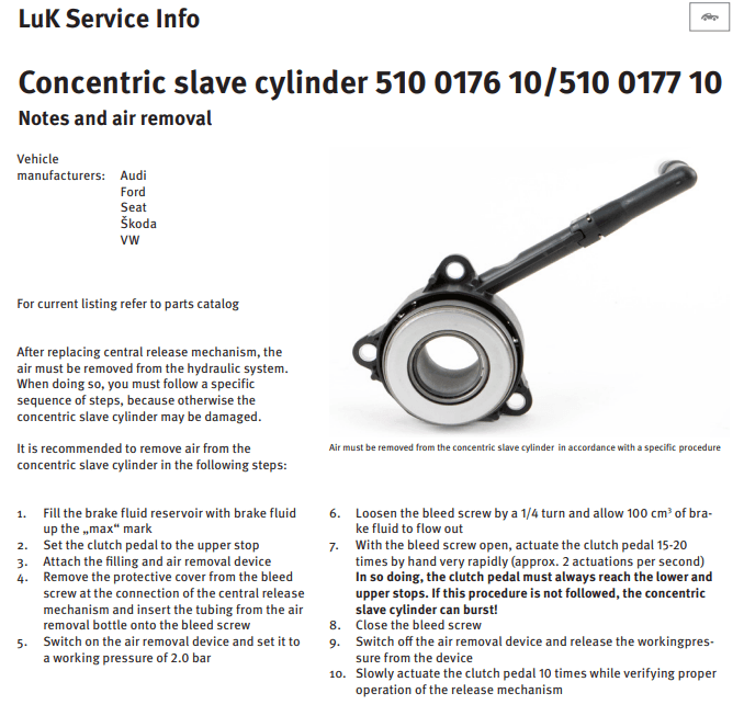

For the clutch pedal to stay down - it must be either a cylinder seal failure/contamination or air.
Seems like it has been bled several times so my vote would be seal contamination or failure.
What parts were fitted - genuine or aftermarket? Failure of new parts is rare - but not impossible, much more likely contamination of the seal.
Did the garage flush out the clutch hydraulic hoses - both the feed to the master cylinder and hose from the master to slave? I would guess there is some contamination of your seal caused by crap in your fluid, causing an intermittent internal leak with one of your cylinders.
#edit#
I have found some service info from LuK on a specific bleeding procedure for the concentric slave cylinder.
Apparently if the CSC is not blead properly it can burst!
