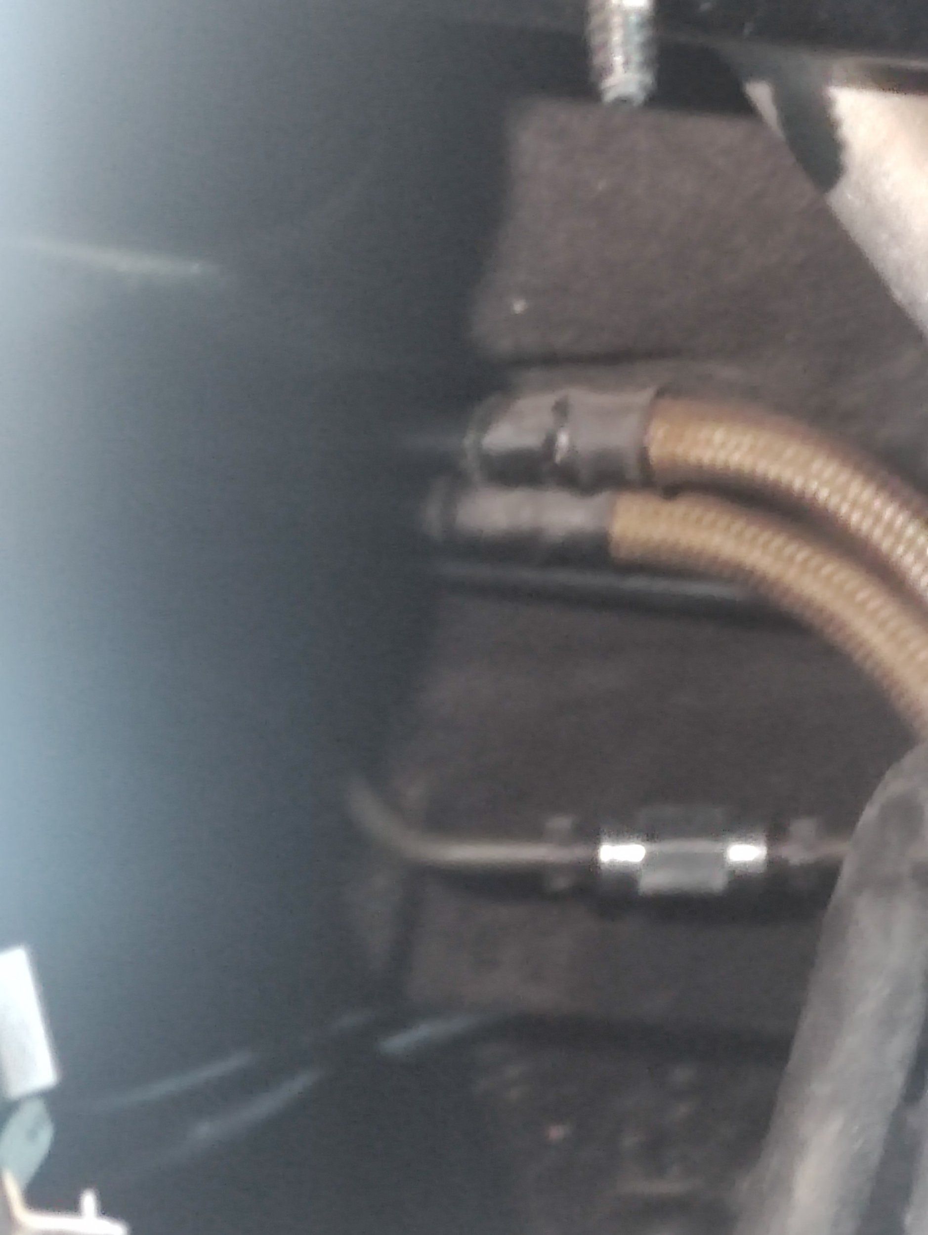

Hi. I need help. My car broke down in Frankfurt. This part is leaking fluid. Can someone help what is the name of it. Can you just disconnect part in blue circle and what is the part number.
Whole pipe numer is 1J2721465BA
No longer in production. Because Im abroad and whole pipe is for RHD im wondering if I can find and replace part in blue circle.
Any help appreciated.

It's the clutch pedal damper valve and it comes as part of the whole pipe.
It looks like it is not serviced or sold separately, there is no separate part number for it in the official parts catalog.
Not sure but people says clutch would work without it but driver would feel a difference in pedal pressure.

So if it is possible to drive without it. I will look for whole pipe system from LHD and replace valve only.

Only if a mechanic says it's OK and he is able to complete the hydraulic circuit without that valve i.e. connect the loose ends of that pipe together after removing the valve.

It looks like this valve is only in RHD vehicles. I couldn't find it in LHD. And german mechanics refuse to remove it because of law.

Bypass done. There is no change on clutch feeling. But I will change it back to original part as soon as I get to UK.
