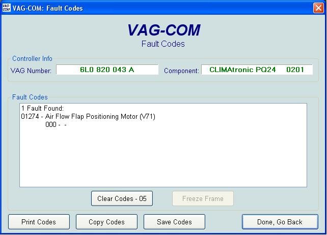

Cleared the Auto HVAC section of 4 (!!!) codes, flicked ignition a few times and used the climate for a bit and ended up with this:

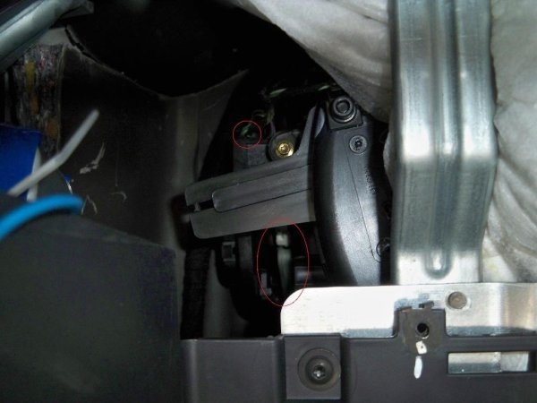

Then I dismatled as much as possible on the pasenger size - the source of the noise and excersised all the flaps using the buttons on the climate control.
Found out that this one was the culprit - constantly adjusting then coming to a rest on a pretty much random cycle:
Bottom circle is the arm that controls the "flap", top is the electrical connector going to the motor which is semi - visable between the two circles.
It's the flap that controls if the air comes in from the outside or the inside (when recirc button is pressed). I only have the shareware version of VAGCOM and refuse to buy it for a single use so I'm going to have to find someone that can do this very local to me to try nd reset the flaps which i've seen can be done before.
If this doesn't cure the problem, I am going to try and either unplug the flap when I'm happy of it's position (hope this doesn't flag up a fault that causes the screen to flash!?!?) - if it does I could probably solder a resistor in there to trick the climate into thinking that the motor is there - and leave it at that (I never use the recirc anyway) or try and change the motor/flap to a new one.
