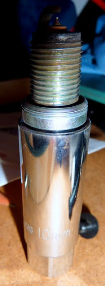

Old thread bump, will be chaning my spark plugs this week, but wondering what size spark plug socket i need to use? Going to have to buy one from halfrauds as i cant find any in the garage!
Anyone know?
warren_cox
Back from the dead
isn't it a 14mm deep socket (and then you choose 1/2 or 3/8 drive depending on what size ratchet head you have)?

warren_cox
Back from the dead
Phil you are right, they are 16mm around the plug body (see image below)
However, if you use a Halfords plug socket they call it a 10mm (confusing??? - see below)
