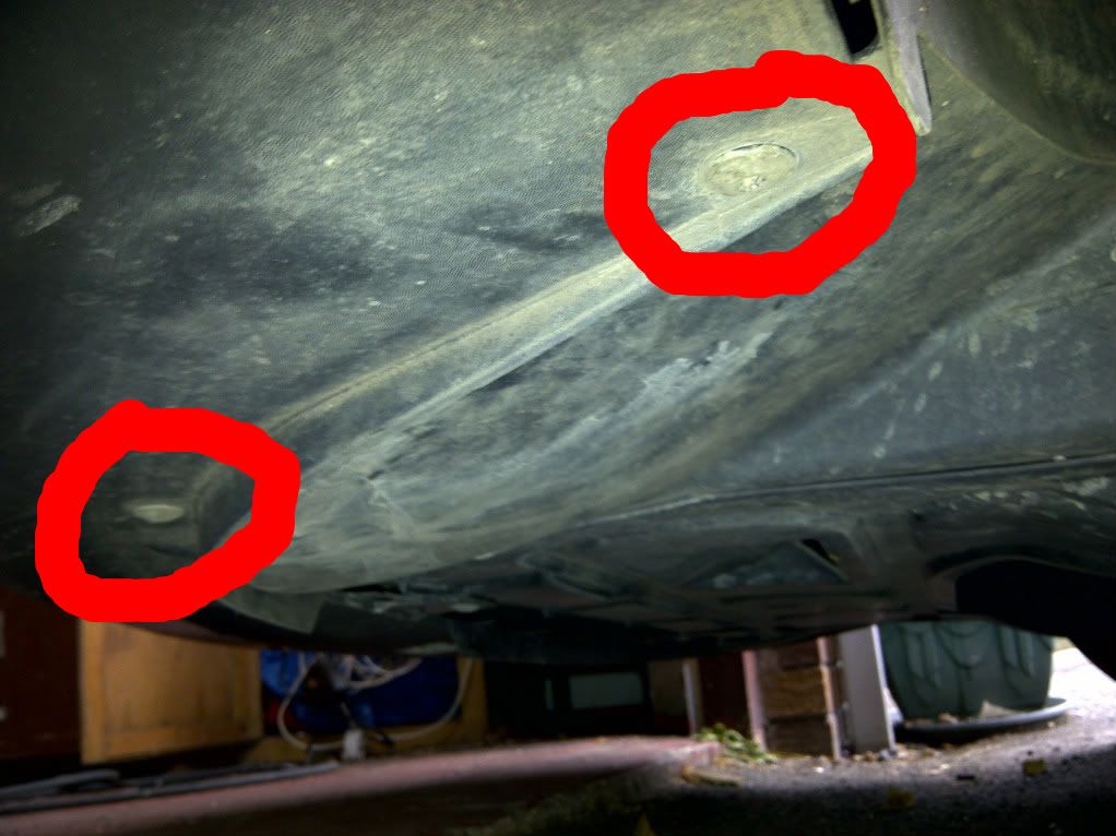

The next step is to find the two screws to remove under the bumper the picture below should help, they are right under where the arch meets the bumper:
This will allow the gap for your handto slip through be abit bigger for those with fat arms
