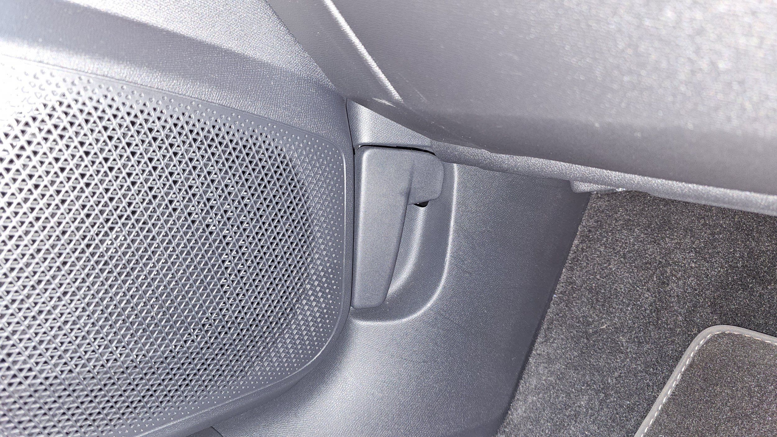

So I thought I'd open the bonnet and release the hybrid charging flap using the emergency pull but I can't get the bonnet open because the passenger door stops me from pulling the bonnet lever. There's no keyhole in the passenger door so I can't open anything except the drivers door!

Also looked at @Seriously?'s suggestion. Absolutely no chance in the Formentor. Deffo need the door open to release the bonnet.

🤔 Is it possible to loop a cable tie or two, or packing tape or coat hanger and fashion a lasso or some such and loop over and pull the lever some?
Oh wait, I just looked at picture 😮
That's a complete 4 course dogs dinner of a design flaw 😳

IF you can get behind the panel the lever is on from underneath and get hold of the cable, give it a tug.
In the good old days you could open the bonnet from the front grille.
Does the inner door handle not work on the passenger side? 🙈

Thanks for that and your suggestions. And no, the passenger door won't open using the internal door handle. How stupid is that?
