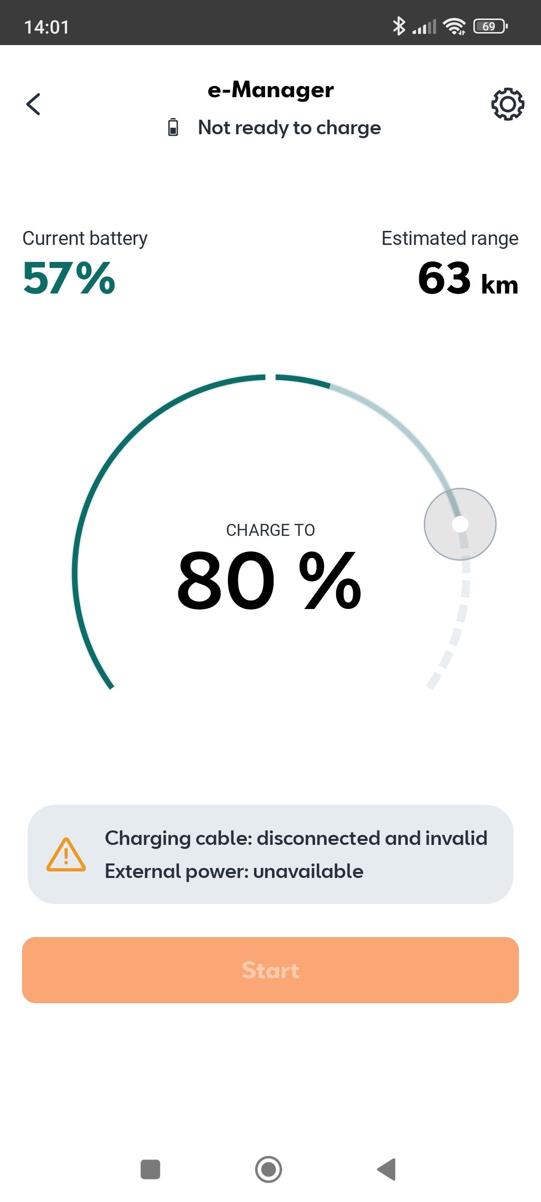

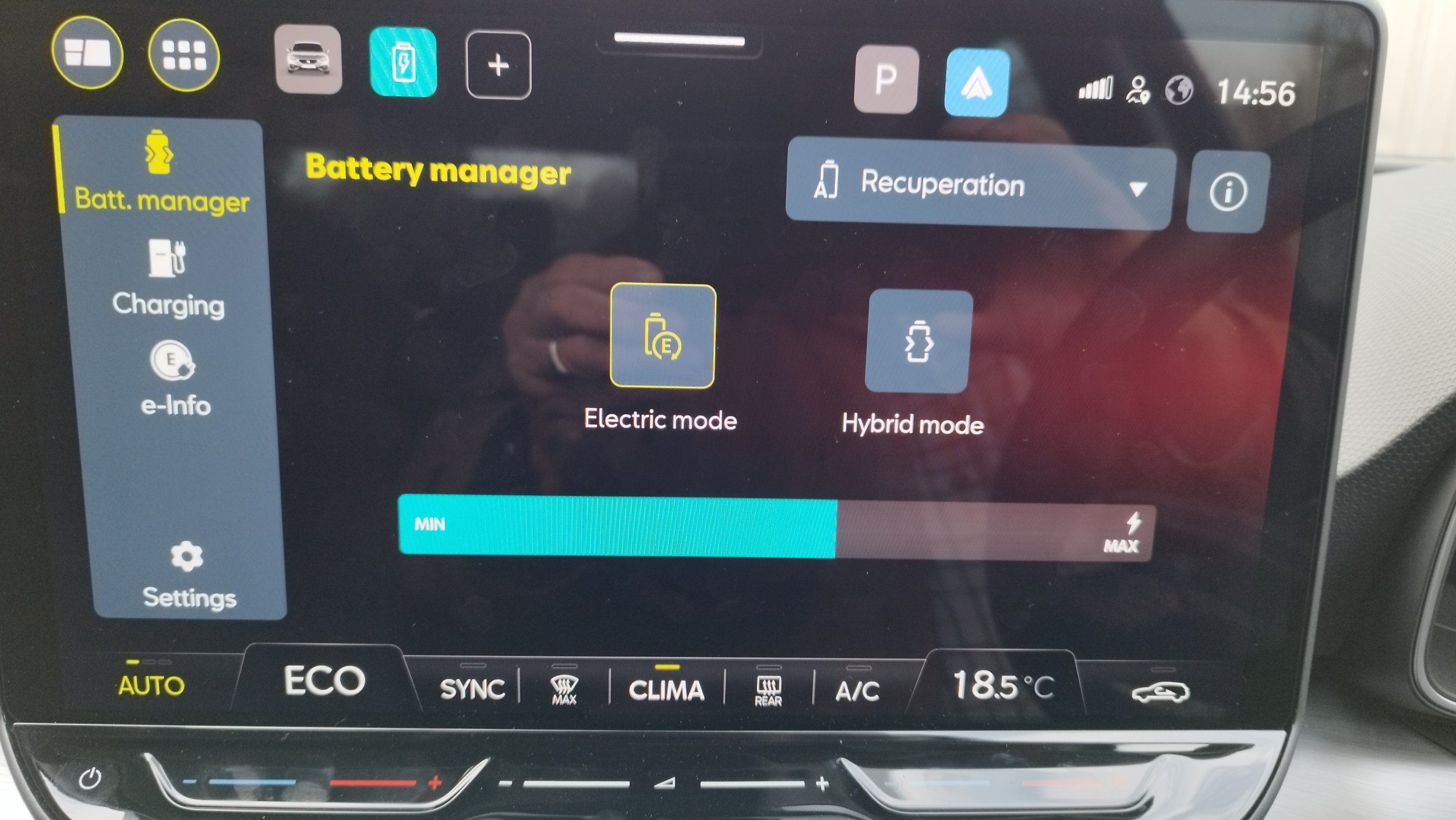

Just an update, see attached photos showing what I think are the relevant screens from the infotainment screen and My Seat.

Dear Paul,
I have exactly the same problem. I live in Portugal and bought a Leon ST 2024 (FR e-hybrid) and was convinced that either through the app or through the infotainment system it would be possible to schedule the charging sessions. That does not seem to be possible with the current version of the app and dashboard. I guess it was removed.
BR
Luis
P.S.: My screen is exactly like the one in your picture.
