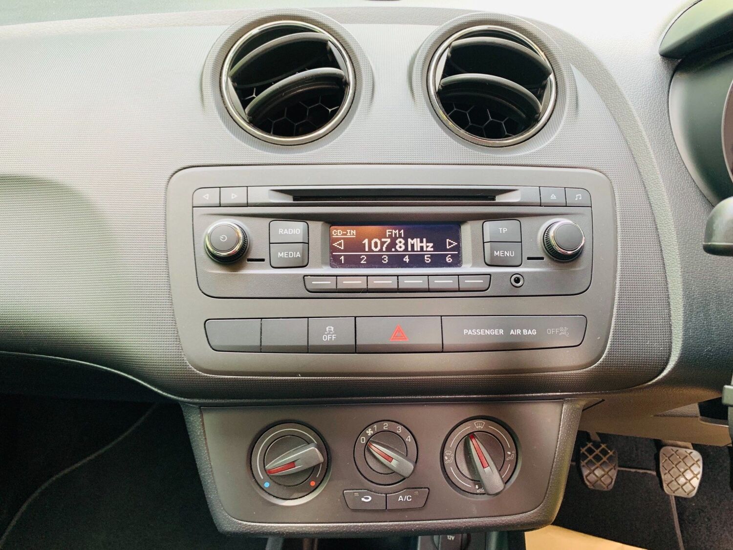

Here is a picture of what is currently fitted :
Oct 27, 2021
43
Can a unit be fitted to this car and sorry to ask does anyone know the correct part number if it can be fitted as have seen a few now, some by Garmin and some with something called navigon on it

Sorry if I didn't make myself clear, I only posted a picture of the stereo unit so people could see what unit was currently fitted and if it was different to the unit that comes with the screen on top of the dash
Hi Jay, but that is only like using Waze, but you have to pay for map updates, that is just like the TomTom, but if I am missing the point you will have to explain more as that is just stuck on top of the dash

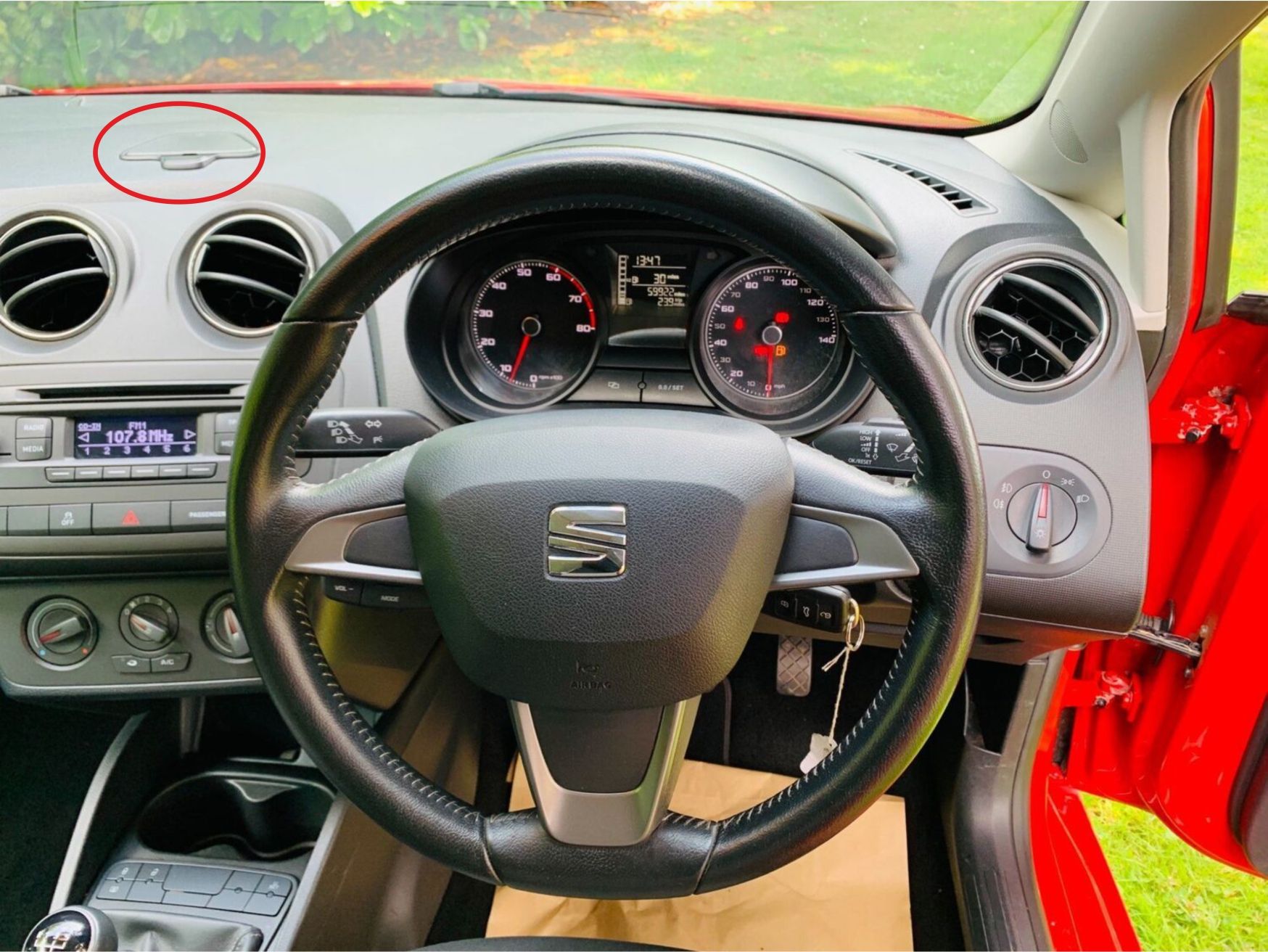

Mrs S had an Ibiza FR with the Garmin Navigon Portable System. If you prise up the cover on the dash I've circled in red on your photo, there should be a row of nice shiny gold plated contacts. The cradle for the satnav clips into here. You need to buy the cradle and the satnav unit. I'm not sure if the units are coded to the car, but I suspect not.
Oct 27, 2021
43
Thank you, just waiting for the car to arrive and will have a look, I have seen VW units that work in seat etc so I don't think they are coded. And there are a few hacks I have read for changing the start up logo etc
