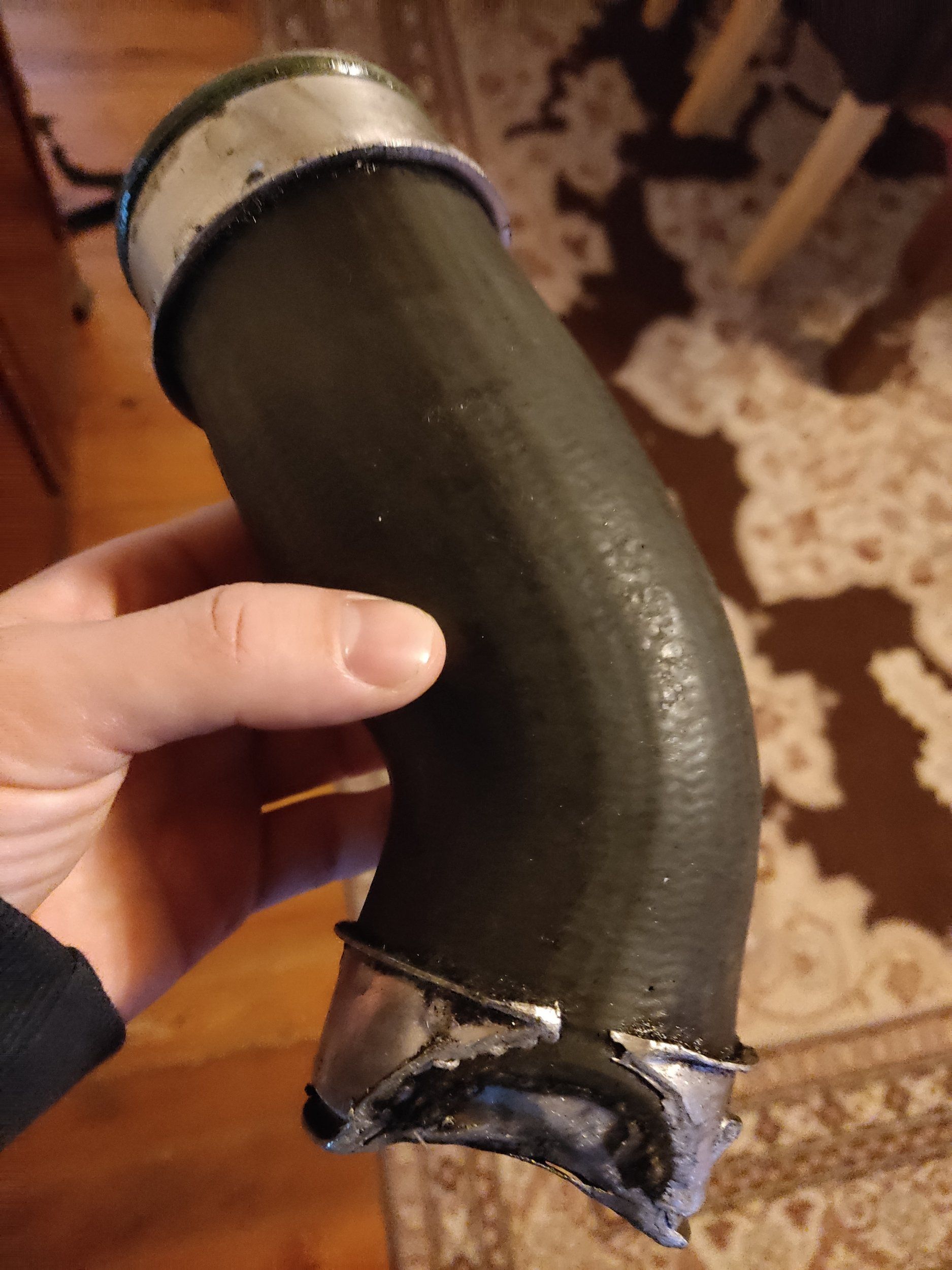

Happy Xmas/new year! This pipe became detached when a jubilee clip apparently failed (front drivers side corner) and now it is damaged and needs replacing, does anyone know what the part is called and/or where I can get it? Many thanks in advance

I found the part number 1jo145834aa. The dealer quoted £105 found some available on eBay for £14-30 that are not the same brand, went for the more expensive ebay option, hopefully it works ok just need a new clip or perhaps a jubilee would work better?

You need to use the proper clips. Jubilee wont work.
Controversial i know but i have put a small pilot though where it clamps and a self tapper or two. That way it will never blow off again.
However this was done bumper off job and all pipework cleaned / intercooler cleaned afterwards to remove all swarf
