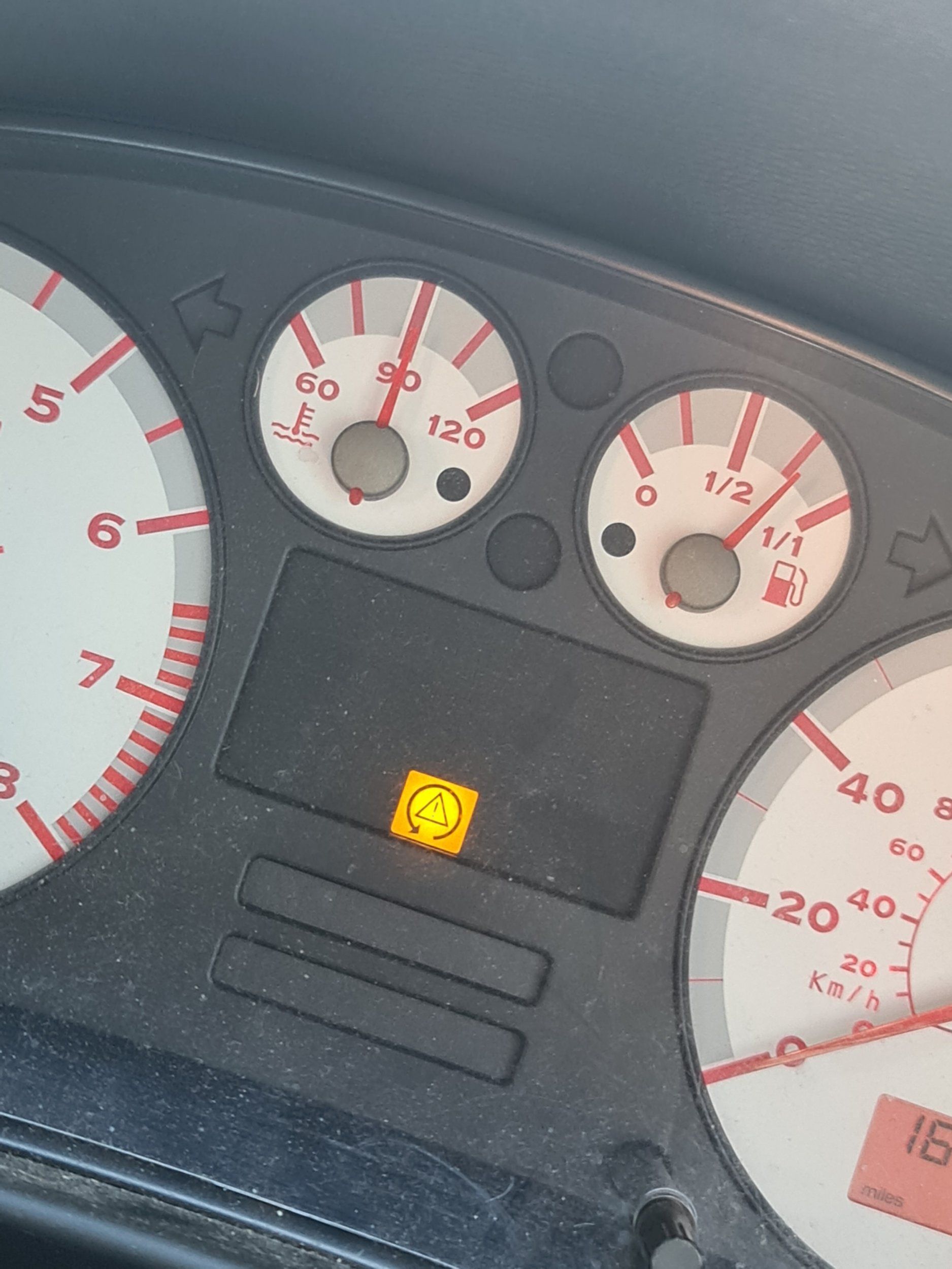

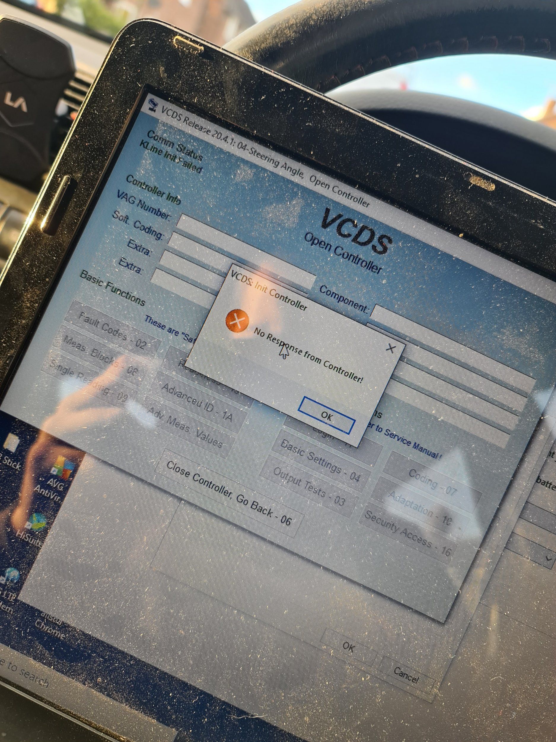

Ever since I removed my subframe to replace the downpipe, my ESP light has been on and I have a permanent fault code for the Steering Angle Sensor (ignore the other fault codes in the image)...I can see it working on live data, but I replaced the SAS/clock spring any way, just in case, and that didn't fix anything. So I figured It just needed to be re-calibrated. I managed to get temporary access to VCDS, but I can't figure out how to do it? On VCDS I go to Control Module, Chassis, and I've clicked everything to do with the steering but all I get is "no response from controller". So what am I doing wrong here? My car is a MK1 Cupra R, and all the videos on YouTube are for different VAG cars or older/different versions of VCDS.

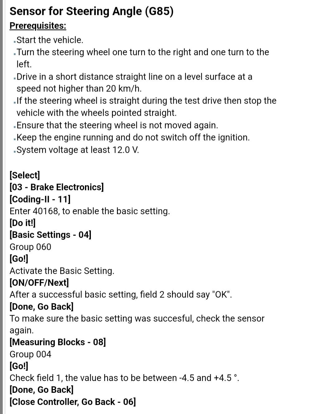

Have you done the Ross Tech method?
The whole rotate wheel one way then other way then drive straight then go into brake setting and adjust?

Is this what you're on about (in the image)? This is the first thing I tried...The problem is, I can't even do the very first step on VCDS, which is to access 03-Brake Electronics. Every time I click it, that's when I get the "no response from controller" message 🙄 I can access 01-Engine so I know it's connecting to my vehicle, but that's the only module which seems to work. I have also tried calibrating it manually (without VCDS) by following the steps on Ross Tech, and a few others that I found, but nothing is working.

Sounds like the problem lies with your software or cable rather than the car. Are you using a genuine VCDS cable?
I honestly couldn't tell you...It says "Ross Tech VCDS" on the OBD part. A garage where my friend works have recently bought it, so I'm borrowing the cable from them. But they're new to it as well, so can't really offer any assistance. I did notice that the VCDS software that I had downloaded was an old version (20.4), so I went to the Ross Tech website and downloaded the newest one (22.3 or something like that). I haven't tried it yet, but I'm going to try it this afternoon.
Ah right, if it's a garage then it's almost certainly a genuine cable.
The car uses the same network to communicate with all the modules, so the fact you can get comms with the engine module is a good sign as that means the network is healthy. The ECU and ABS must also be talking to each other or you'd have the ABS and TCS lights on, so that's what makes me think it's definitely VCDS related. Version 20.4 is really old now, so if it's a newer cable then maybe it didn't have the right drivers installed for that cable. Fingers crossed that 22.3 will sort it for you. Let us know how you get on.
That could be the case...It's a Hex-V2 cable, and when I found the recommended version of VCDS for that specific cable, it came up with 22.3 which is what I've now downloaded from the official Ross Tech website :) So fingers crossed I can at least access all the modules now, but there's still no guarantee that calibrating it will sort the problem. I'll post an update later on though, once I've tried it again.

Honestly...I have no idea how, but the light is finally off 😂 My autel scanner can do it on almost every car apart from SEAT (typical), and I couldn't get VCDS to work properly even with the newest version. Some guy on the facebook pages said that he calibrated his with a SnapOn scanner, but the only one I've got is a really old SnapOn Solus with the individual keys. Thought I would try it any way, not expecting it to work, but somehow it did 🤷‍♂️ Not how I thought it would though.
The only proper guide I had was the Ross Tech one for VCDS, so I was trying to follow that but make it work with the SnapOn scanner as a few of the steps are slightly different. Although when I was doing the coding and the basic setting part, I kept getting errors. I made a few attempts, then the scanner randomly switched off (it's old so the battery isn't great) and the ESP light switched off with it. It's a miracle lol
