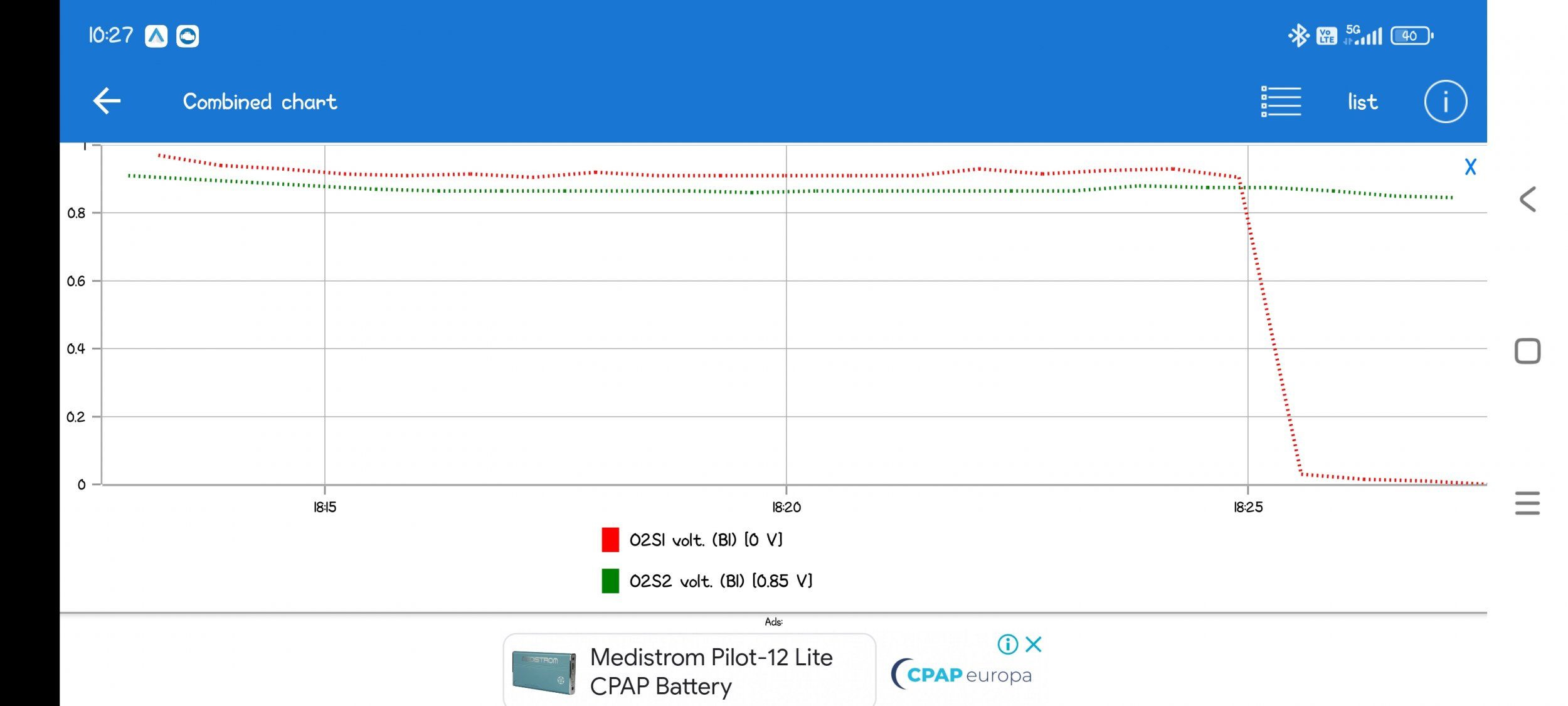

I have a leon 1P from 2008 with the horrible BXW engine, the 1.4mpi with 86hp.
Since i bought it, allways had an O2 sensor bank 1 "system too rich" error.
I've swapped the pre-cat O2 sensor with an used one with the same ref, still get the same error.
One mechanic said it was an O2 sensor fault, other says its the ECU.
Both O2 sensors are working fine, at least both of them give good readings, besides the pre-cat sometimes gets higher than 0.9v and then comes down again.
Spark plugs already changed. Air filter too. I believe the BXW has no maf sensor or anything like that.

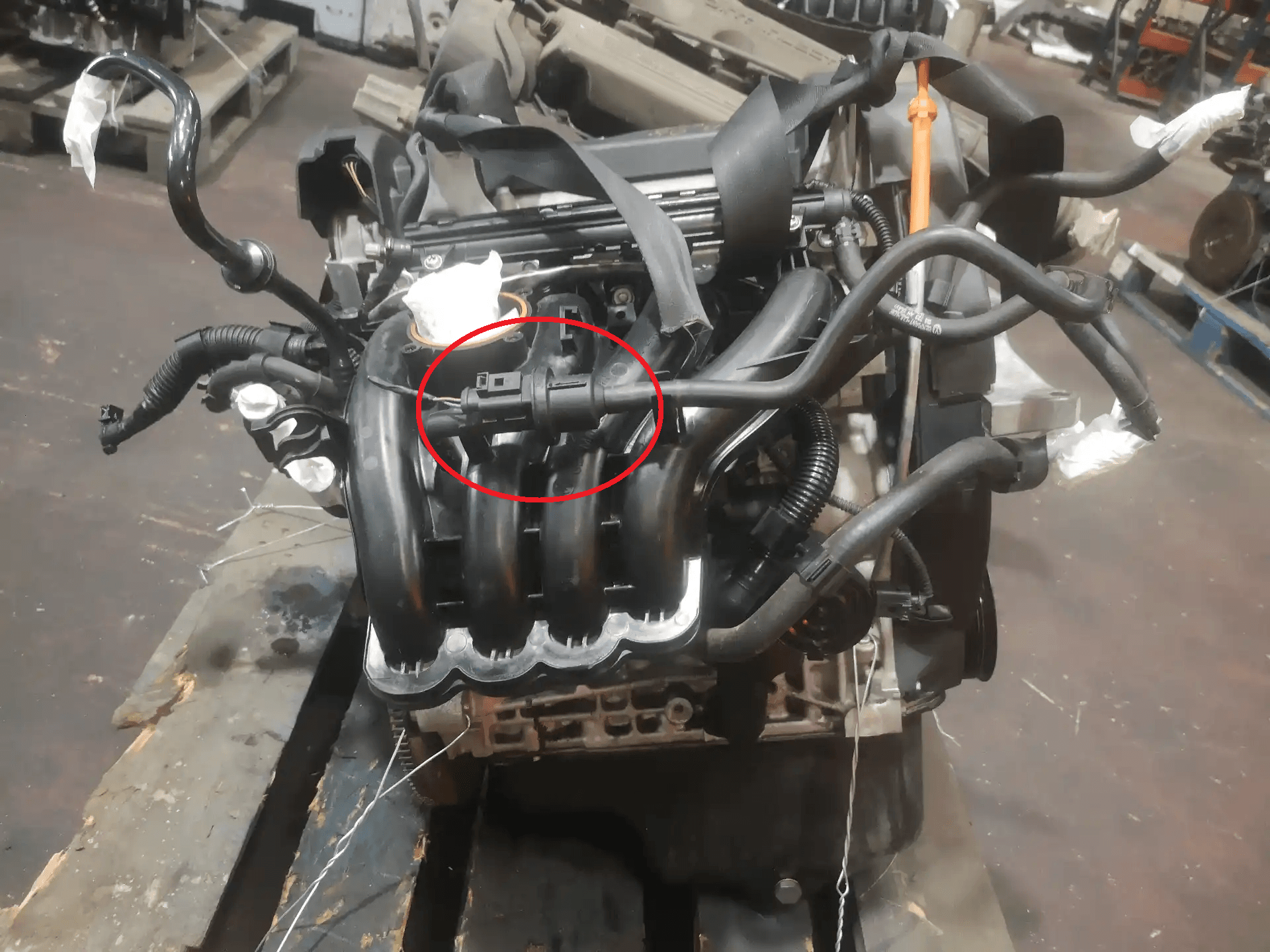

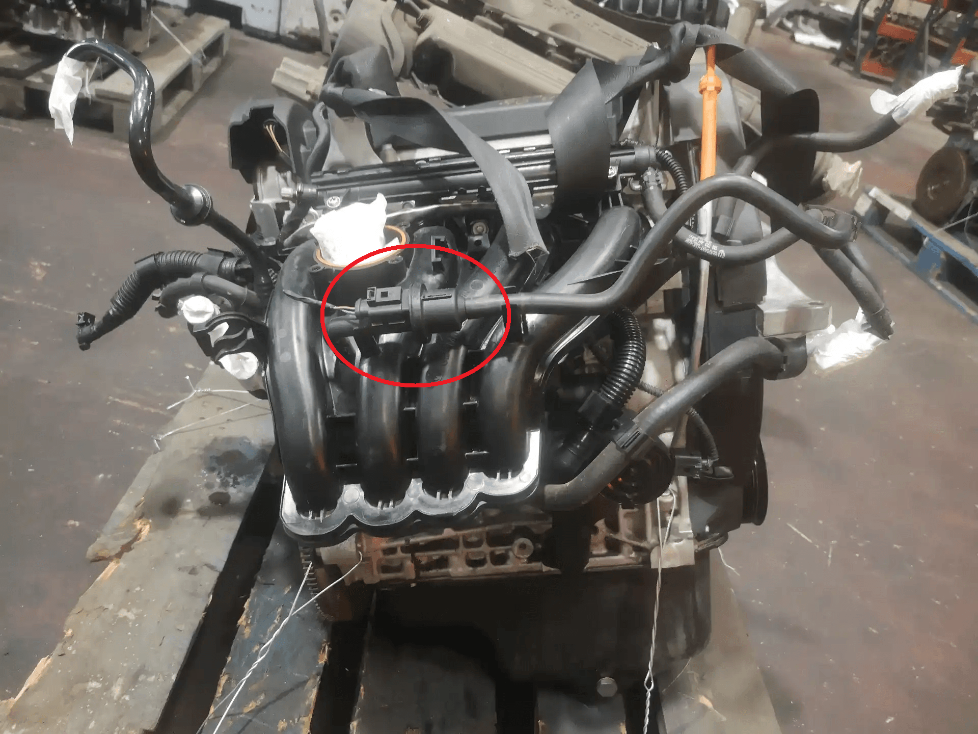

If it doesn't have MAF it surely has MAP, so maybe that sensor is playing up or there's damage to the area and it's getting false readings.
Temp sensor and/or thermostat could also be an issue
