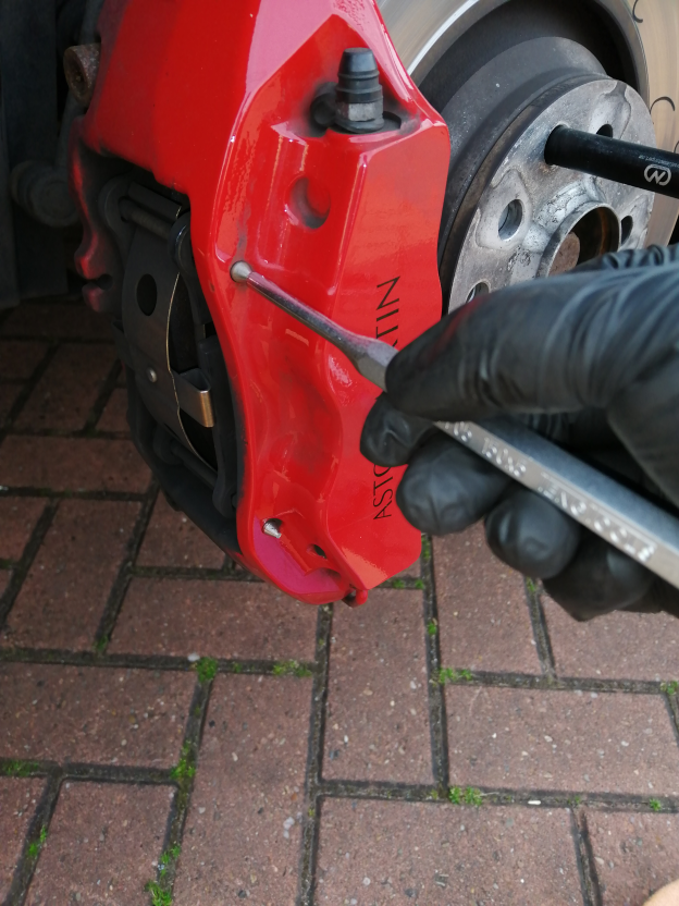

Take a hammer and a 5mm punch and knock one of the pins out. Once it's part way, the spring clip is fairly easy to push in by hand and will relieve the pressure on the pins. So you can slide the rest of the way by hand. Also... make sure to hold on to the spring clip as you knock the pin out anyway otherwise it will spring and hit you in the eye (ask me how I know!?)
Once one pin is out, if the spring hasn't already hit you in the face, it'll fall out when you let it go. As there was no pressure on the other pin, I just slid that out.

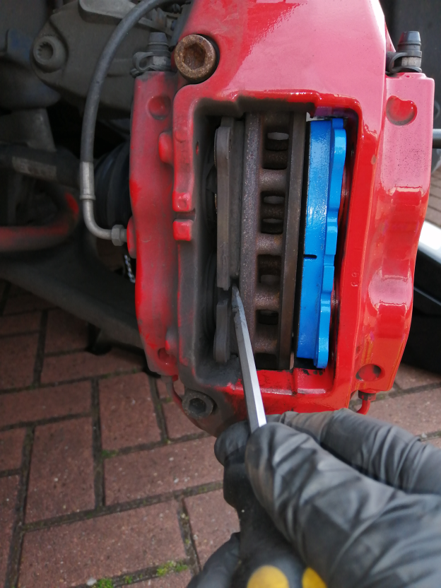

Next I got a screwdriver in and pushed one of the brake pads all the way back. Be sure to work top, bottom and center and try and keep it even as brembos have two pistons (one bigger than the other I think).
Another "quirk" of brembos is that pushing the pad in one side pushes it out the other side. So I used the new pad as a spacer to make sure it didn't close too far I couldn't get the new pad in afterwards.

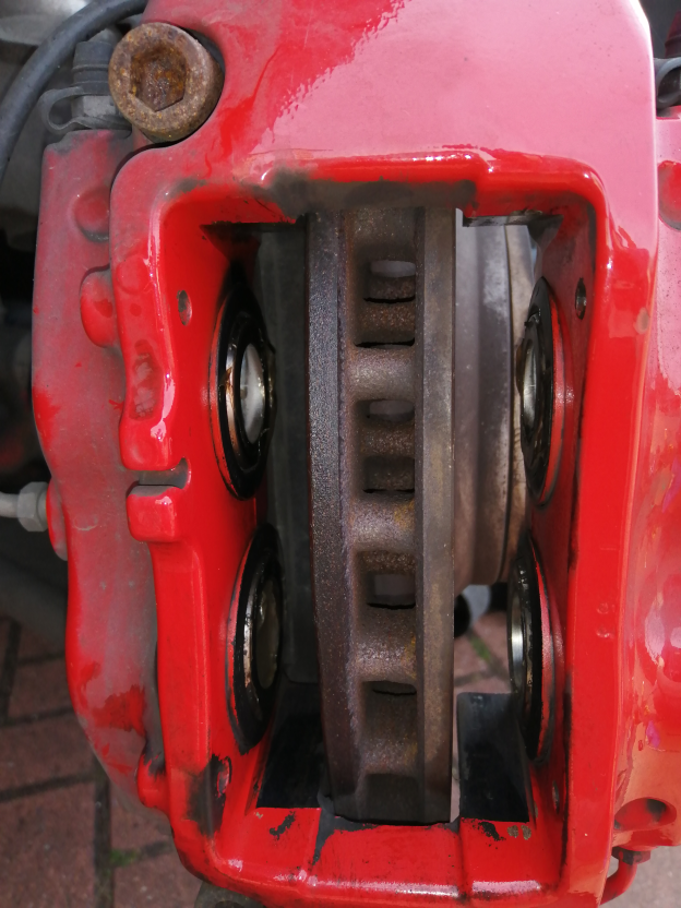

With both sets of pistons back, time for a cleanup with a wire brush, some water, cloths, etc.

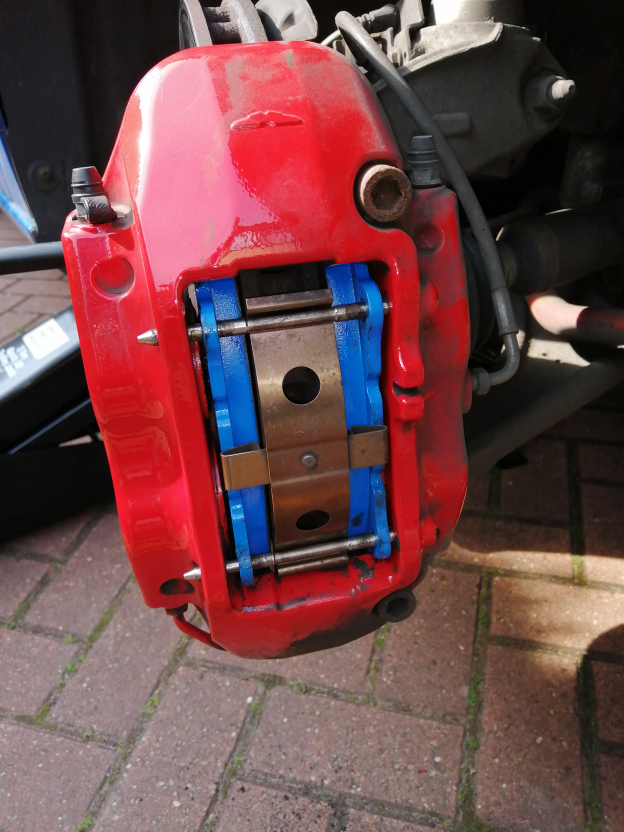

Then fit the new pads in. The top pin slid right in.
The bottom pin will slide in by hand if you hold the spring clip in while you do it.

With the pins in place, I used a 7mm punch and as the space under the wheel arch is limited, the side of the hammer as opposed to the front. You'll know when it's all the way back in as the noise will change as you hit it... and the cone pins will stick all the way through.
