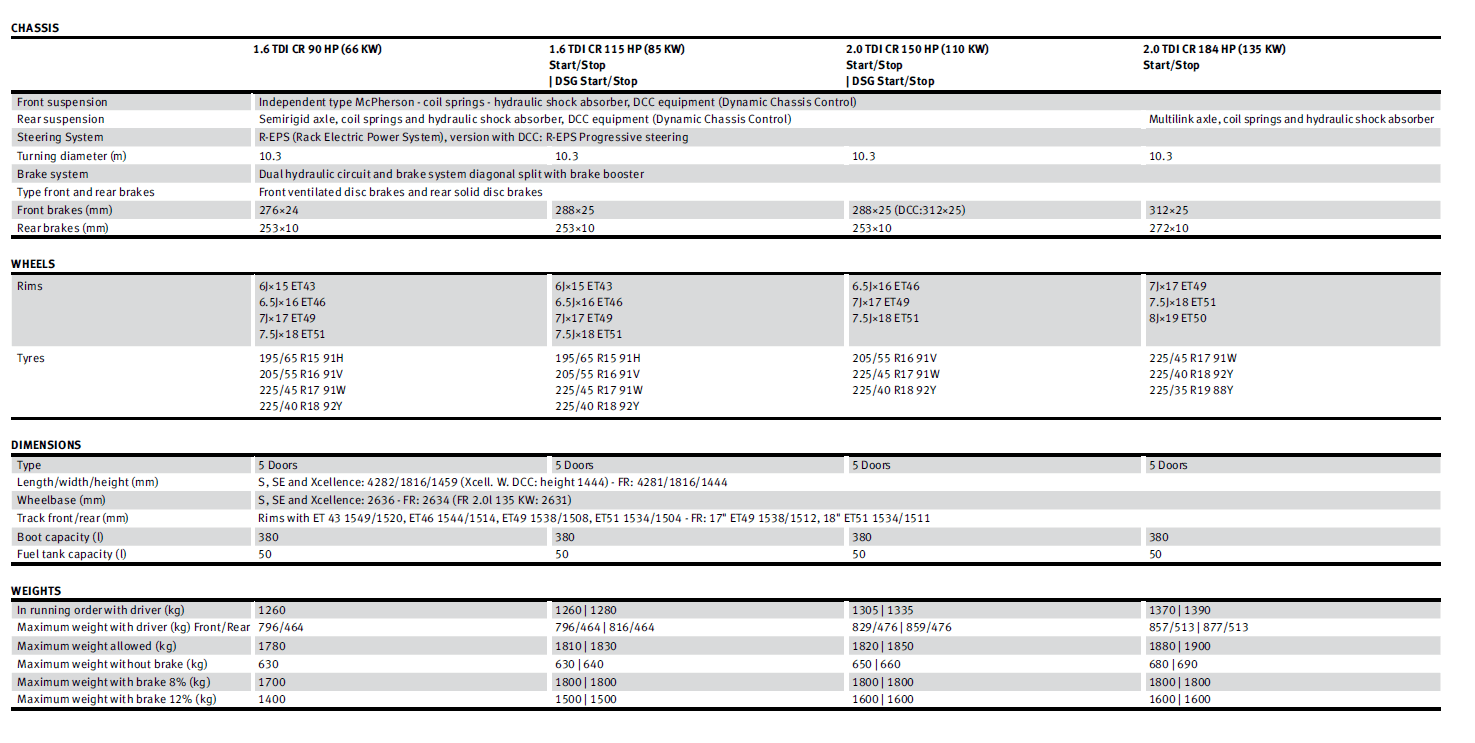

In parts catalog, brake pads are categorized with regard to the brake disc size, and that depends on the engine, transmission & suspension type combination. Front brake system PR codes start with 1Z? or 1L? and rear brake system PR codes start with 1K?. As you found out, the sticker in the maintenance book doesn't include all PR codes of the car and the ones related with the brake systems are not there unfortunately. Obviously a dealer, using your car's VIN, can tell you the exact PR codes and exact part numbers of the pads so you can look for aftermarket parts compatible with those.
But if you know the brake disc sizes of your car or if you can manage to measure them, you can find out the part numbers yourself, using the list I gathered from the parts catalog, Leon 2016 section. Yours are most probably 288x25 front (312x25 with DCC suspension), 253x10 rear. The attached picture of a brochure I found shows those values for 2.0 TDI 150. The brochure was for the facelifted models but I believe the brake system was not changed with the facelift.

I'll remove the wheel and try to measure it in following days (probably next weekend), but yes, it should be 253mm x 10mm discs, PR code: 1KD. I'll leave a comment here with confirmation, if it's 253mm :)
I know that disc is not the "big" one, which I already saw on other Leons (on 184 hp model for example, which is also confirmed in this brochure).
