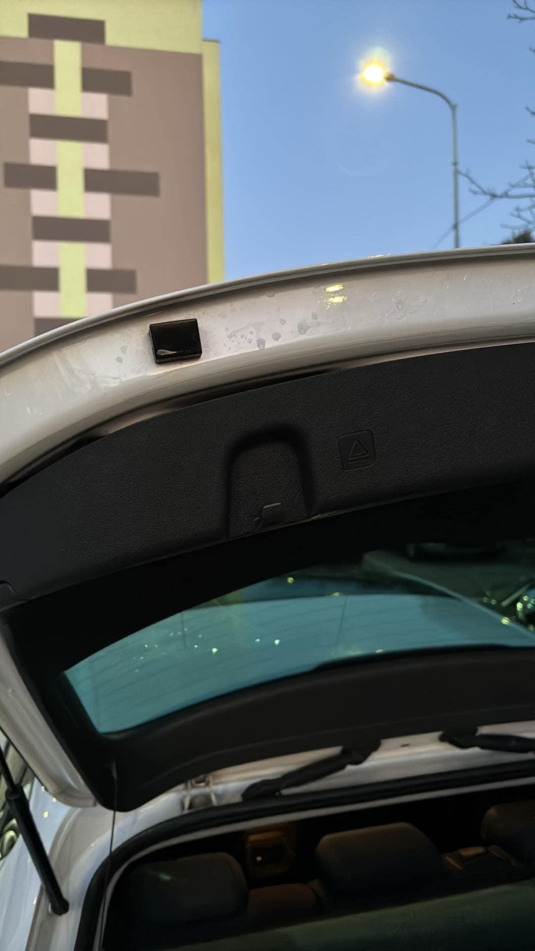

I recently noticed that on my 2013 Leon 5F this plastic part is broken. It resonates when driving and it's kinda annoying. Any ideas how to fix it?

There should be a load of metal clips holding it up (on the ST there is), so guess you’re missing some of these too.
When I got mine, the trim had obviously been removed at some point, and badly refitted, as it kept popping off at the top - I ended up replacing a bunch of the clips that had been bent and it’s all good now!
Exactly this! Those clips are basically one-time use and you should replace them after taking of that trim. The same thing happened to me and it was only valid solution.
In HB and SC there are 4x 4B0867276A and 2x 4A0867276 clips. Probably not all of them needs replacement, but it is better to change them all at once.

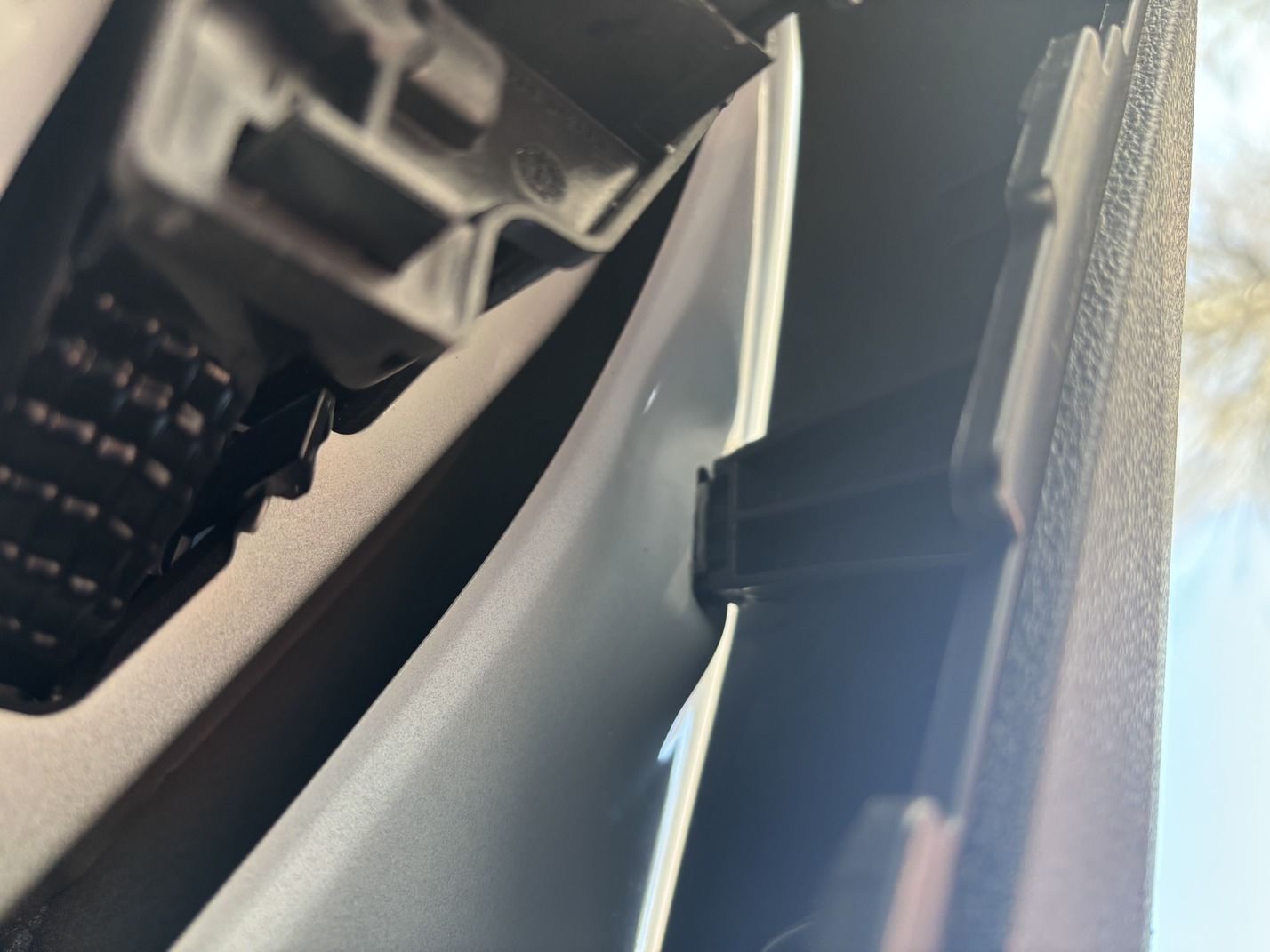

Thanks for the replies but I discovered that the clip fell off completely because the plastic is broken. I don't think replacing the clip would be enough because it's not holding on.
