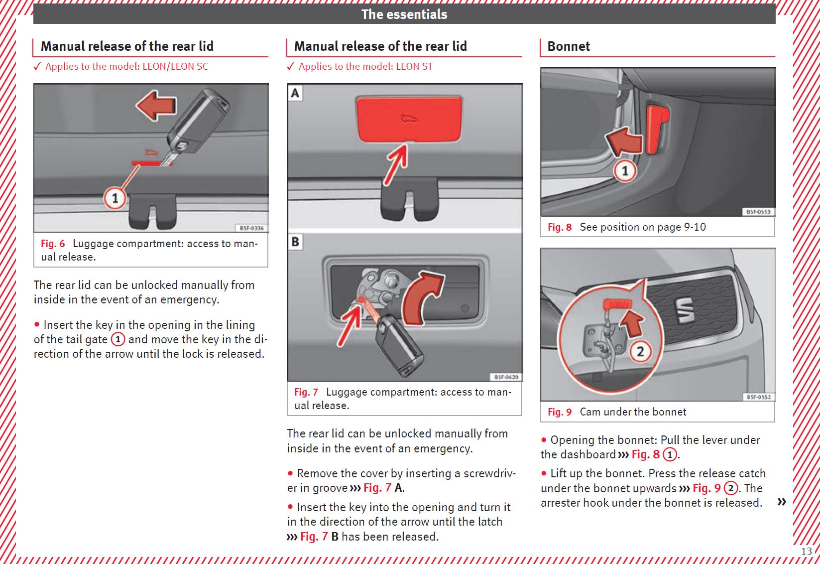

Found this in the handbook, hope it helps getting it open but I think your problem sounds like a wiring fault.

Thank you I am thinking that I am wondering is the a fuse that controls the boot
If your rear lights and wiper don't work as well it won't be just one fuse, although if the boot lid is open (or the car thinks it's open) then I think the rear wiper and possibly the reverse light may be disabled.

Yep I have got into my car today and now the wiper and boot are working I think the lubricant spray might of interfered with it
