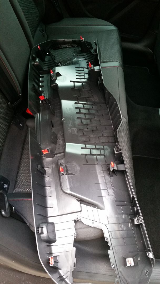

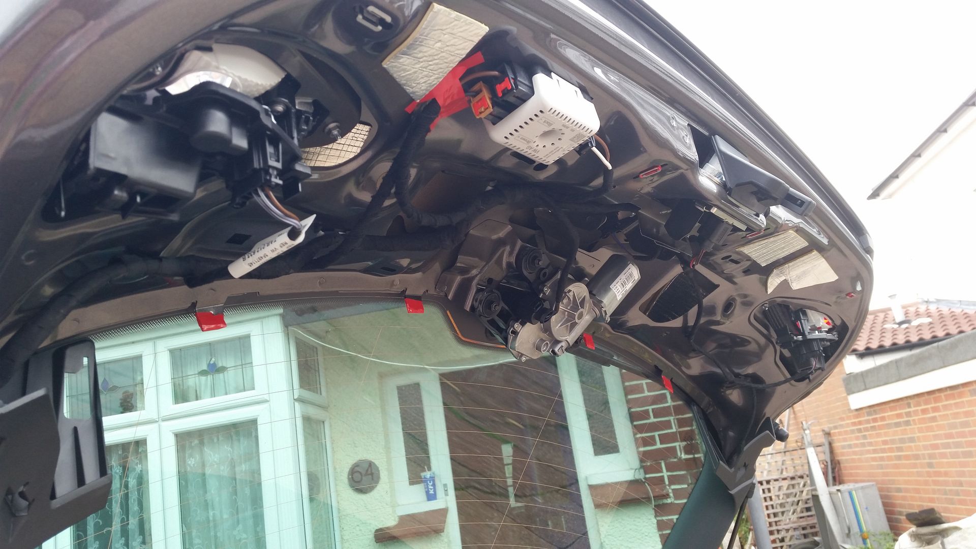

You know what, whisper it quietly but I think I might have :).
Here's a couple of pics so you can see what I did.
So like I said I wrapped every joining part and clip in red insulating tape, taped up a couple of wires and just generally made sure everything was secure. I added a couple of bits of sound deadening most of which went on the inner skin and can't be seen here.
I believe the noise stems from the little metal clips within the boot lid that the plastic panel clips into

Cheers mate. With all that in the lid you can see why it might rattle. My next step was to put insulating tape round the catch but I'll have a go when I get some time. Will try the catch in the interim.
