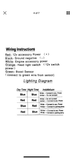

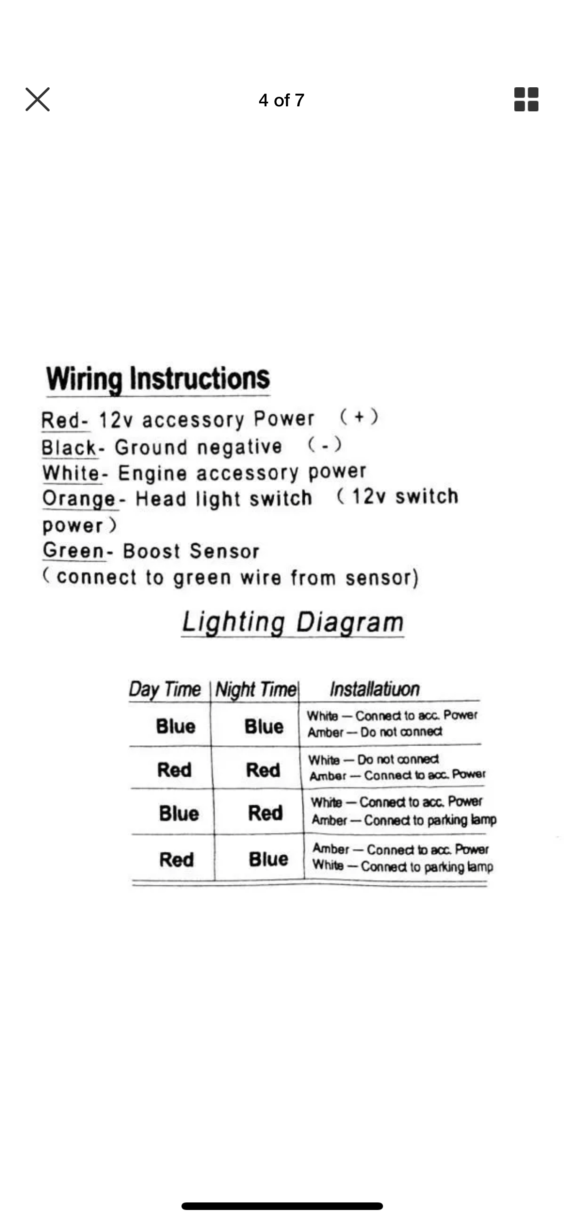

Hi, I need some help fitting a digital boost gauge on a Leon Cupra mk2. Basically where do the orange and white wires connect to? Does anyone have any photos at all? I want blue in the day and red at night. Thanks

You should only need to fit the red and black for the gauge to work mate
orange is for the dimmer function so if you want that to work it needs to be wired to a source that comes on when the lights are dimmed

Hi, thanks for your reply. Yeah, I found out where the orange one goes haha. I’m just hoping someone knows how to connect the white wire as I think it goes to ignition

sorry mate yes white will go a ignition on source , red to constant 12v I’m assuming to save your settings on the gauge

I’m struggling to find where to connect the white. Is it on the ignition loom? Or is there another way?

The way i fitted mine was using a piggy back fuse connector into the fuse box (side panel ) rather than tapping into the wiring mate , then used a multi-meter to find a ignition on source .
there are two types i think your after a cranking ignition that just wakes the boost gauge up ?
