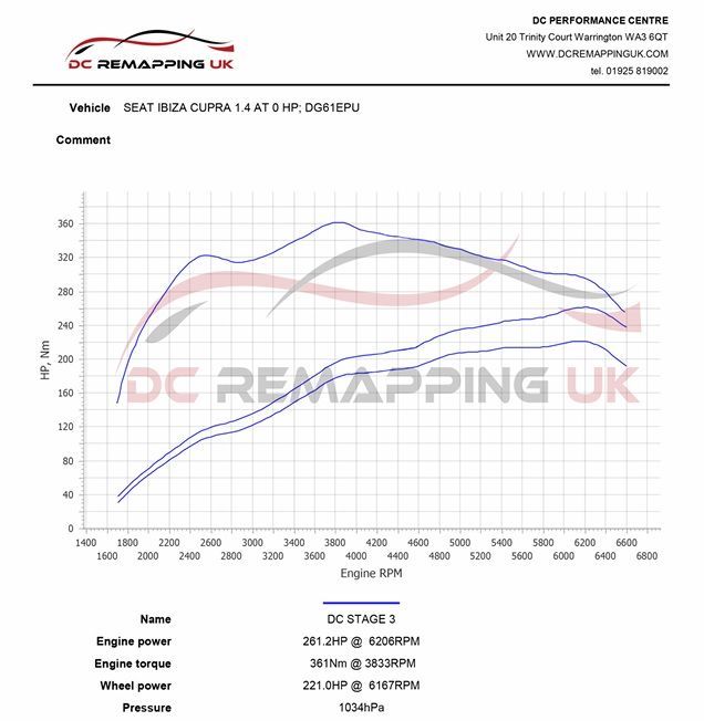

So the ol girl is still heathy and running sweet while the remaining few hundred other's keep dropping like flies with the usual problems, mid last year I bought a very nice k03 Hybrid from Venom Turbo's, once fitted and ran in I had it tuned back at the tuners.
It made 261hp/361nm on safe mapping for timing and stock fuelling being close to 100% duty, Revised CAVE engine & Clutch pack still stock also with no extra mods other than the turbo and tune from my previous, The Boc is now an absolute beast and pulls so hard all the way through the rev range!!

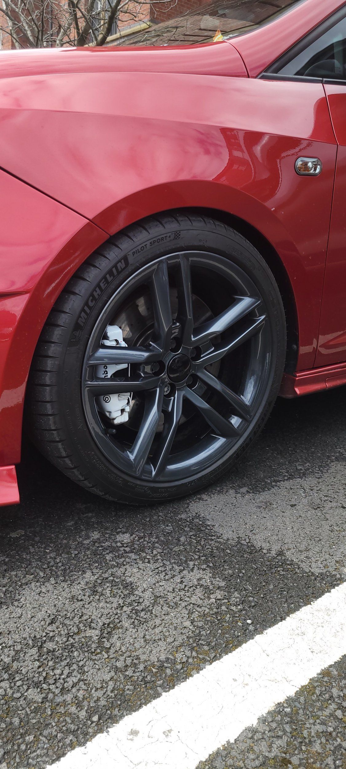

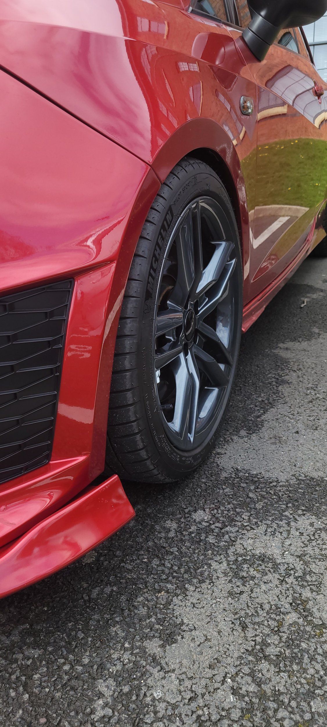

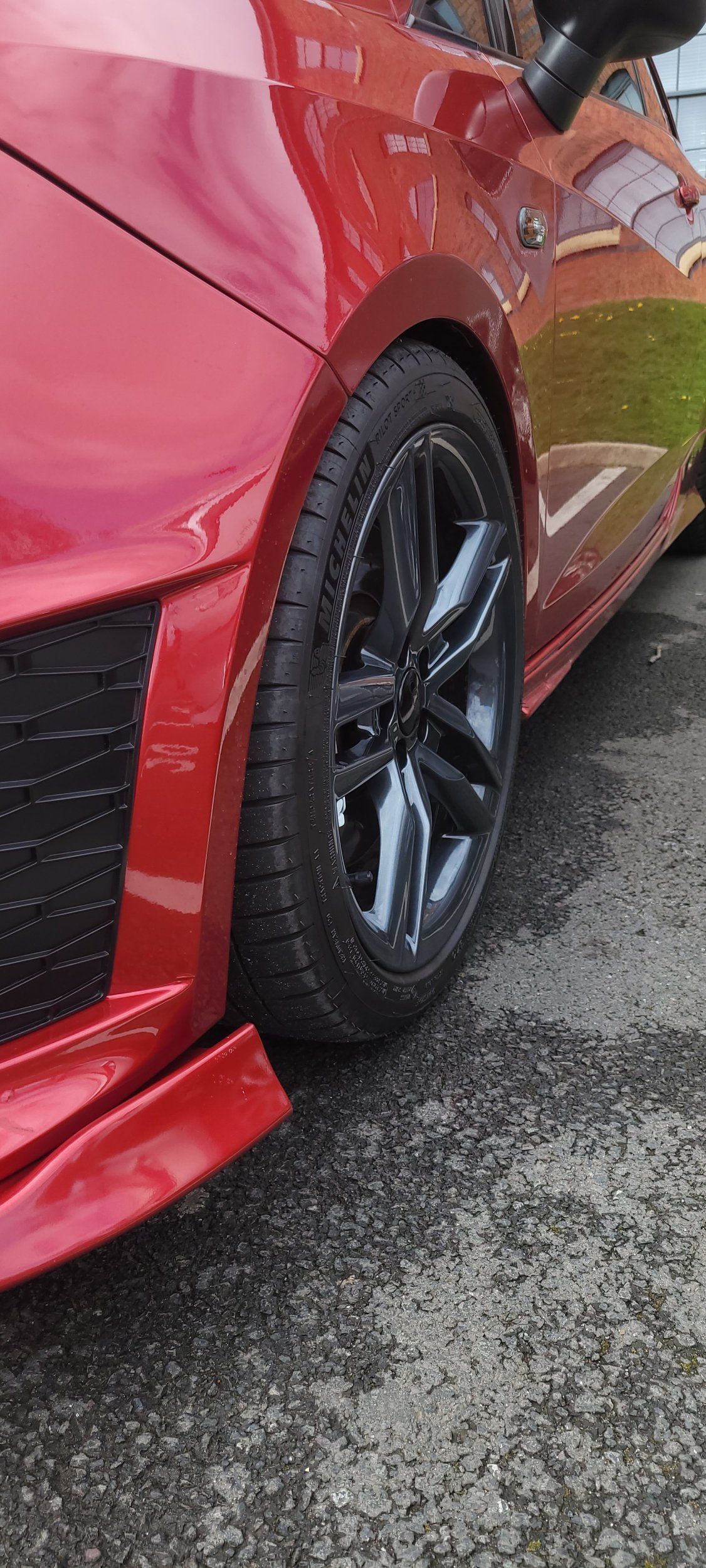

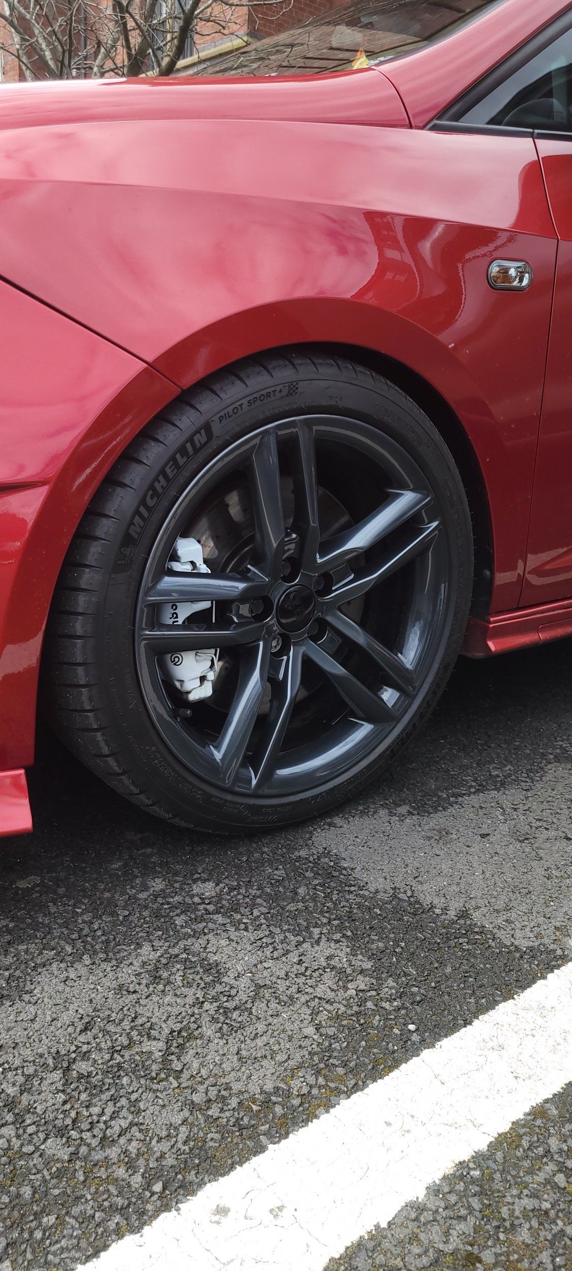

Quick update, I finally got around to getting the wheels I've always wanted to run on the Boc....
Always had a thing for the Audi S-Lines and picked these up cheap, needed a refurb and tyres.
The result.....
Fitment is spot on

Yes, 17's, ET 36.
I was surprised I havn't needed to roll the front arch lips

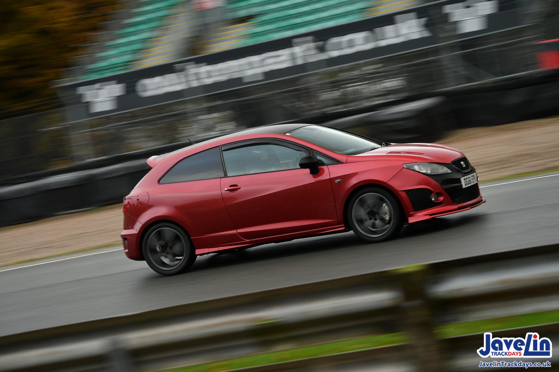

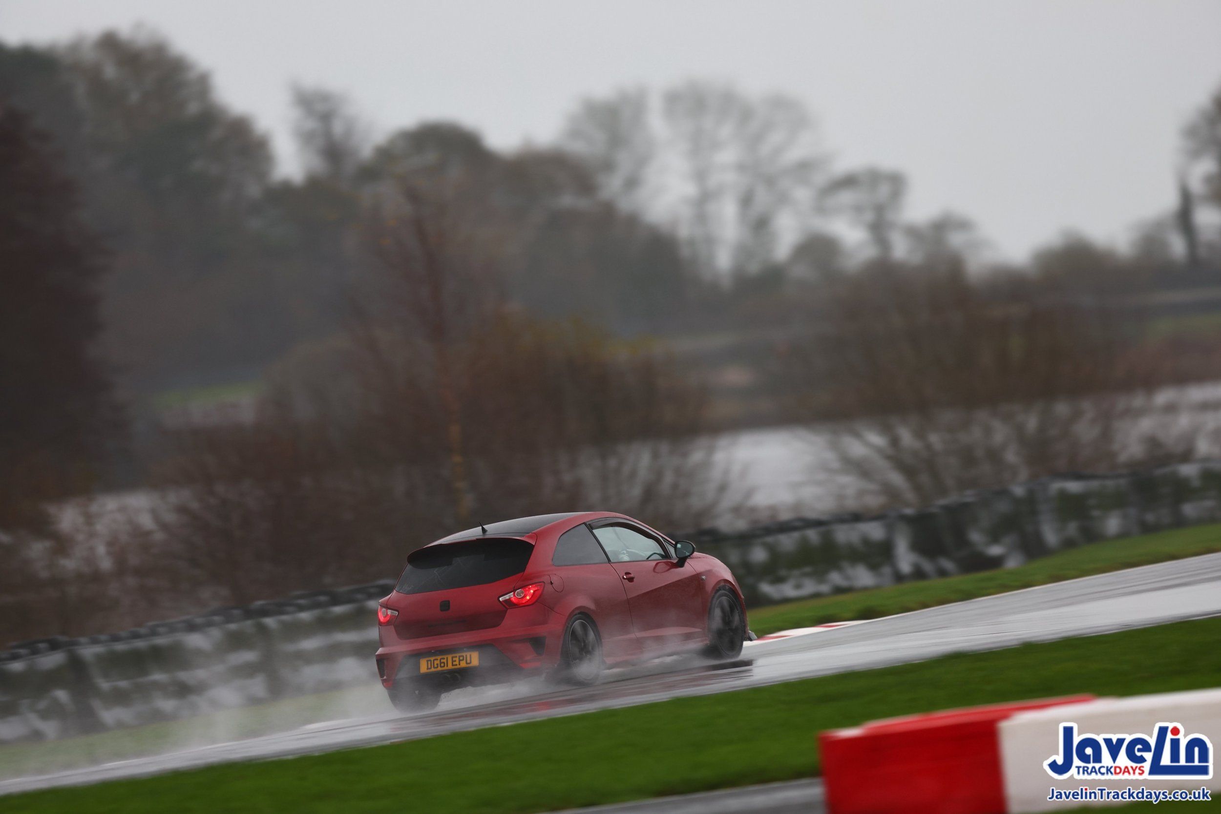

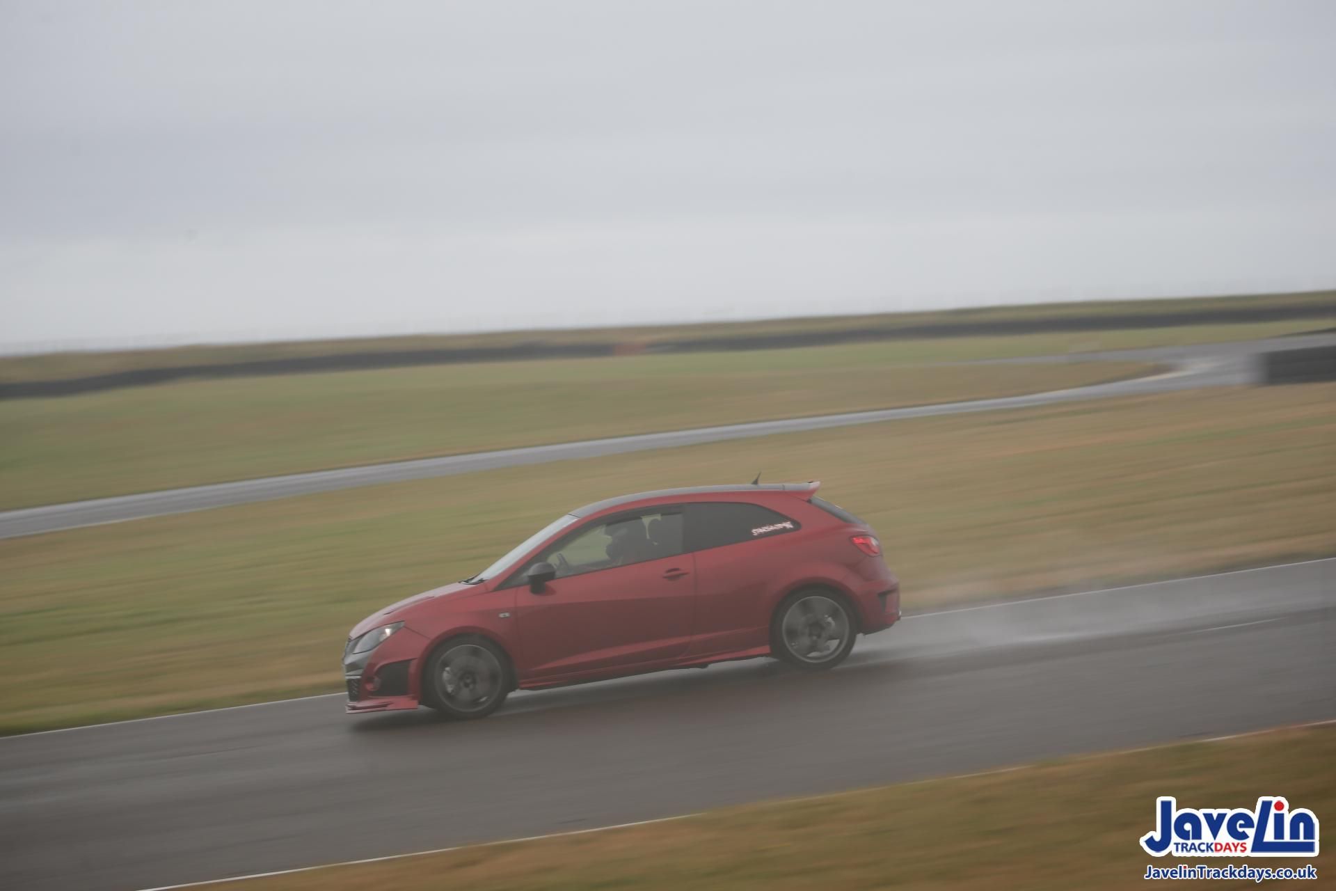

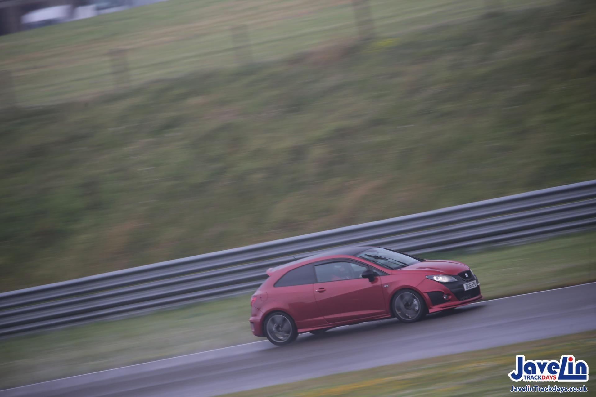

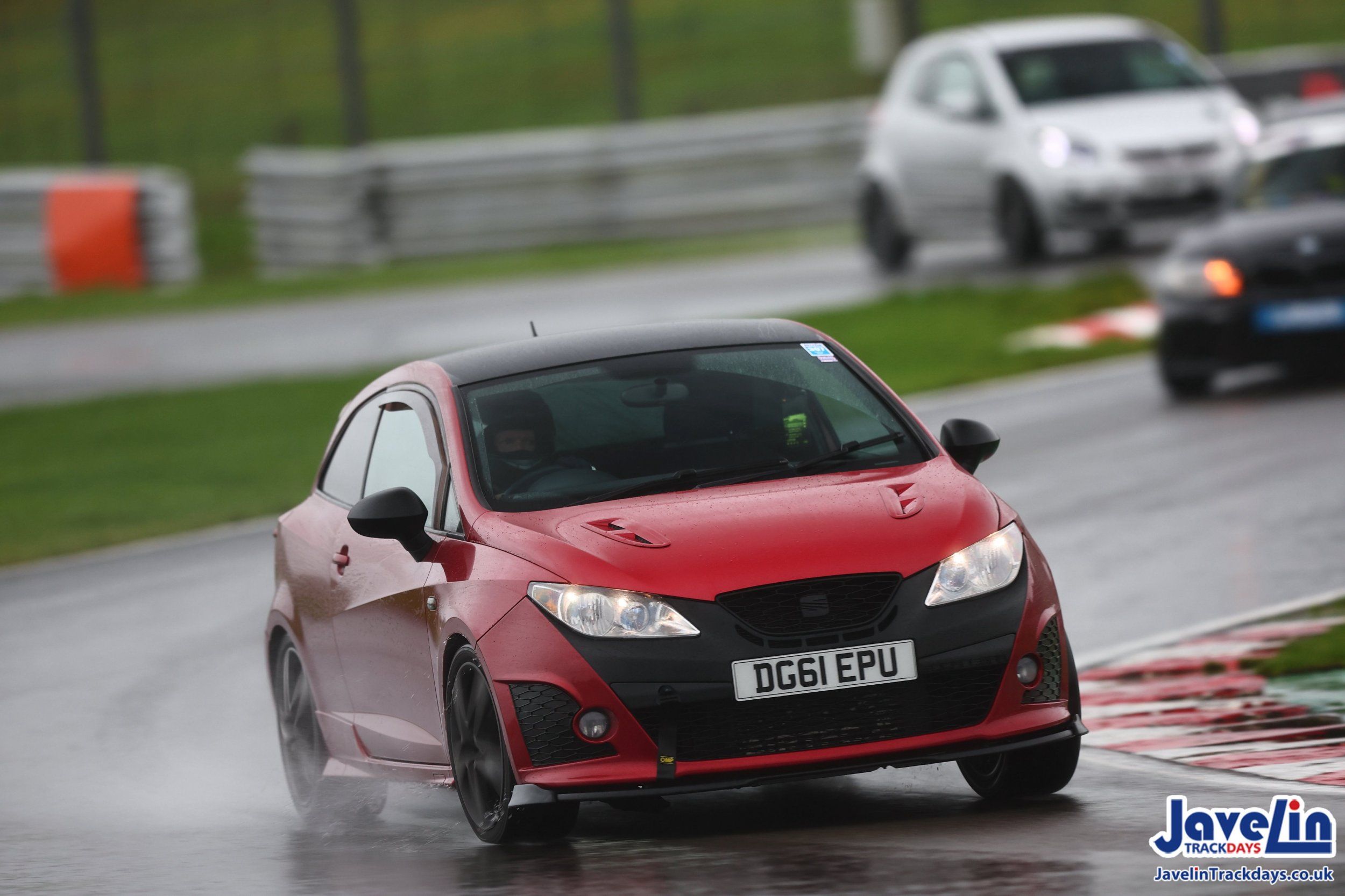

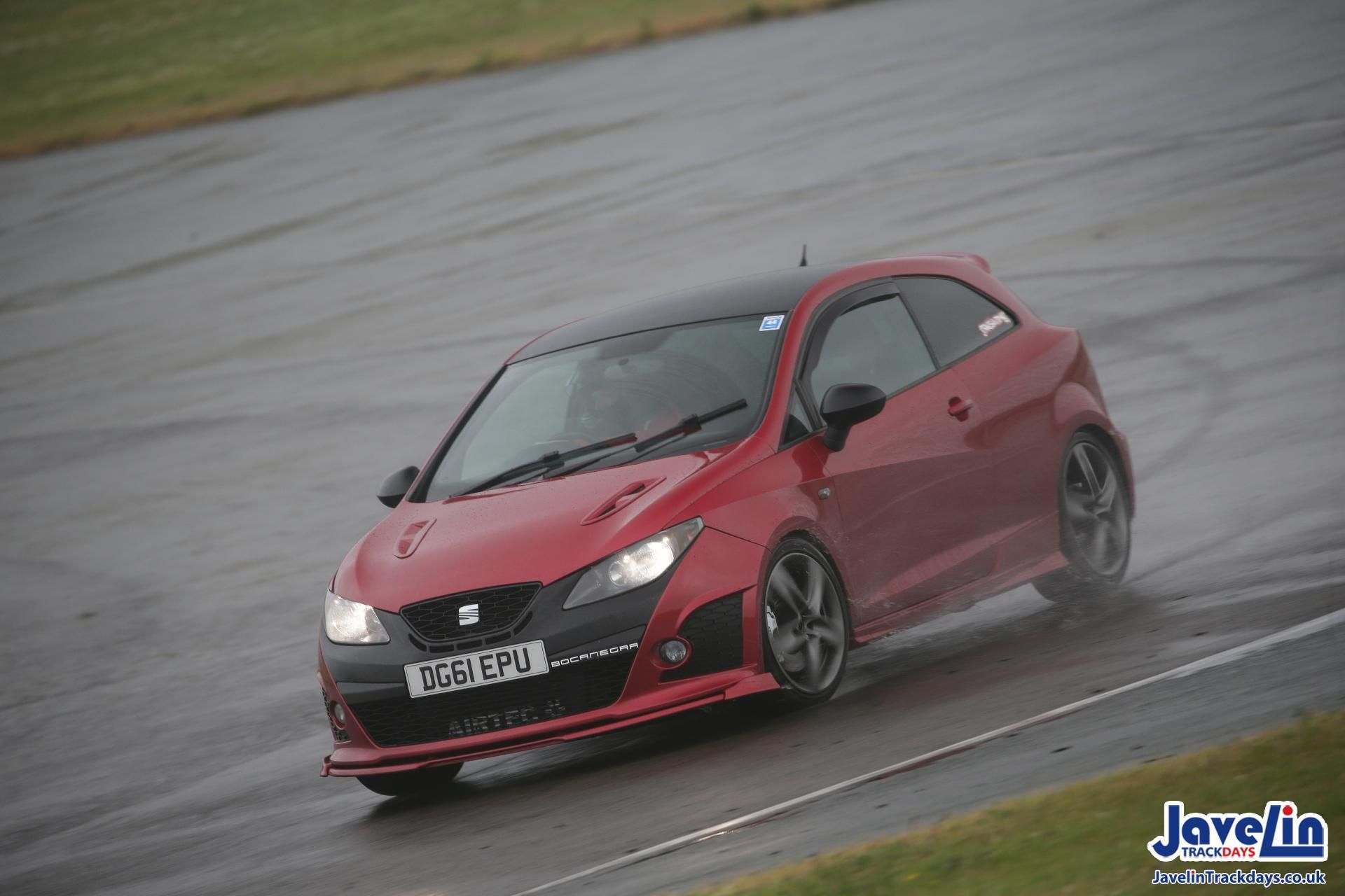

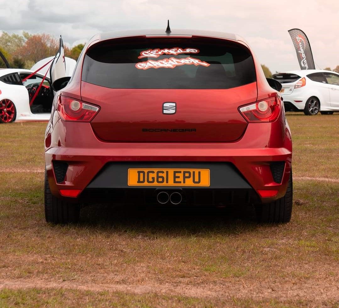

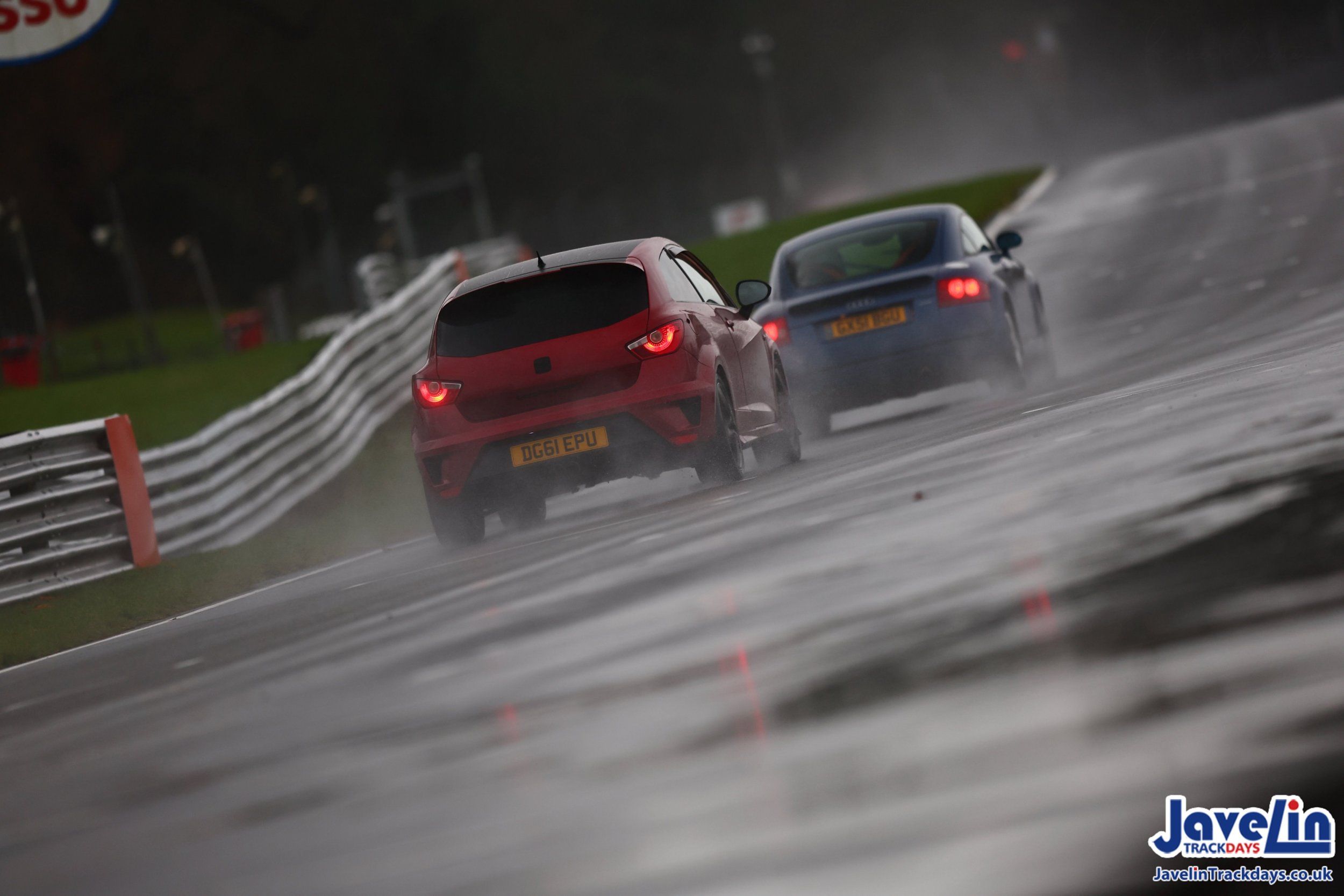

Couple of updates, Recently went upto Trac Mon in Anglesey, Bit of a wet one but no problems for the Boc.
Also been to a couple of local show's over the last few months
Best of both worlds Track/Show builds :D:D

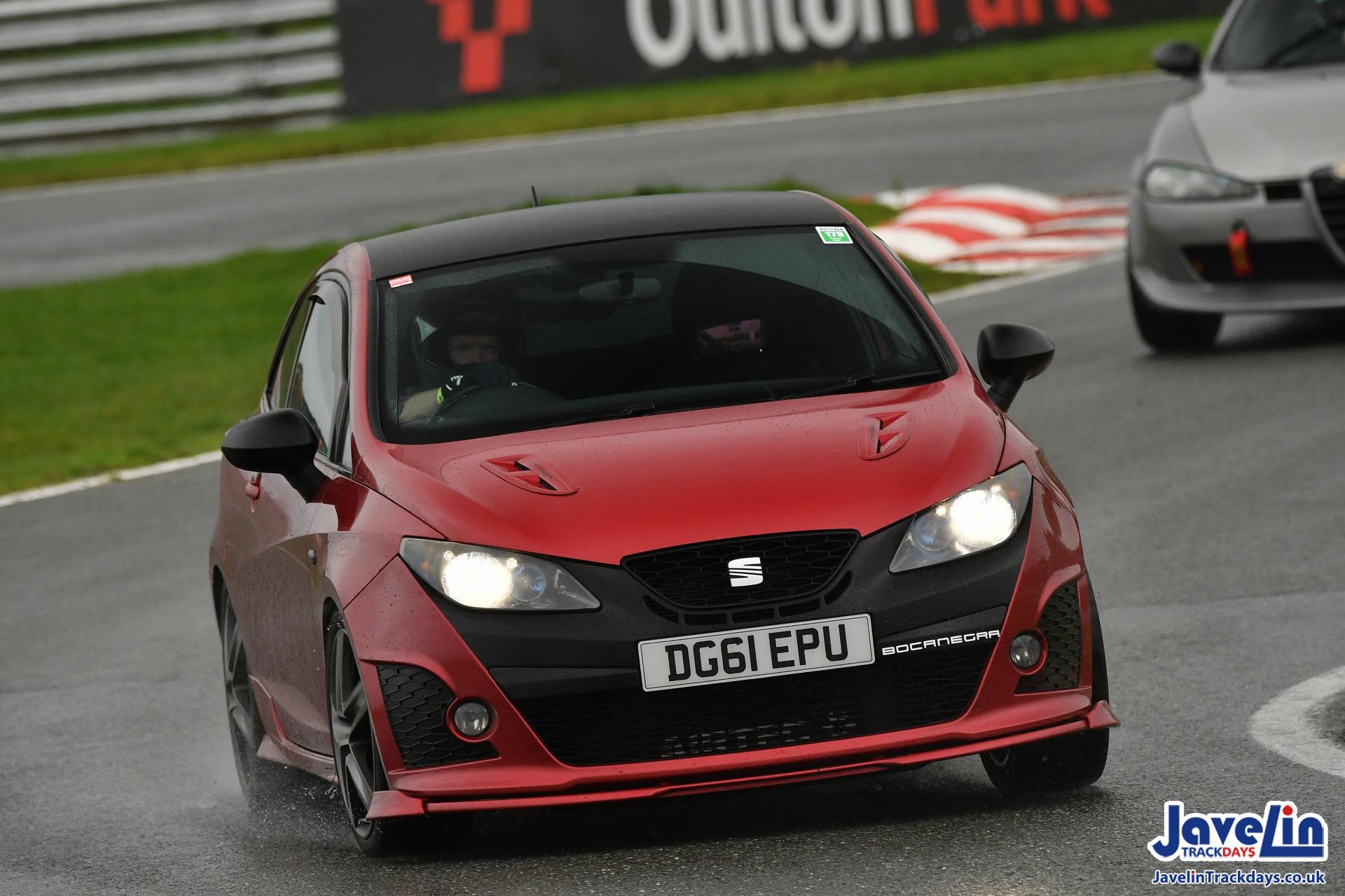

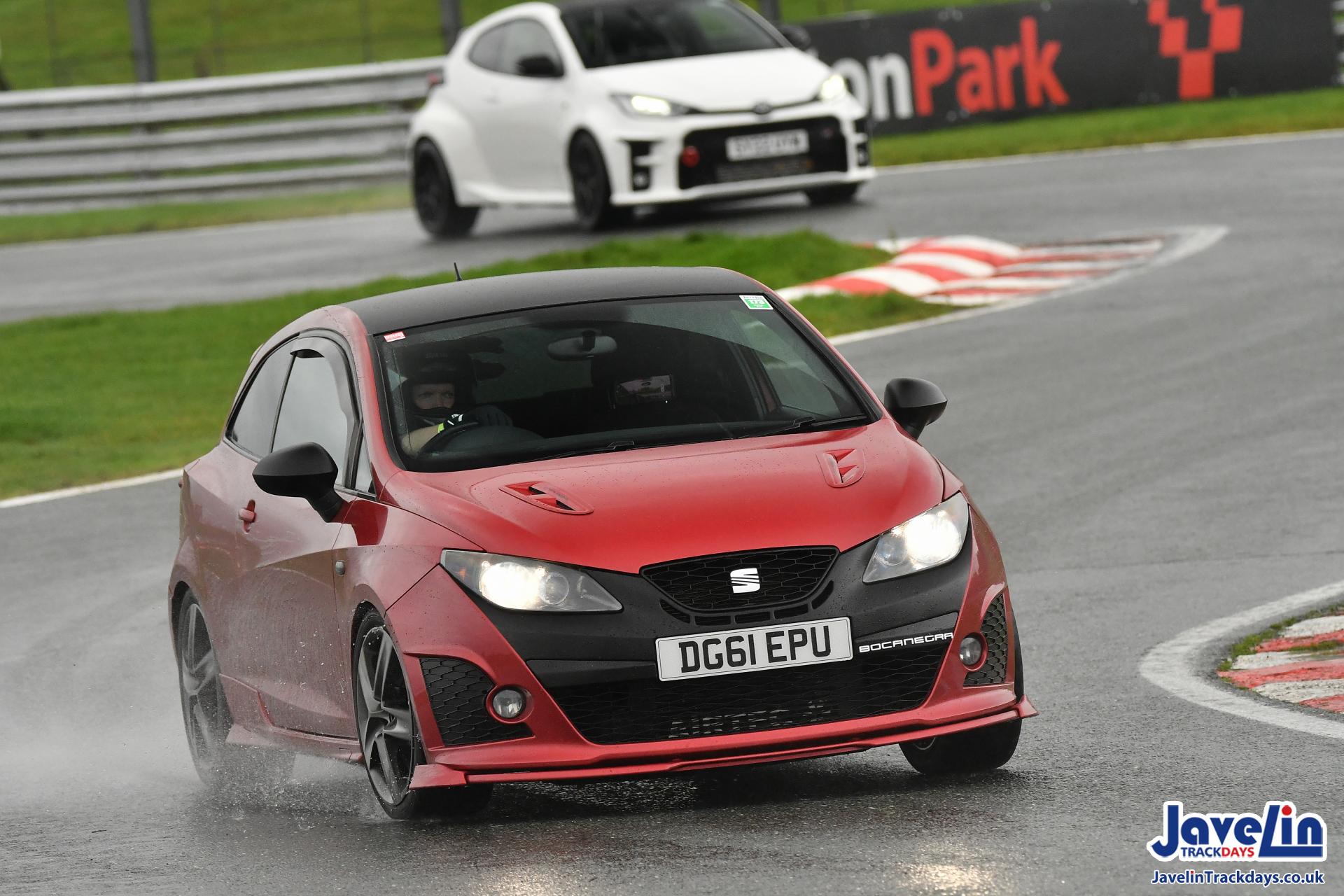

Another track day complete.... First time around Oulton Park, Loved it!! Definitely booking again in the summer The car boosting like a champ, No errors, no burning oil, no misfires. Hashtag NOT BROKE!! :ROFLMAO::ROFLMAO:

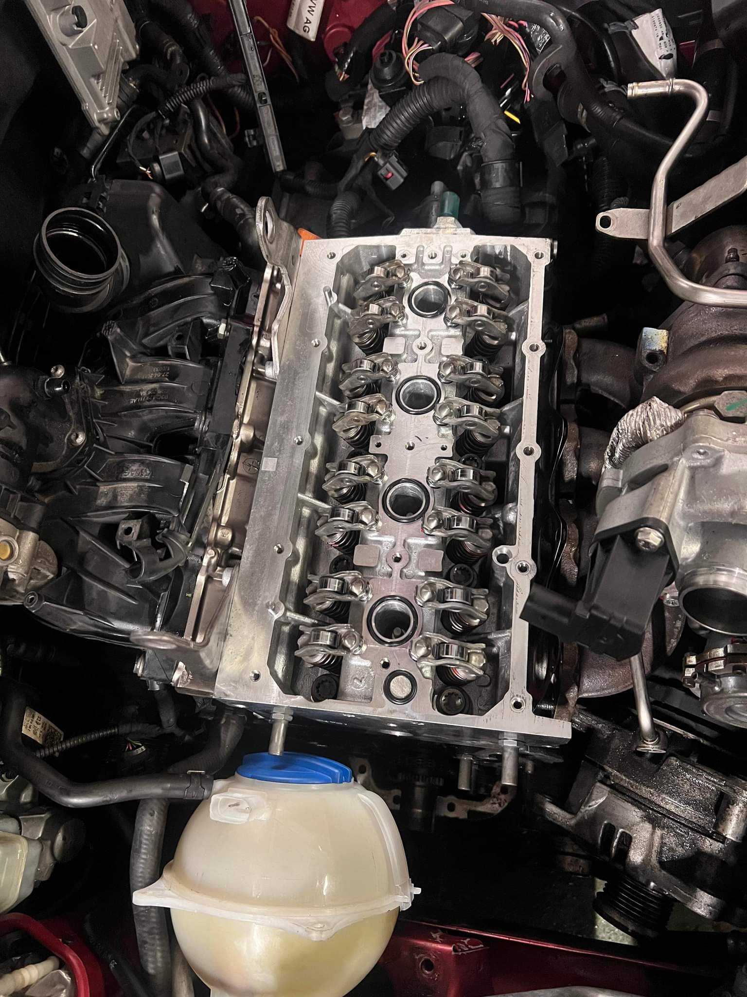

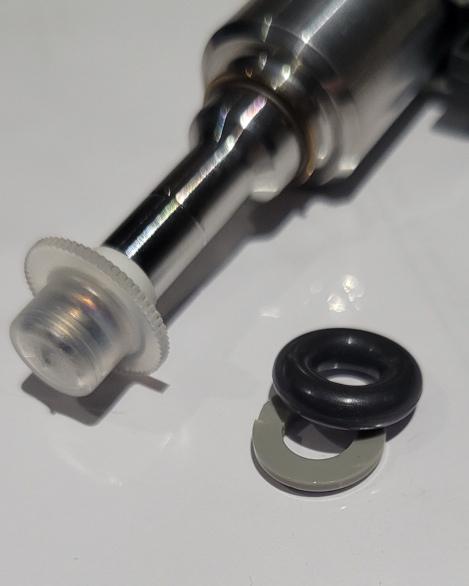

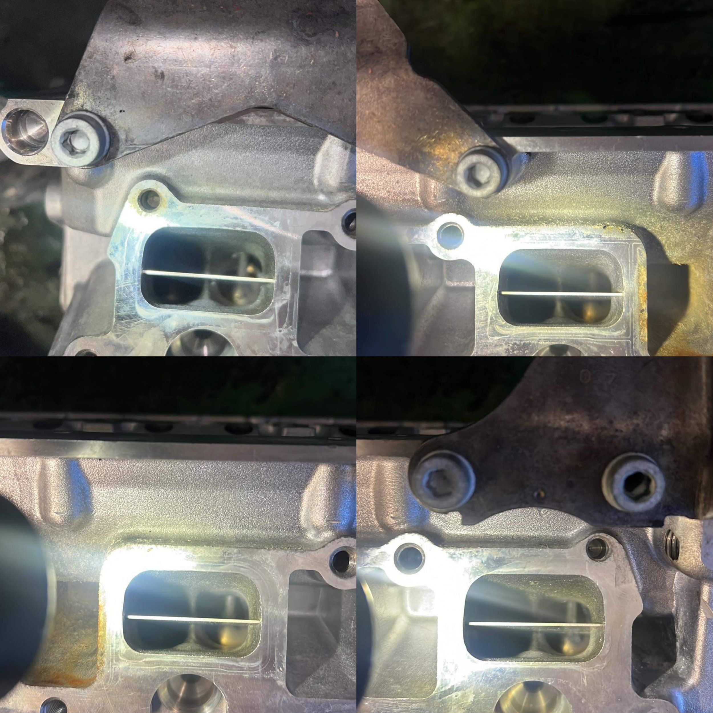

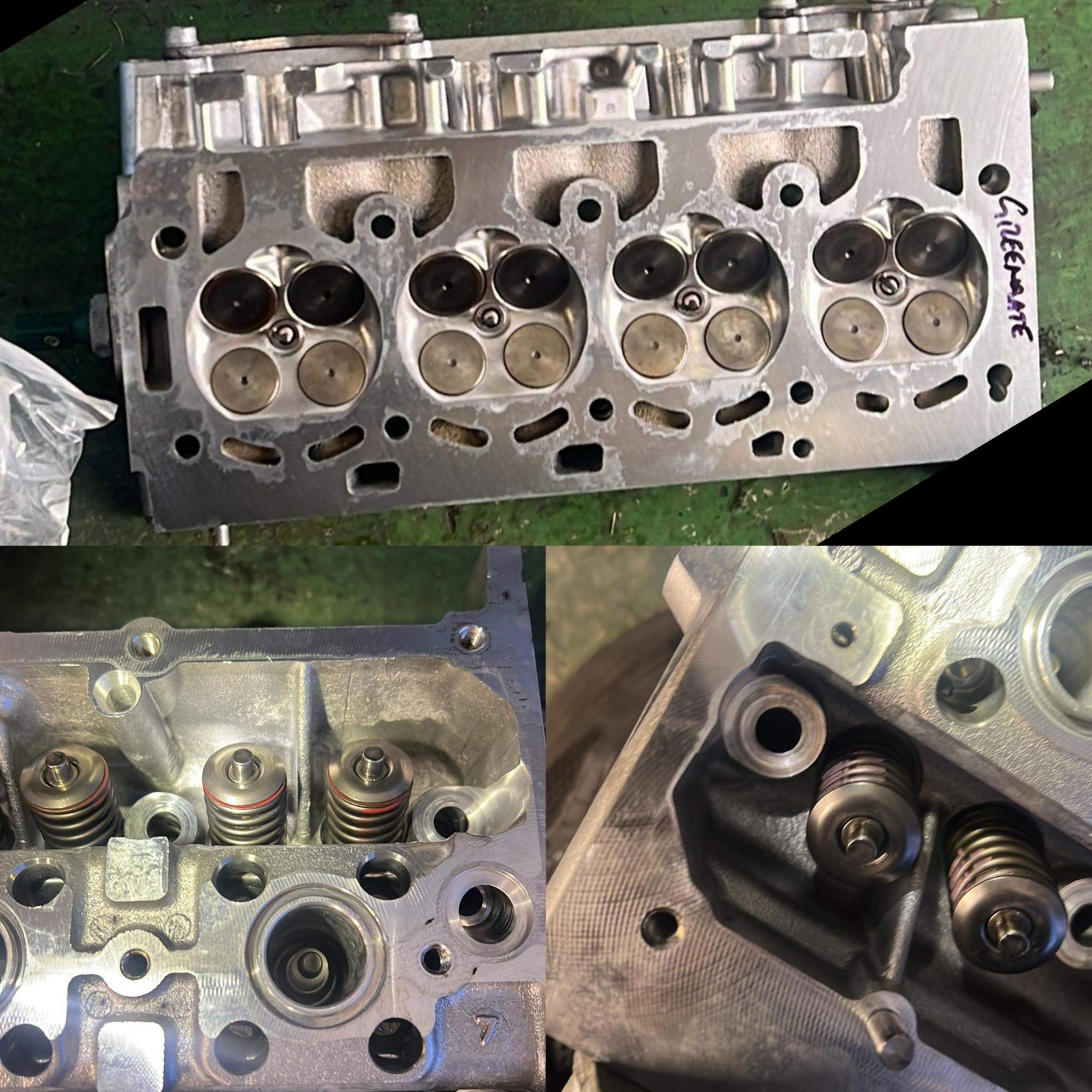

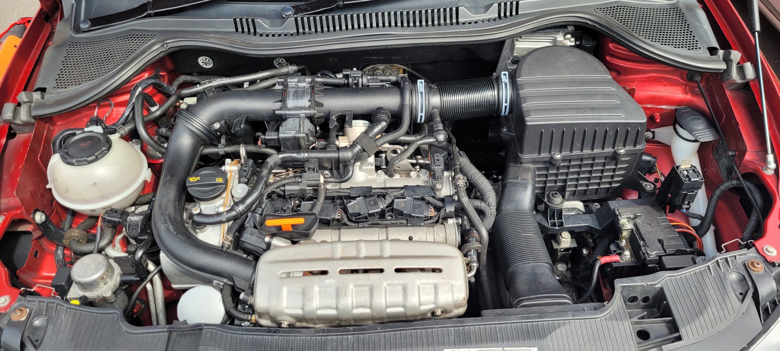

Build update part 1....
As mentioned in the post above I have been collecting all parts for a partial engine rebuild/refresh as long story short going stage3/Hybrid turbo on factory exhaust springs and running too much boost pressure above 6.5k will cause valve float misfires which I have had for 12 months, Having read through many builds from years gone by I found a few had ran into the same problem around 10 years ago to which the fix was stiffer OEM exhaust springs.
So work completed....
Carbon cleaned head
Valves lapped & Seated, Replaced Exhaust Springs with OEM 036109623AC
Replaced Intake Springs & Valve Stem Seals with OEM Stock 036109623R/036109675A
While the head was off I also did the 2 major items Timing Chain & Water Pump/Supercharger Pulley
(side note VAG actually revised the timing chain and sprockets at some point post CTH manufacture to a chain with fewer but longer links and sprockets with fewer teeth to accommodate the new chain, THIS is something I have not seen mentioned across any forums, what this means is if anyone is having a timing chain done for the 1st time will most likely need the COMPLETE kit incl sprockets, not a partial kit of chain, guides and tensioner (which is what most threads mention) Also threw in a DSG Mech fluid and oil change for good measure.
After a week in my mates workshop I collected the car this morning which included a little bonus of information that a some point before
my ownership the car had a short block CTH replacement under recall work (something I always suspected) plus pistons were checked and all looking in top condition along with the bores while in the workshop (Happy Days) so now I'm pretty running a full CTH Engine minus the ECU
Engine ticking over quietly, DSG silky smooth and with a quick venture into redline to check all the work was worth the effort.........
YES, 0 Misfire 0 Valve Float
Happy, Healthy Stage 3 BOC on stock internals!!
Part 2 coming soon with a revisit the tuners to tweak the map......

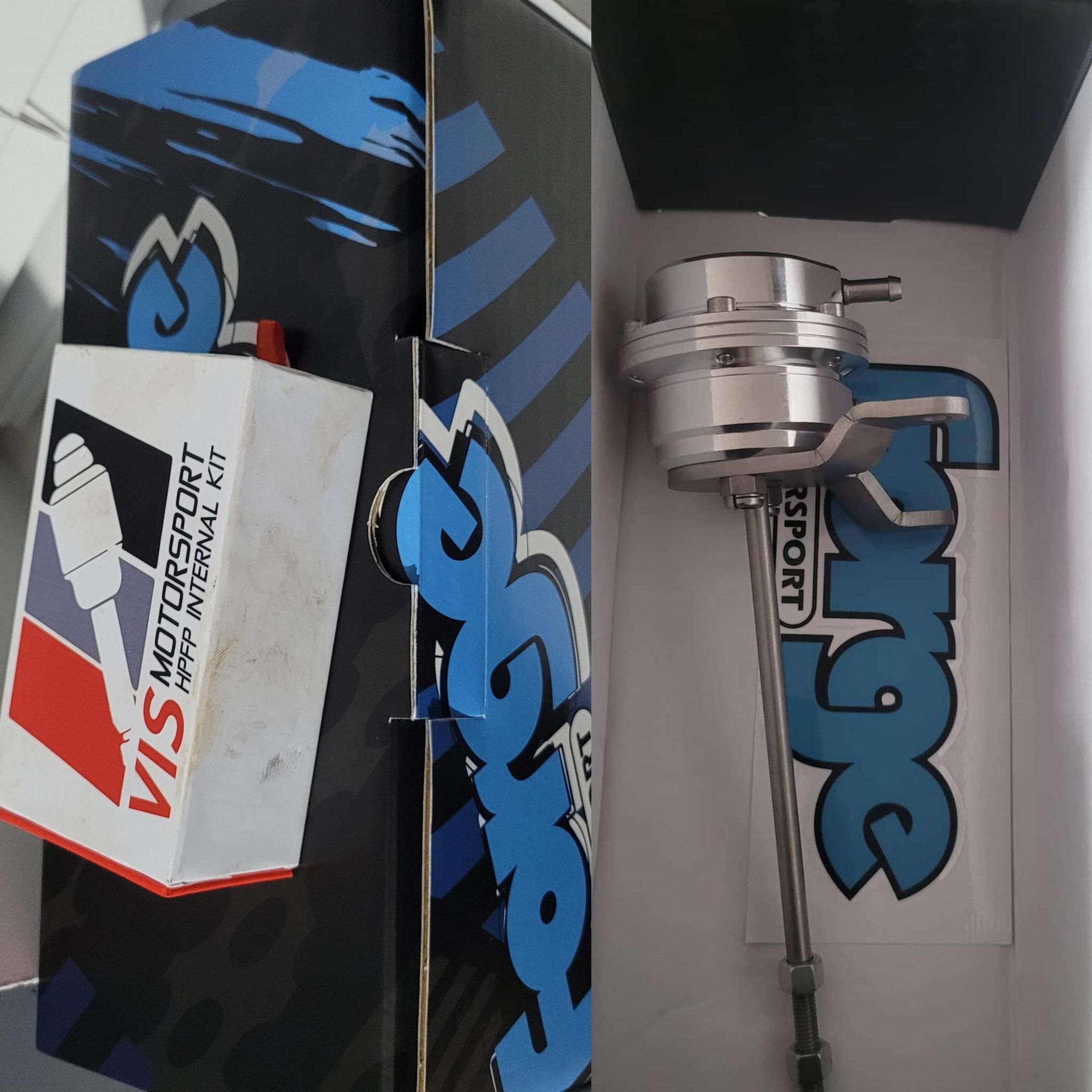

In the meantime a few more mods were added......
Firstly I swapped out the modded actuator from Venom to a Forge Unit with a blue (13psi) spring.
Installed a VIS HPFP piston upgrade to help with final tuning.

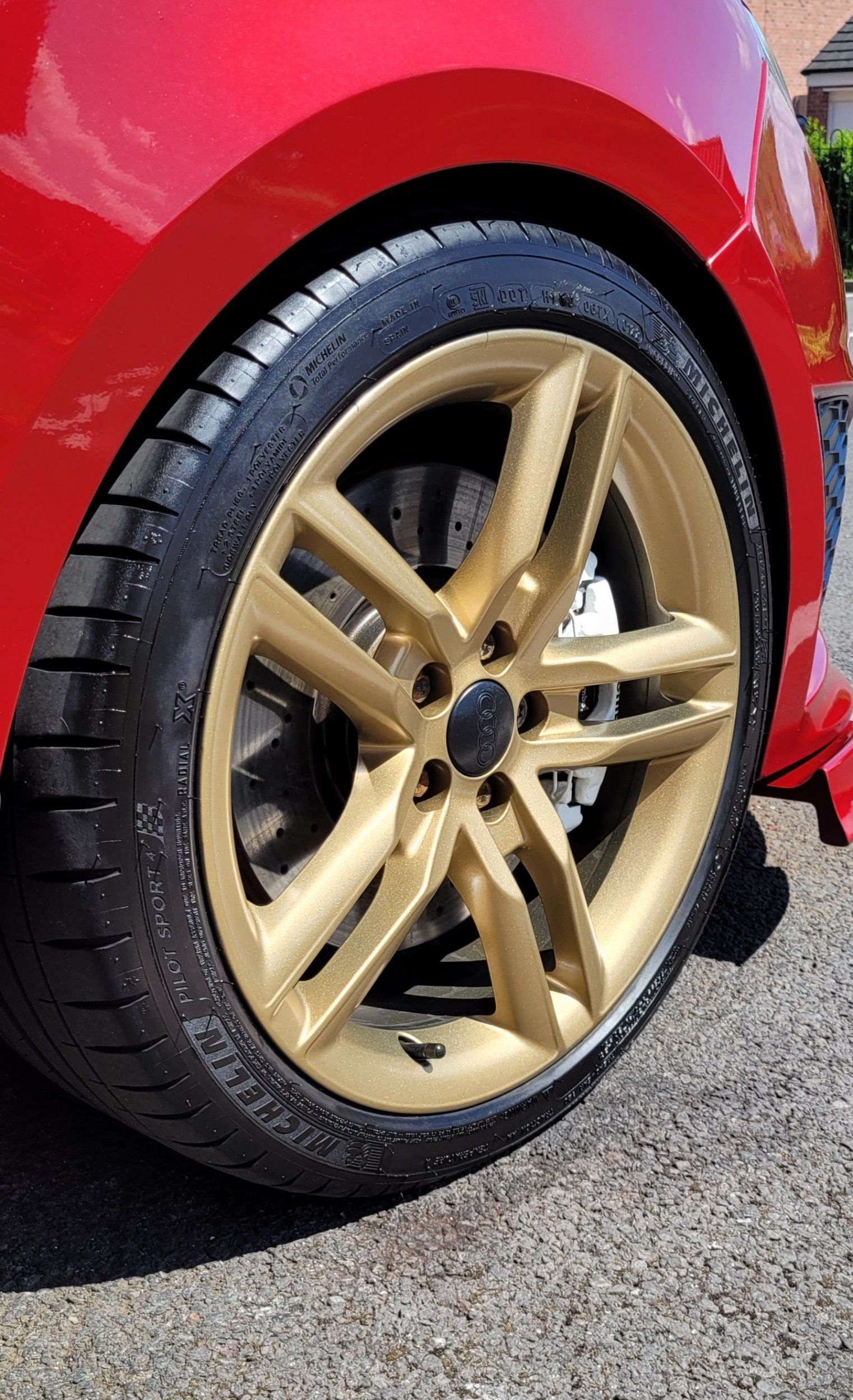

I had the wheels redone in a gold colour from Kia

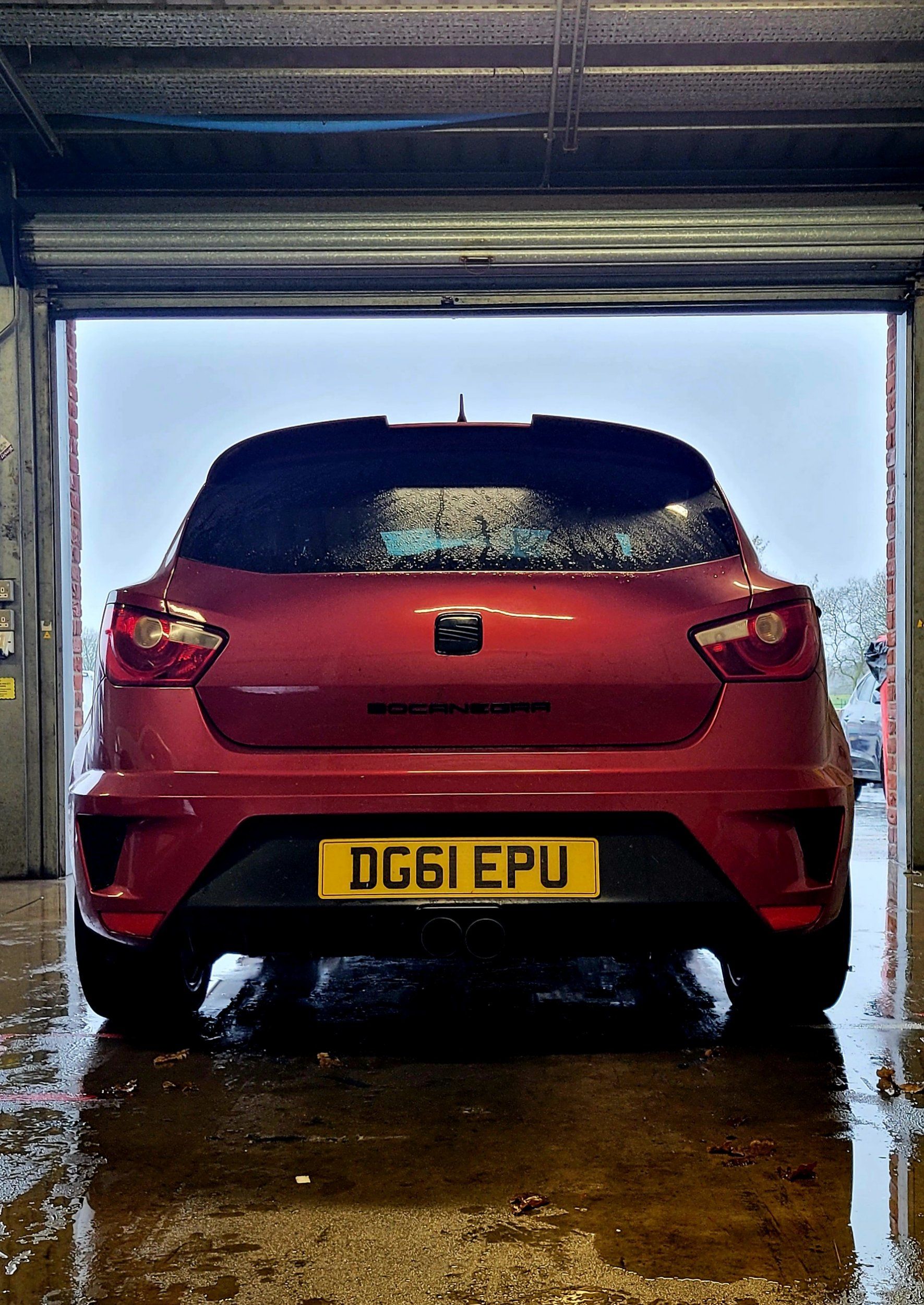

Lastly I took the front bumper & splitter for a repaint plus did a kind of Gloss Black on Satin Black BOCANEGRA lettering on the front (which sort of works)

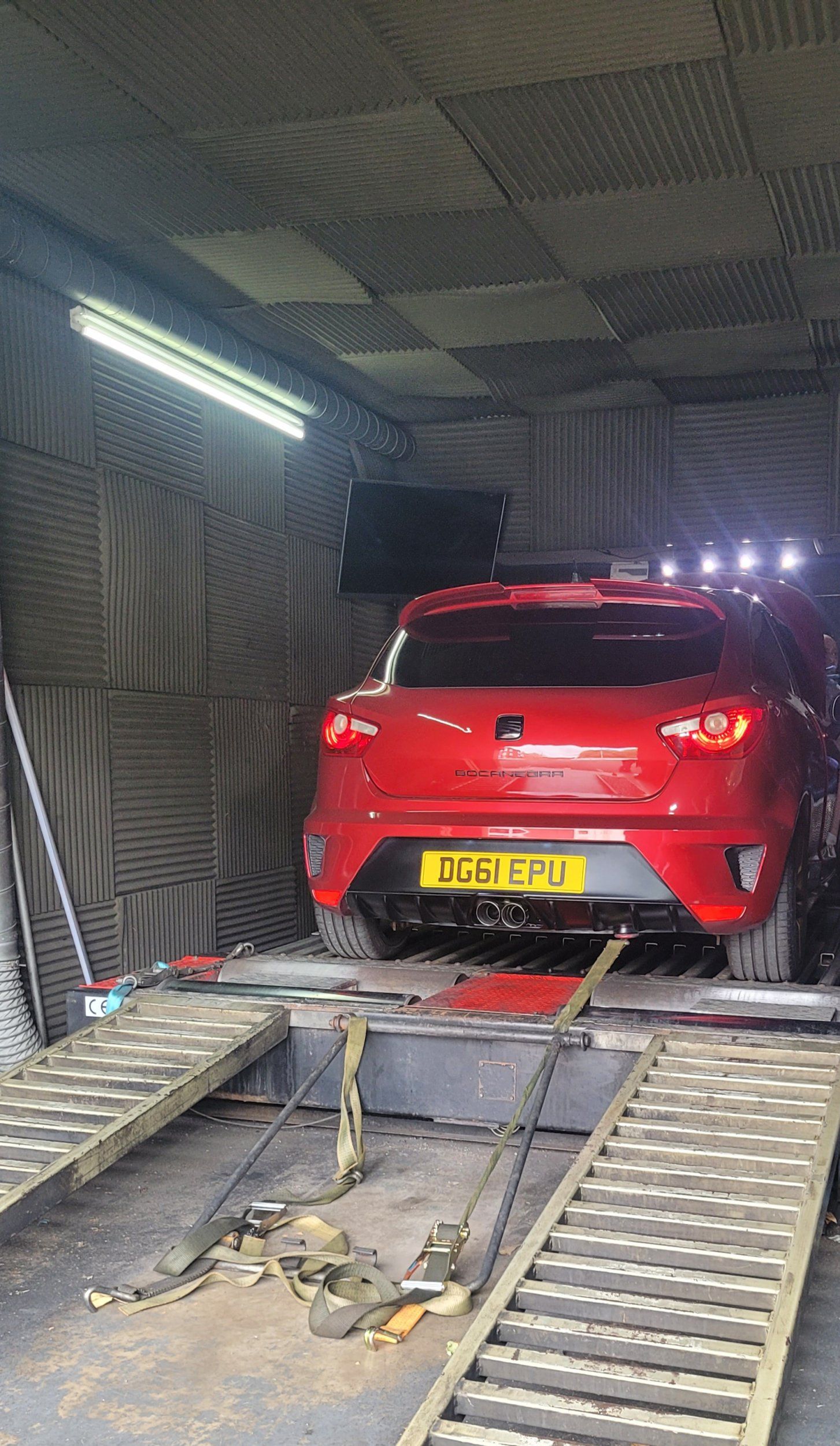

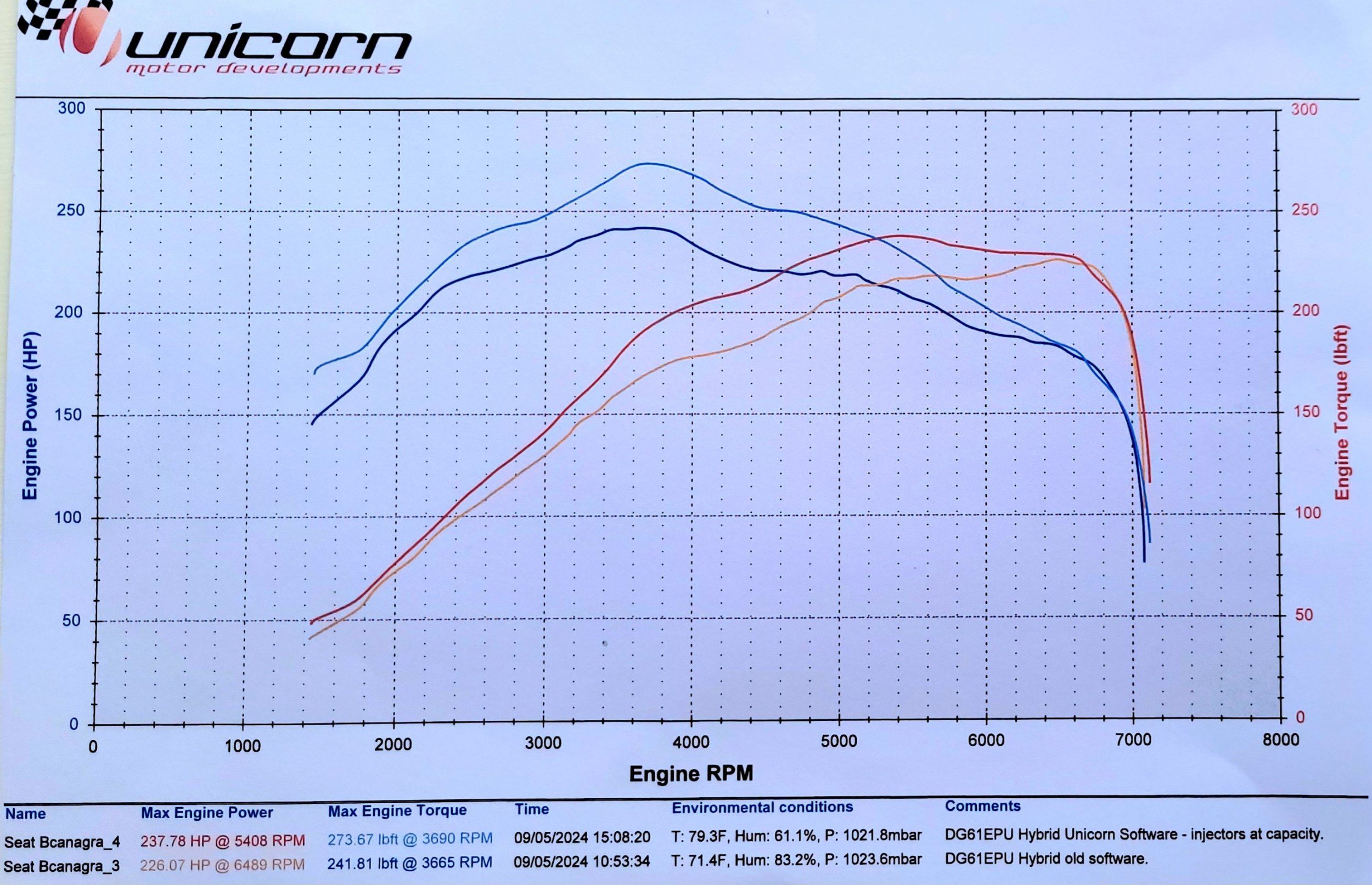

Being a member of this forum and seeing the great tuning work done over the last 15/20 years on BAM engines and alike plus having been involved in the tuning development work for many Venom hybrid's it dawned on me to ask Rick @ Unicorn if he would be willing to finalise my tune
although being aware the EA111 1.4 Twincharger isn't a platform Rick would generally take on due to it's reputation (understandably so).
So where did I differ?? As above really, being the ONLY UK Bocanegra (Possibly ONLY UK Twincharger) to be running a Venom K03 Hybrid (who unfortunately are no longer trading) and I think Rick showing some sympathy for me and my 2 year plight to complete my setup
Plus the fact I have taken VERY good care of my engine/gearbox which was evident when data logged by Rick he agreed to retune the BOC
After an initial base run, to completely rewriting the tune and then fine tuning.... 5 hour's later she was off the rollers with a 1 off tune and honestly can't thank the Rick, Mario & Chloe @ Unicorn Motor Developments enough, Absolute night and day difference from the previous tune,
Rick has maxed out the stock injectors and running close the maximum fuel pressure with the VIS HPFP for a HUGE torque mountain in the mid range just as the Venom K03 is on full chat making 1.7bar @3.4K, Holding 1.6bar with a steady taper down in the redline with perfect boost control from the stock N75 and Forge actuator.
I know there are higher figures (few proven, many not) all over the internet AND I have made higher figures on a previous tune however peak numbers are not the be all and end all, Delta under the curves IS, To be hitting peak torque of 273ft lb @3.7K and peak hp of 237 @5.4K all within everyday engine rev ranges is Useable Power!!
Strangling the engine to death to hit some 7k+ hp peak figure pushing a turbo out of it's efficiency zone and making hot air just isn't practical....it's NOT a VTEC!!
So YES...A Quicker, Happy, Healthy 'stock internal' Boc running a hybrid no less!!

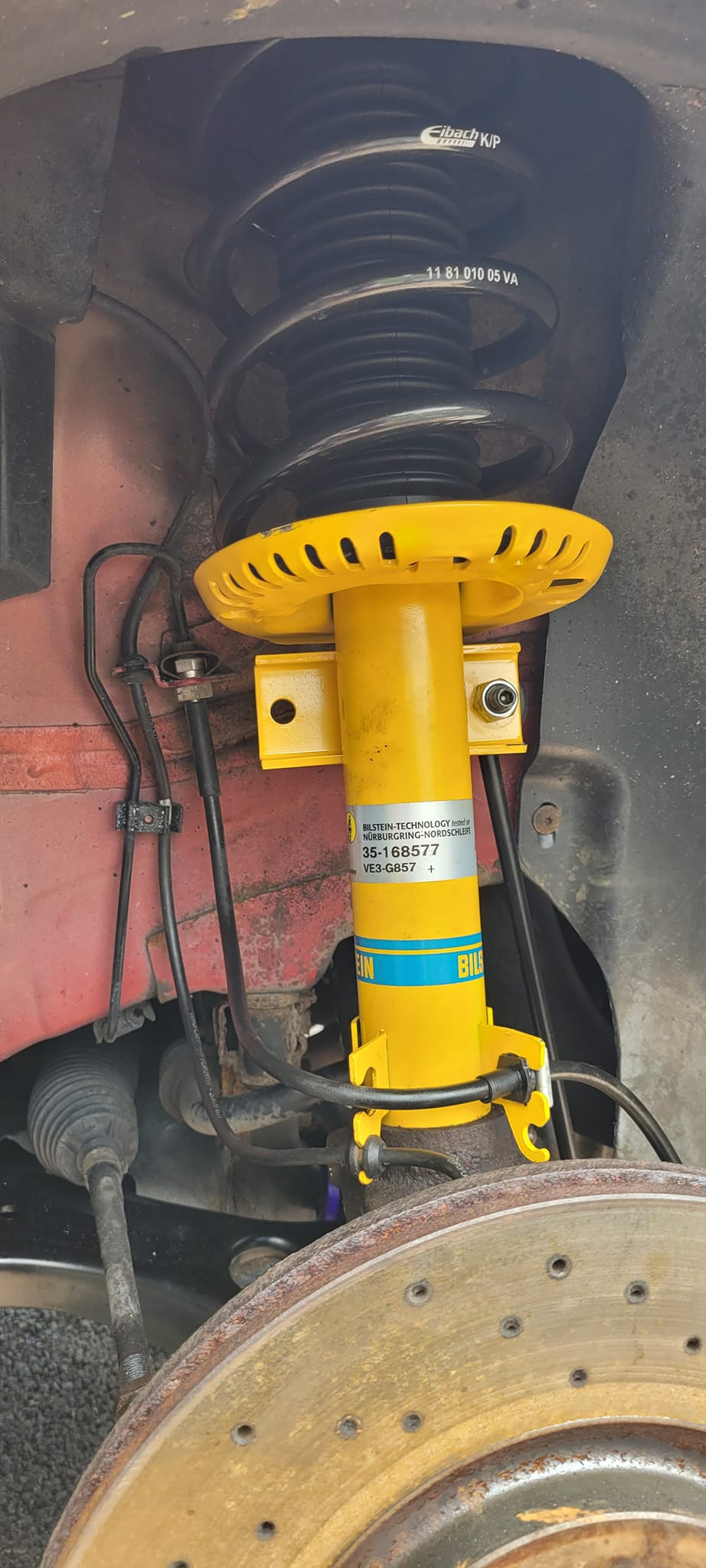

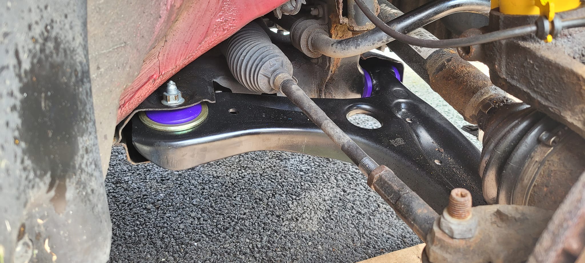

Post tuning I had a few upgrades and maintenance bits still on the list to sort.....

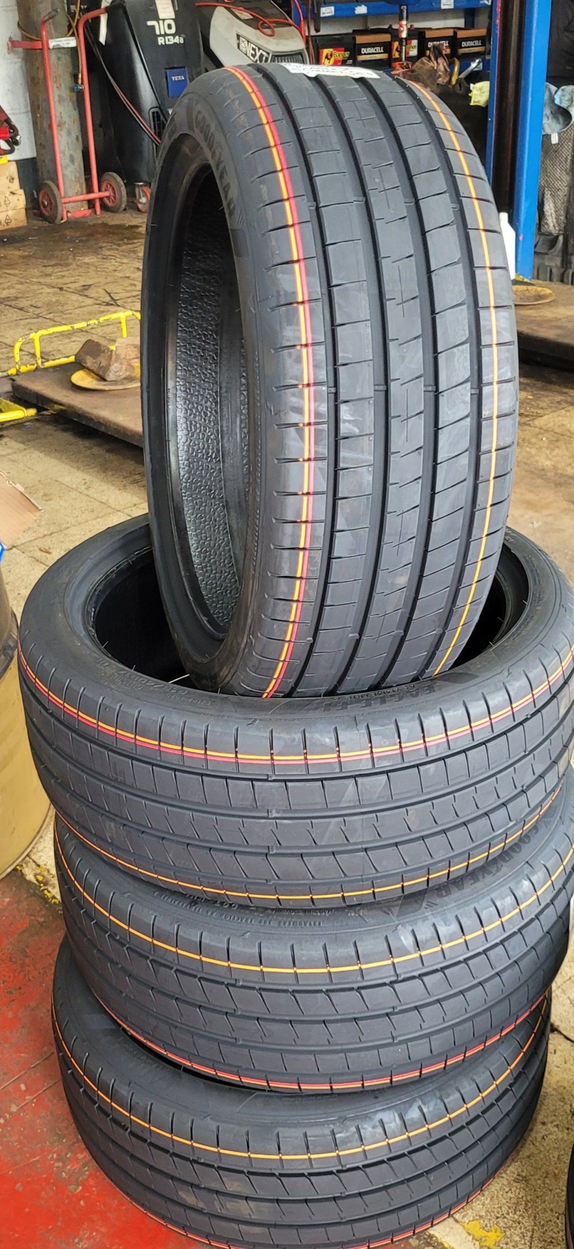

New Goodyear Eagle Asymmetric 6's all round

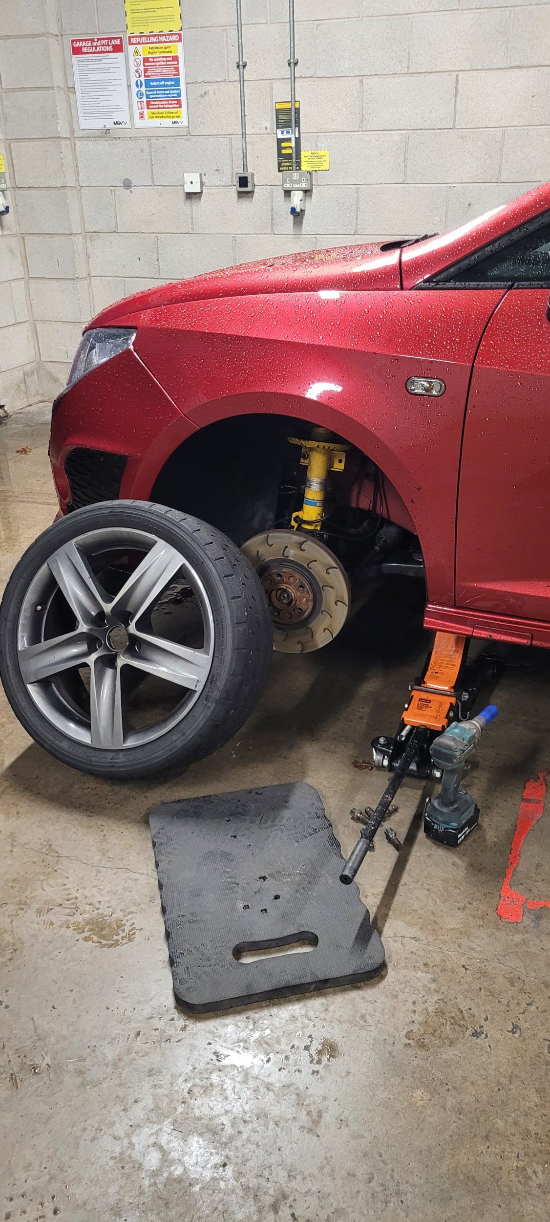

New Bilstein B12 Pro Kit (B8's with Eibach pro springs) after 3 years finally removing the awfully harsh Stance Street+
New Control Arms with Powerflex Bushes
New Vagbremtechnic J Hook discs & EBC Yellow stuff pads
All Calipers sent off for a full refurb and recolour in black
