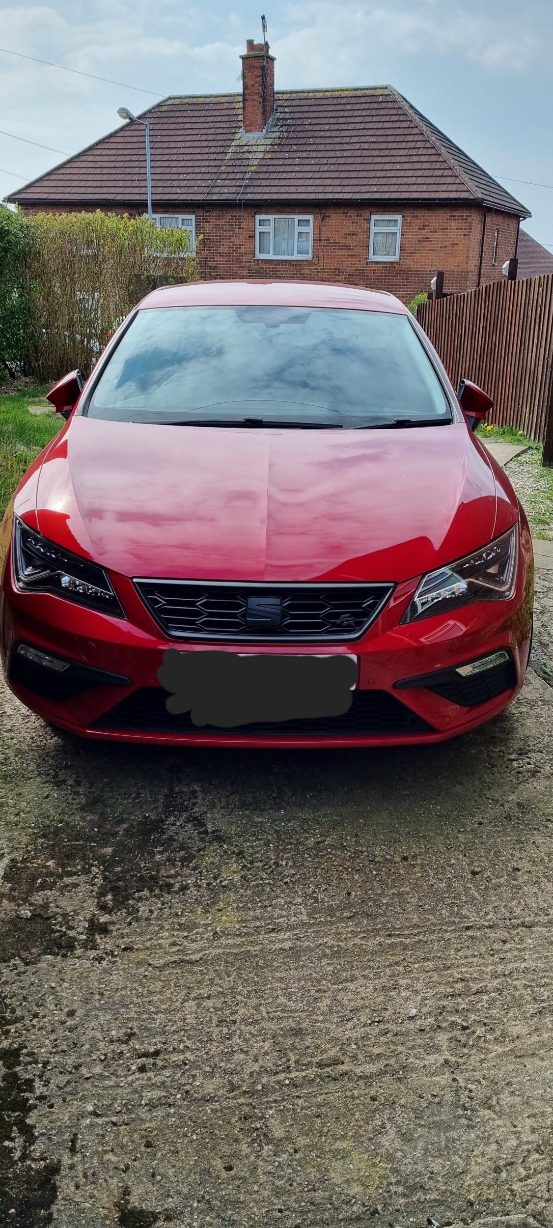

I plastidipped mine today. Easy to do. Second time of doing this as did an insignia previously

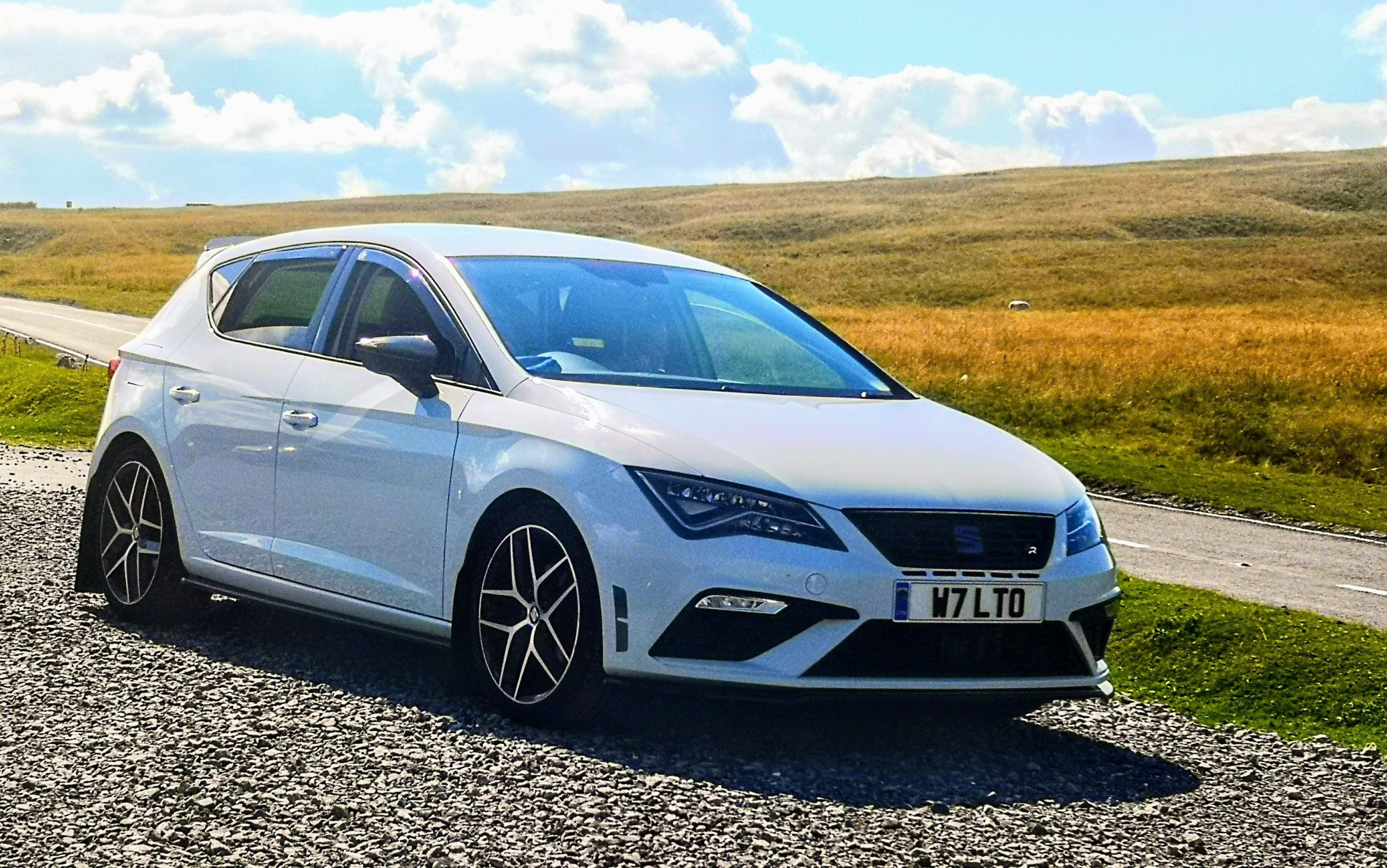

Azizo
Jun 21, 2022
33
10
This looks incredible! How many coats did you use if you don't mind me asking? Are you experiencing any chipping away of the dip yet? I am really contemplating on doing it too but I'm so afraid of completely butchering it to where I ruin the car LOL
Redahead74
Mar 25, 2022
20
5
Midlands

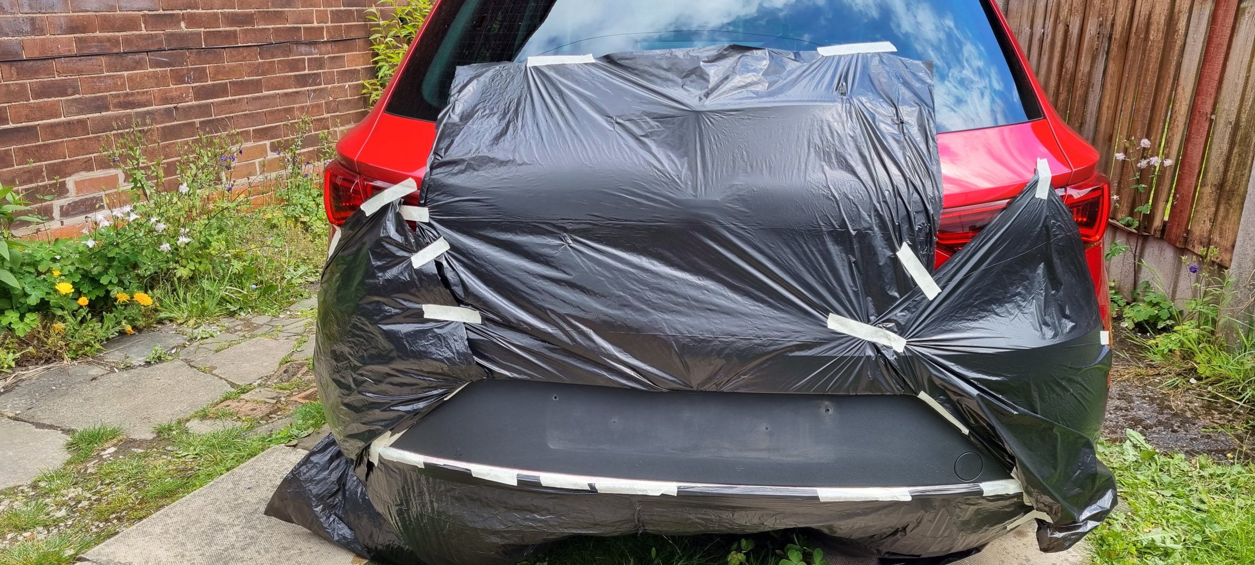

I gave 5 coats on it and left to dry between each coat. Masked up on most parts apart from mirrors as took them off and fitted dynamic indicators.
No peel or chip marks so far but easy enough to touch up if needed.
This is second car I've done with plastidip but it's not difficult to do. Just take time masking it all up first and don't hold can too close or be tempted to spray lots on each time. 1st couple of sprays don't seem to do much but that's how it should be

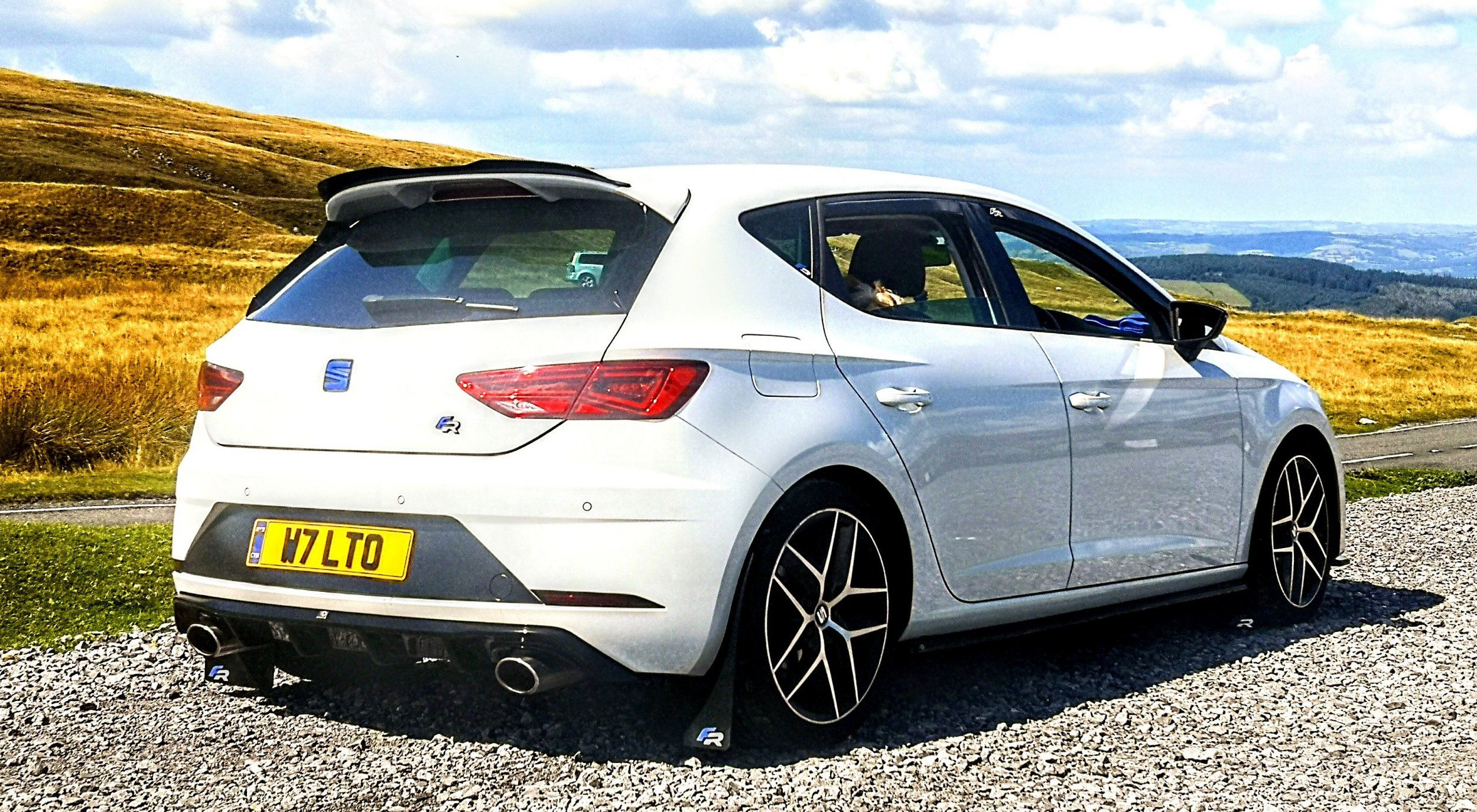

Wilto
Mar 5, 2021
128
60
58
South Wales
Done mine exactly the same, with plasticoat, take plenty of time masking up and as said lots of light coats. I lost count of how many I done as I was alternating between front grill and rear boot badge 😂
I've since added blue coloured S decals to the badges.
