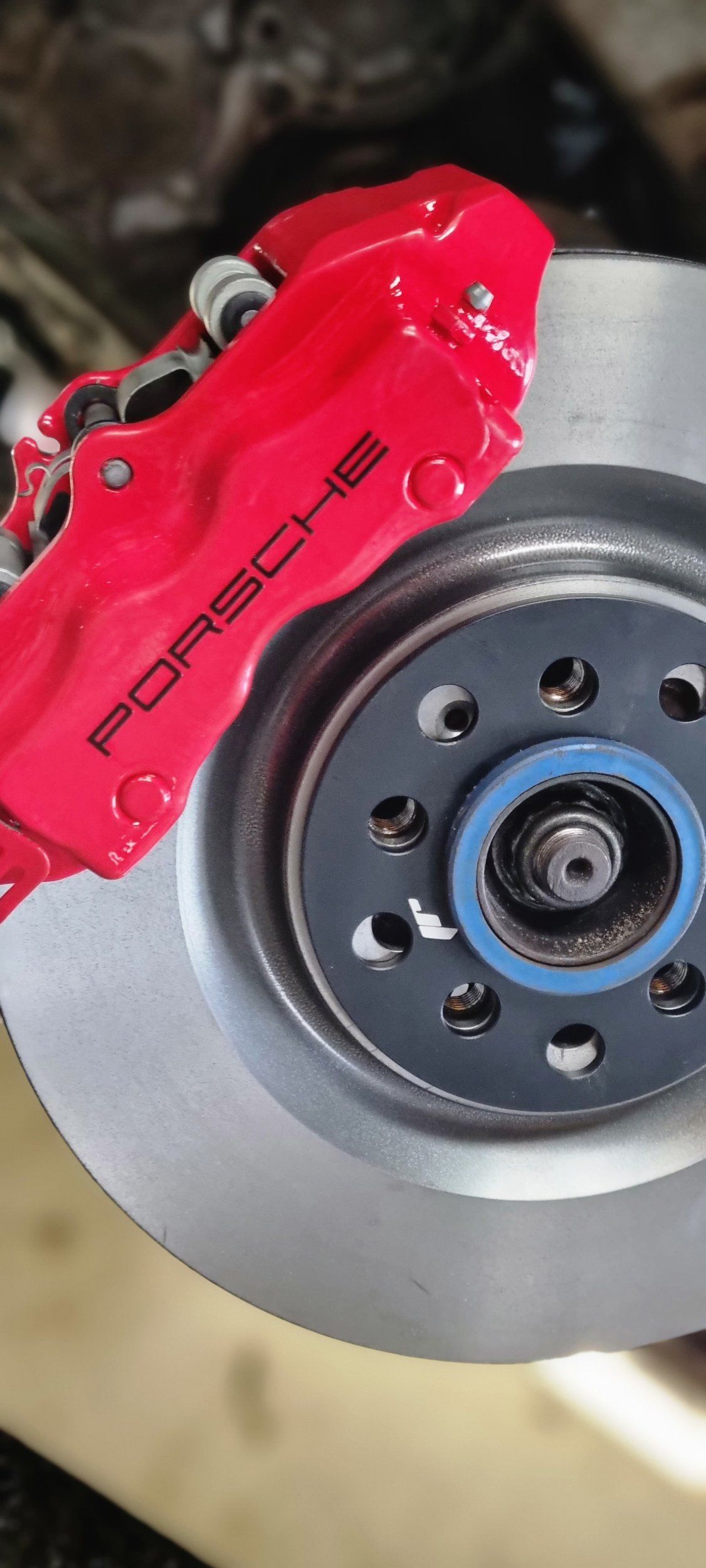

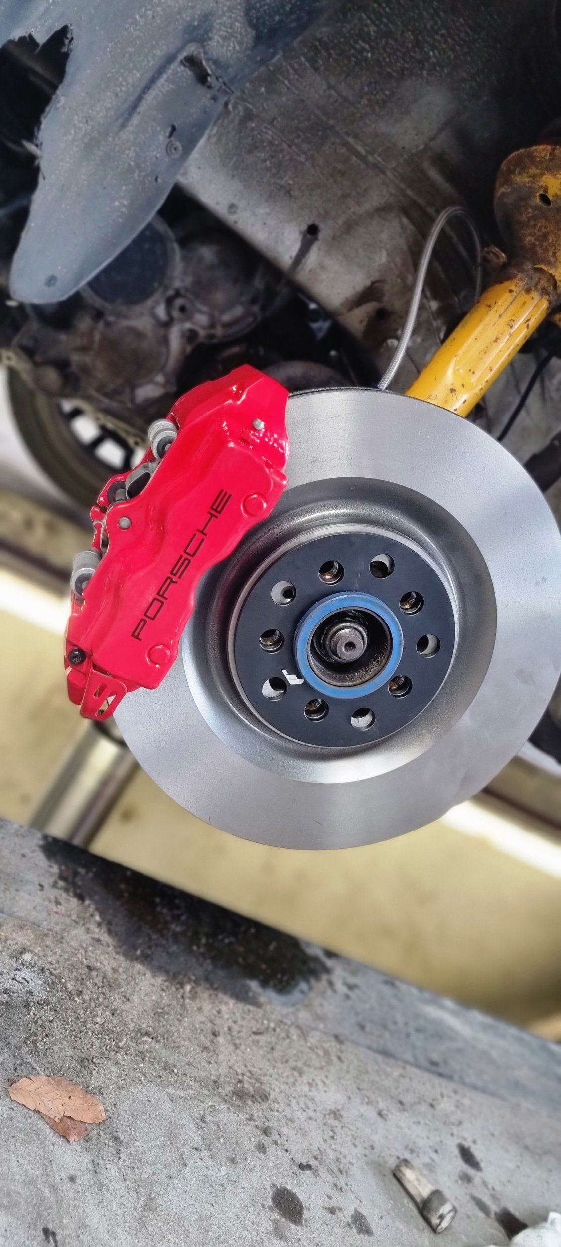

Good evening guys, I am new here (first post ) .
I install front brake calipers from 4 pots from cayenne (wich are rear brakes of that Porsche) .I use a disc size 323 thickness 28mm same one from cupra r with original brembo 4 pot .I already did some km on my brakes but the car doesn't what to brake good . The pedal is hard and they work good when are really hot . In the rear I am with stock 230mm x 9mm thickness ,this make think is it possible I mess with the balance of the brakes ( between front and back ) or there is something wrong. This evening I make more brake times from different speeds 180-100 km , 120-60 km and after that I stop and the rear brake discs were red and smoking .If someone here can give me advice how to fix that because I already invested in this brakes a they don't stop the car better .

Everything is new in the rear ,and they spin without problem .Is it possible that I have air in the front brakes because it was my first time that I work with 4 pots . Also the brake pedal is very hard I need to use a lot pressure to brake normal when they are not warm .

The bleed nipple is on the top something tells me you make have to invert the caliper to bleed them sure i read that once upon a time

Yea that's true they have two nipples left and right on every caliper ,but turning them upside-down and push the brake is not going to work very good .
