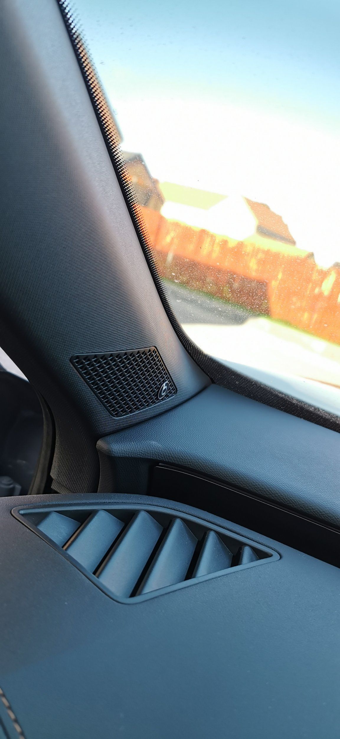

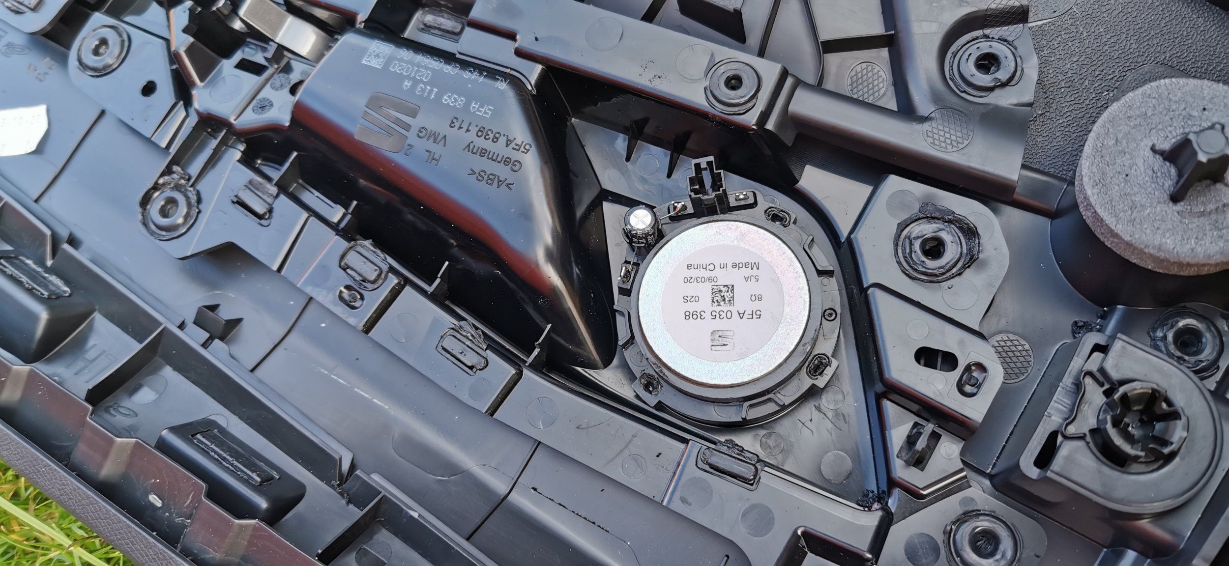

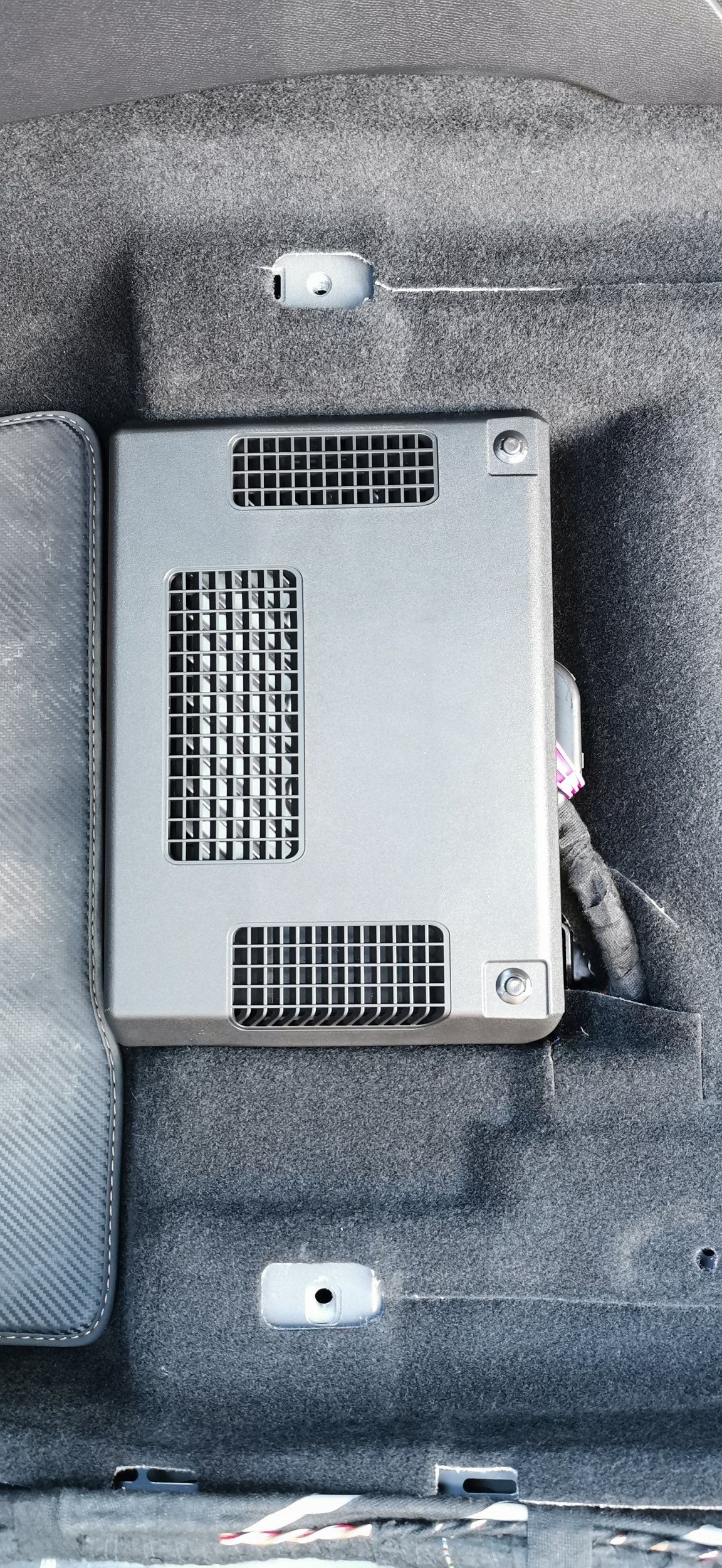

The rear doors are now finished. We've taken the tweeters from the old A pillar trims, replaced the rear door wiring looms for the factory beats looms & sound deadened the doors. We had to repin the replacement loom due to the choice of tweeter & use a different plug.
We decided to use the old tweeters in the rear as the alternative was new door cards at around £600 just for the sake of two 2" speakers as you can't buy them seperately. This is the only compromise we're making.
The front doors are also finished. Again, speaker replaced and sound deadened

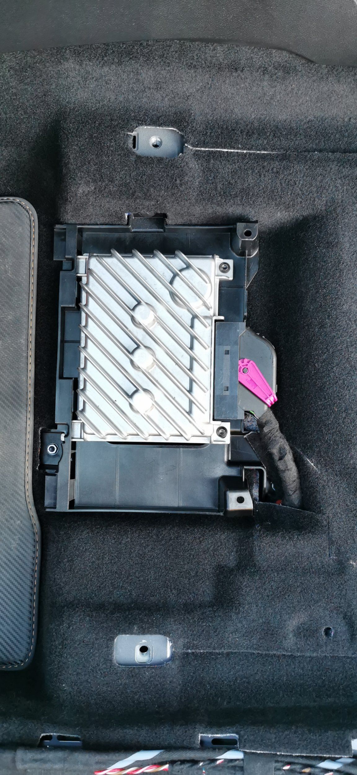

Jobs for tomorrow are;
Seats out
Glovebox out
Amp in
Wiring loom made up from amp to door connectors, to fusebox, to MIB unit, A pillars and centre dash speaker
Run rear heated seat wiring to fusebox

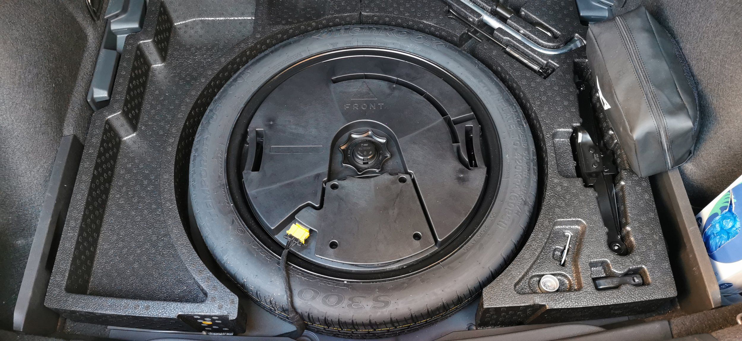

It must be since its got a sub woofer and assume the power amp isnt in the normal outfit + the centre speaker... I think they used the existing speakers for the rest which I believe was the normal Seat sound system prior to Beats and Sound (e.g.. same speakers plus the two extra). You get the under seat amp plus the front central speaker and sub woofer, it's the amp which is the new contender to Seat, was on other VAG brands.
All of the speakers have been replaced except the centre speaker, all of the wiring to the speakers is new. Rear door looms have been replaced and the amp is new

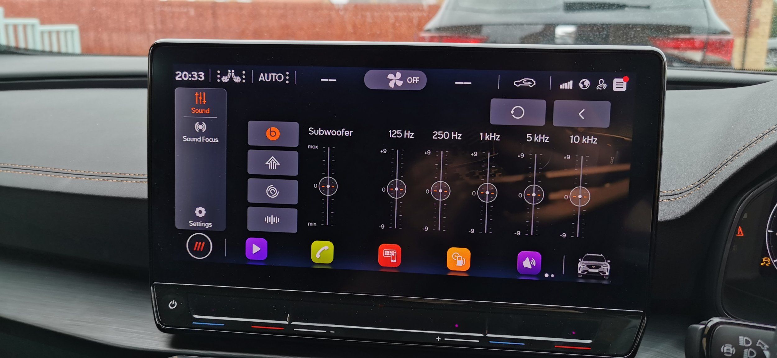

It's a much fuller sound & the rears now how independent speakers for high frequencies instead of dual cone speakers in the rear doors which sounds much nicer.
My main gripe with the standard system was the lack of power, meaning whenever there was a reasonable amount of bass the volume of the full system would drop. This issue has now gone
For the relatively small cost the option is from the factory, I'd say 100% go for it

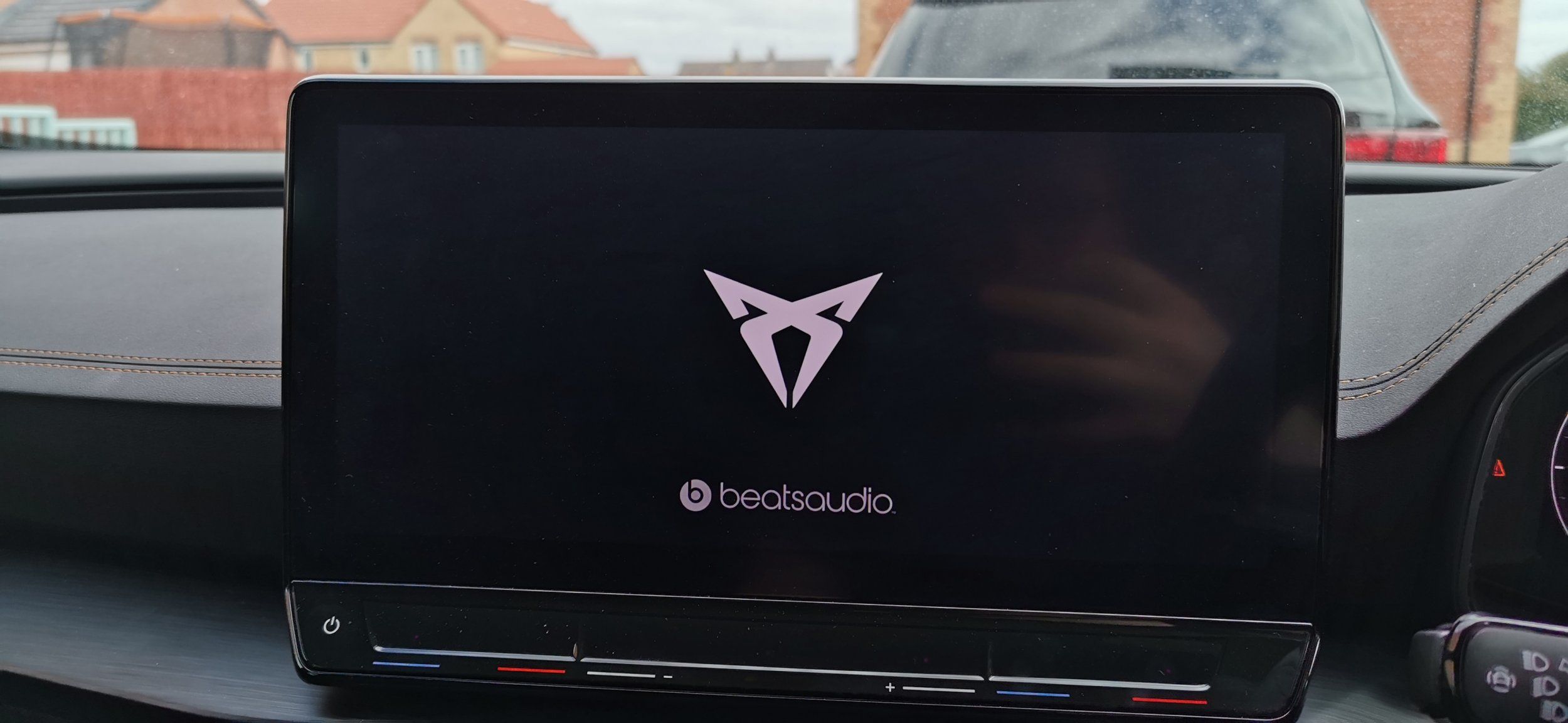

Did you have to recode the infotainment system or was the blessing that it runs off the outboard amp which was plug and play or SFD coding on the 5F to make it possible... suspect that amp might have it's own coding or is it just dumb ?.
I'm presuming your Formentor is the coding test bed 😉. Have you got your SFD tokens sorted out... I did read on a German Formentor board that there was a company that had a coding hack for SFD, another dongle.... some Germanic translated grumping on that one. Some people have side stepped it.
(My Ateca has the original Seat Sound System with the centre front additional speaker and sub woofer in the wheel, interesting the set up defies traditional surround sound by placing what's getting on for a sub woofer speaker in the front dash and the sub woofer in the boot - you get quite a bit of base thru that front speaker... lower base in the boot. A part from twiddling with the frequency response to improve speech, it works reasonably well... I'd always spend money on the sound system)
Nothing about this was plug and play, which added to the satisfaction once finished!
I'd be amazed if they've managed a work around already given SFD is managed by the module itself and cannot be calculated locally. It has to call home to the VWAG mothership and receive a token which from memory is about 100 characters long. Do you have a link?
Infotainment system requires coding and parameterisation. Amplifier requires coding and parameterisation + component protection
Everything you do within 5F requires SFD. Each token gives you 90 minutes of working time.
Fortunately we're a VWAG independent workshop so SFD isn't an issue, nor is component protection 🙂
The amplifier takes its control via canbus and data via ethernet, in previous models it's been via canbus & MOST.
The centre speaker isnt used as a subwoofer. The centre speaker is primarily used for high/mid frequencies which is why it's used alot for phone calls/navigation announcements with the seat sound system. The pillar speakers and rear door handle speakers are for highs. The larger door speakers are low/mid. Subwoofer for any real "heavy" graft with the bass
For what they're charging for beats it would be silly not to tick the box. I'd think twice is they were charging golf 8 Harman Kardon prices. It's good but it's not worth anymore than what they're charging.
Fun fact; Harman Kardon uses the exact same amplifier but features more speakers, each on independent channels - Beats slacking as per usual
