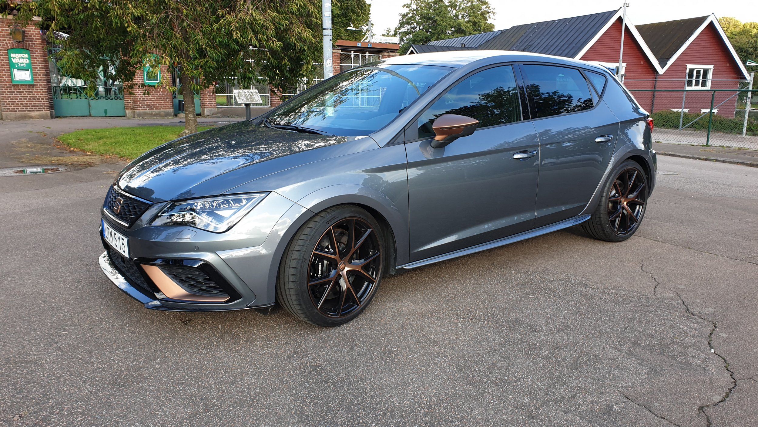

My 2018 Cupra R is produced Februari 2018 is a "copper" car. No GPF. As H Rafiq describes
better to use other criteria.

So yours is 6 gear DSG, right? So the “theory” I said about the DSG6 and DSG7 is correct ;)
Nevertheless, the best way is to check the motor code of the car. DNUC/DNUE cars are GPF, while CJXA/CJXC are no GPF.

All mk3 2018 Cupra R in SE are manuel 😁. Code CJXG 310 hp as mine, no GPF.
I agree regarding check motor code. This is the way to go.
