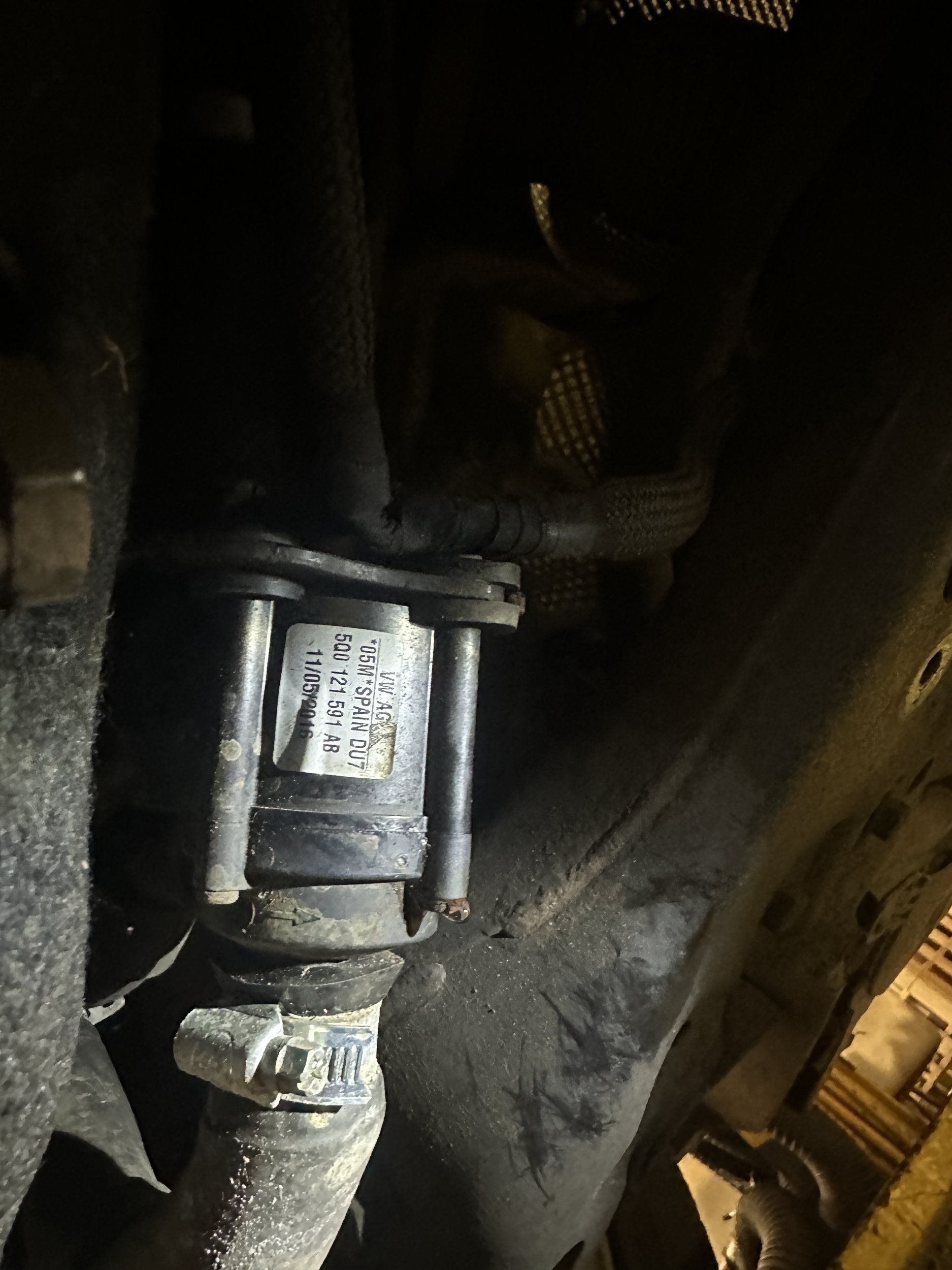

I found a coolant leak coming from what’s apparently an auxiliary water pump next to the sump plug, I have a 2.0tdi 184ps 2016 Leon and I can’t seem to find the part online anywhere. PN - 5Q0 121 591 AB

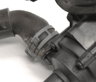

That hose clamp isn't genuine - someone's been under there before!
Are you sure its the pump that leaking and not the hose clamp.
This is the OE clamp - a constant pressure type.
The paper label with 5Q0 121 591 AB is not the pump part number - more like an assembly/manufacturing part number.

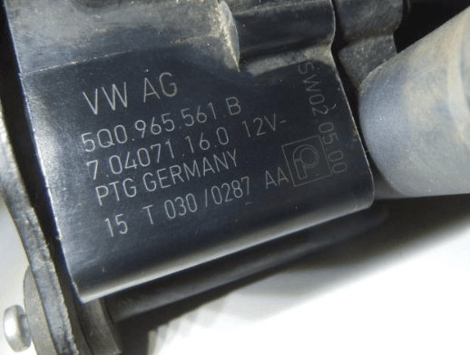

The actual pump OE part number is: 5Q0965561B
Made by PIERBURG whose part is: 7.08002.01.0
The list price of the OE pump is £170+. I can see some suspiciously cheap <£30 pumps on ebay which I would avoid - they have photos of the OE pump but in the small print some strange chinese brand so NOT the actual OE part.
