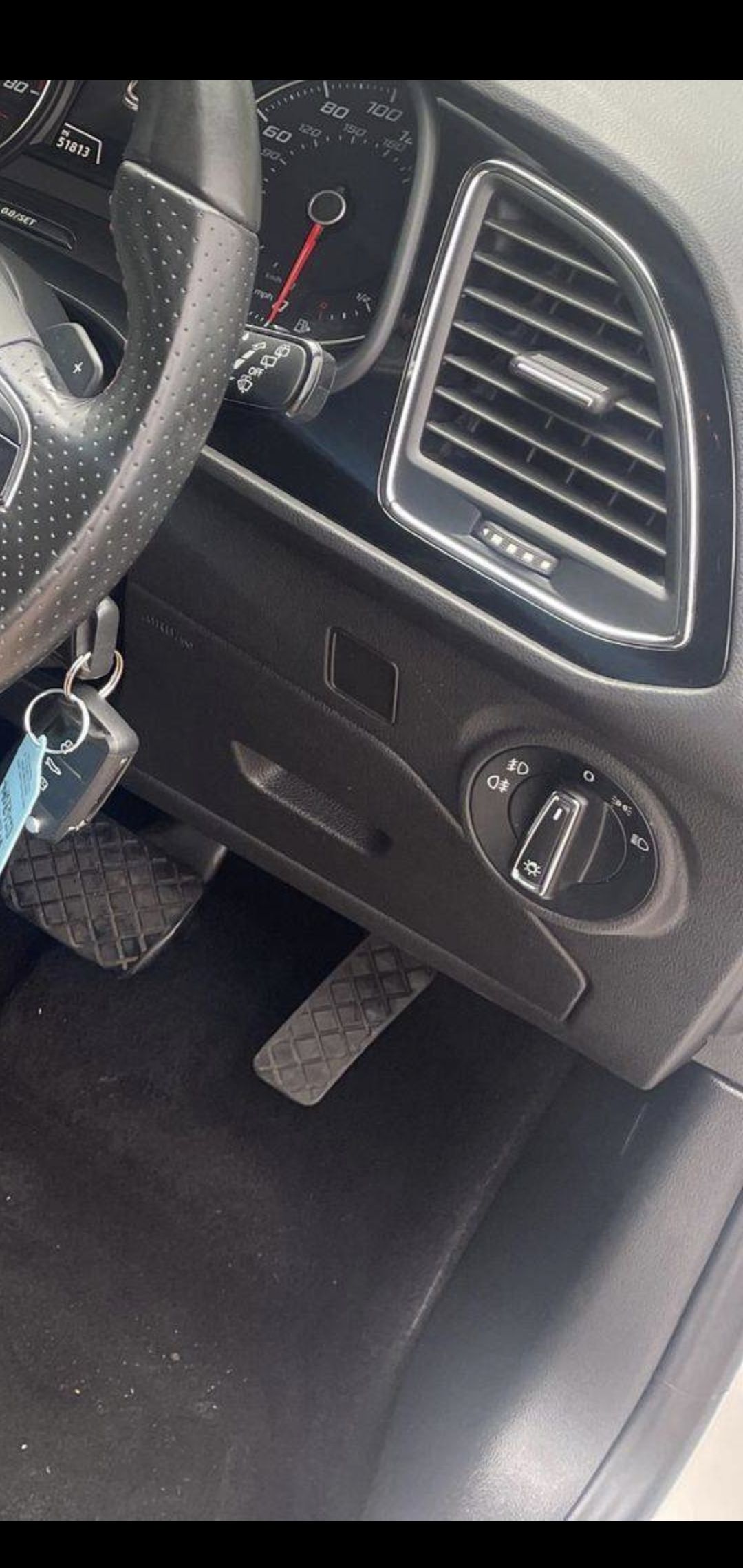

Hi all new to the forum. Picking up my 2017 Leon Fr this week!
It has just hit me that on the pictures the light switch to right of steering column there is the option of off, sidelights and then headlights. There is no auto setting. The car has the full Led headlights.
I thought the car had nice looking led daytime lights? Do I have to manually turn my lights on and off like an older car? Any help would be much appreciated to understand the function. Thanks in advance!

The car does have DRL lights, probably front and rear for that age model which will be on all the time - you cannot turn them off.
Unless the switch has the auto option then yes, you're going to have manually turn that dial all the way around to dipped headlights when it gets dark. Same with the switch for dipped and high beams, it's manual operation only on that model.

As above, DRLs are always on unless you expressly alter the coding for them. The auto lights option is only available on cars fitted with the optional 'convenience pack', which I appreciate is crazy on such a modern car!
