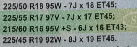

Since these are my options:
I need to stick with ET45 :)
