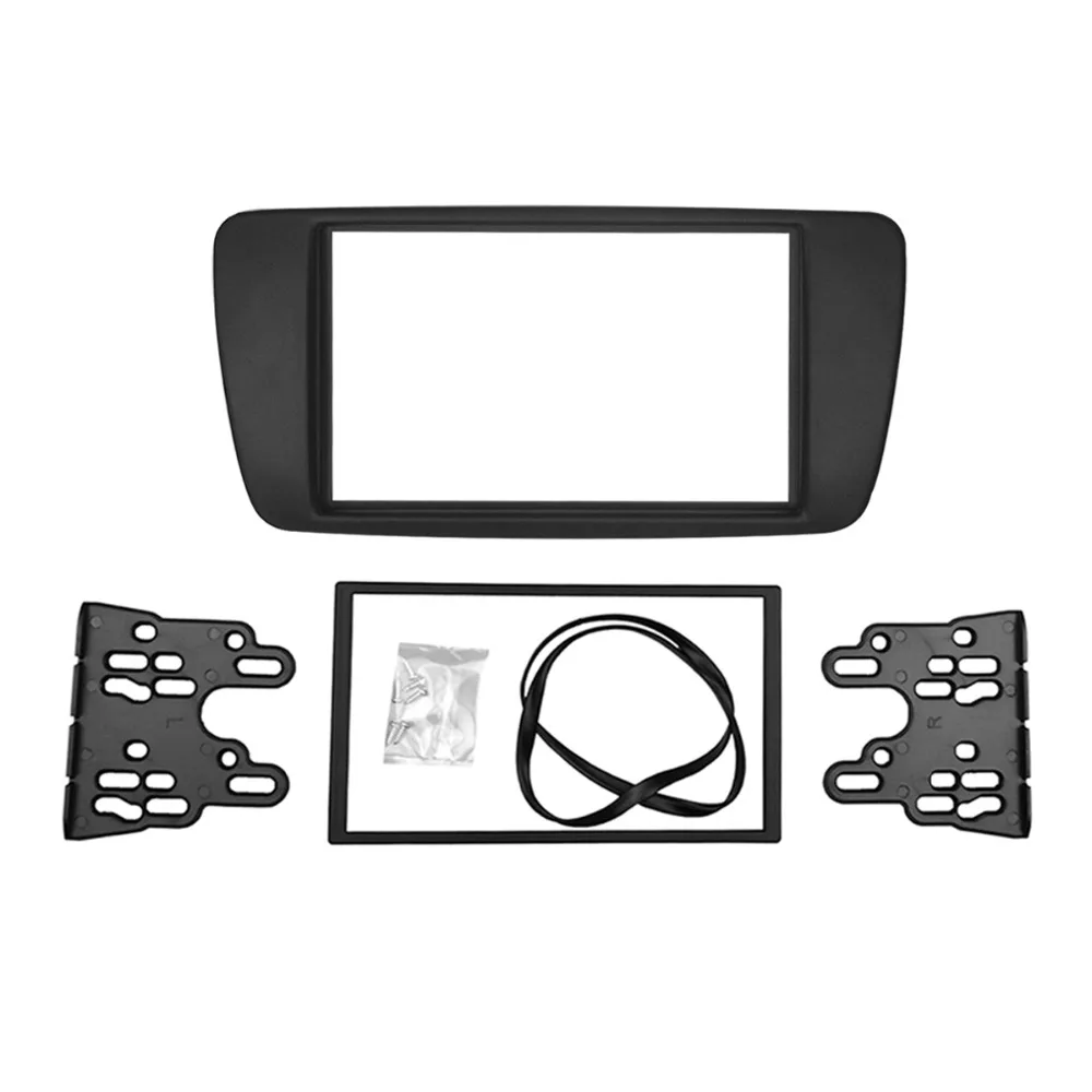

I already got this replacement part

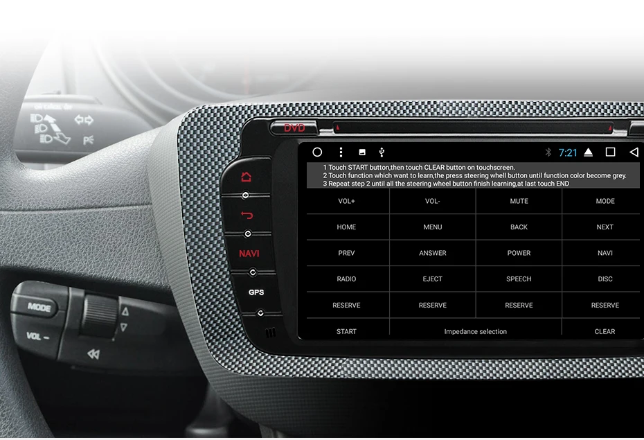

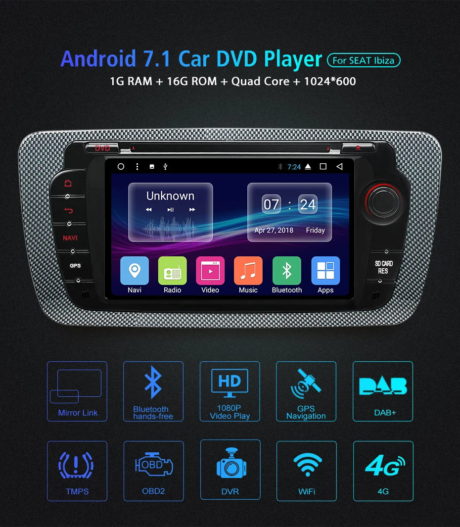

Option 2:
this
https://www.aliexpress.com/item/329...chweb0_0,searchweb201602_3,searchweb201603_52
SilverStrong-IPS-Android9-0-Radio-Car-DVD-for-SEAT-IBIZA-2009-2014-with-best-Radio-Mirroring.jpg_220x220xz.jpg_.webp
or this
Steering Wheel Control (CANBUS Box Provided)
The Steering Wheel Control function allows you to take easy control on switching songs, changing radio channels and adjusting volume from the buttons on your steering wheel.
This provides convenience and safety by allowing you to keep your hands on the wheel.
first option is new version of android , but im talking about the steer wheel control, the second one seems to support the ibiza built in controller , and the first one im not so sure, can you please help me with this? does both does not require the car wheel adapter?

You can buy the relocation harness on its own here https://www.vag-navisystems.com/mis...ights-esp-airbag-seat-ibiza-6j-from-2012/2355 not all that cheap tho and i dont no how good itl be, Or theres a company called incartec they sell all adapters and bits youl need for a double din conversion the relocation harness and double facia come together. I searched for the zenec for ages and never did find 1 for sale i no people had some trouble with certain buttons not working with it. be aware there is some cutting out to do in order for a double din cage to fit i have a pioneer in mine so assume itl be the same. As for steering wheel adaptor it looks like you will need 1 for the 1st option but it as it reads it looks like option 2 already has it included. I also needed a fakra to din adaptor to make use of the factory dab aerial. Hope some of that can be of use to u
