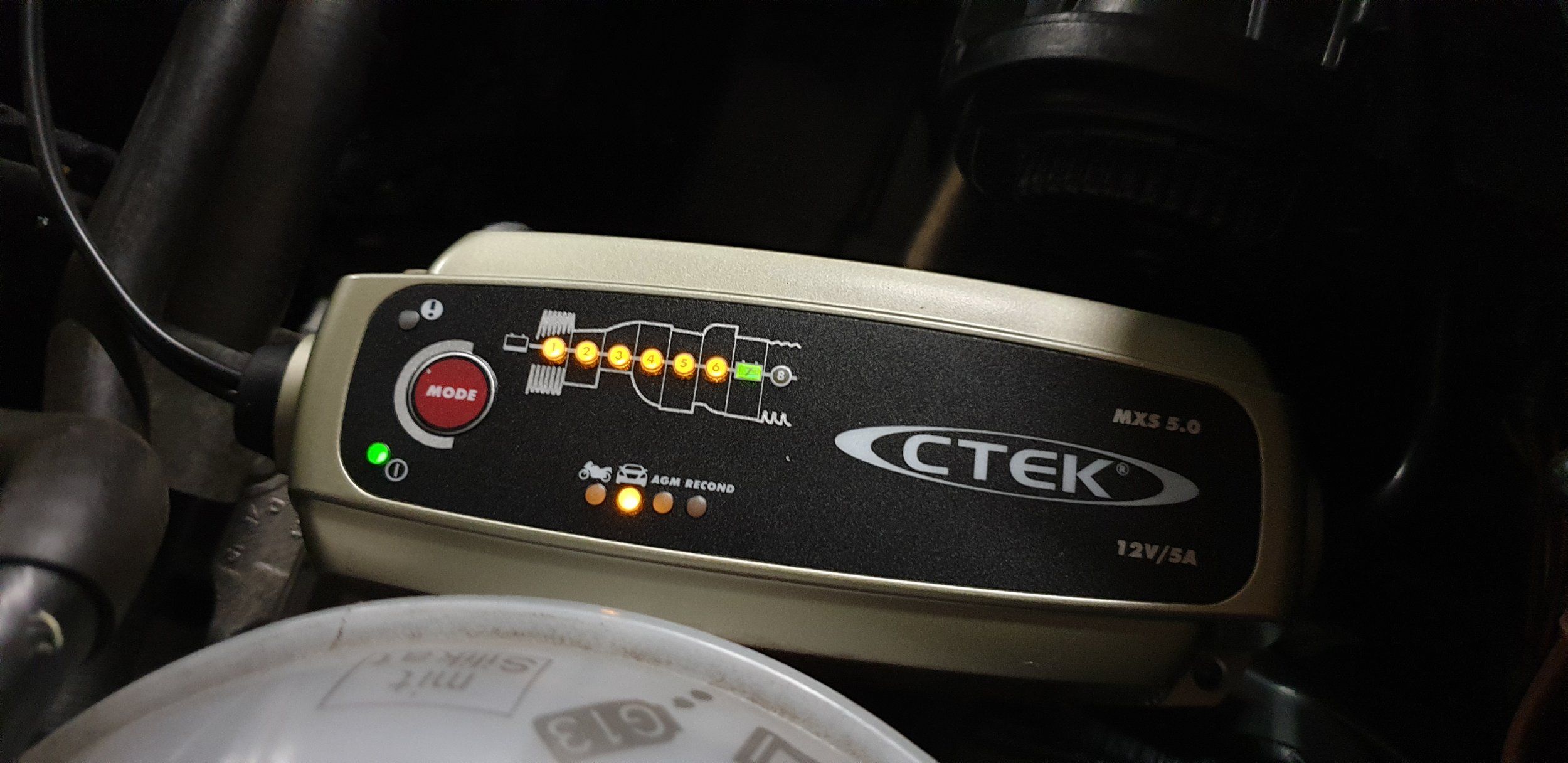

Happened two weeks ago:
The car didn't produce a single sound when I wanted to start it. Many error messages. Just 8v when I measured with "multimeter".
I have a Ctek mxs 5a. Charged my Cupra R 2018 battery and the Ctek told me it was "full", se pic.
Then i did monitoring of generator voltage with OBDeleven terminal 15 and 30 during driving the car. The battery charge was about 12,8 v. Not good enough! I replaced the battery and got 14,6v monitoring with OBDeleven terminal 30 (drove the car again).
Conclusion -The Ctek don't show the status good enough.
You need a new battery, my guess :).
My car is 5 years but not used so often, therefor the bad battery. Just 23000 km on the odo.

Thanks Swede same as you just checked my CTEK 5.0 and shows exactly the same as yours (up to the green float light). Just took the car out and everything normal, but I haven't got a way of measuring the Volts or Amps so I agree with you and I'll get a new battery.
Not sure what it could be if not the battery was very odd.
