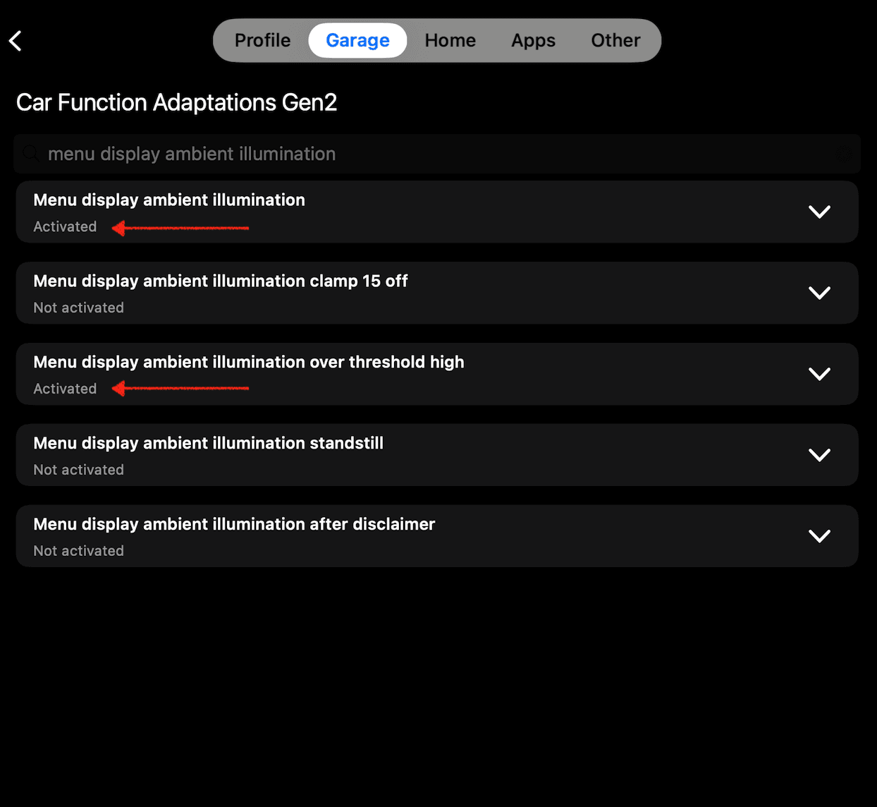

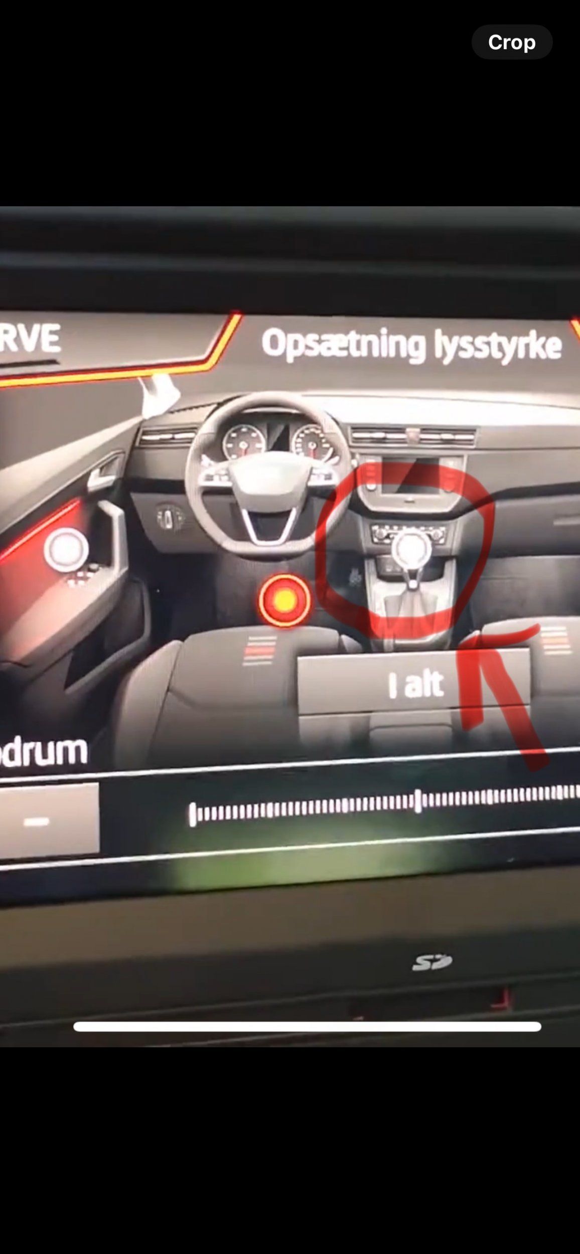

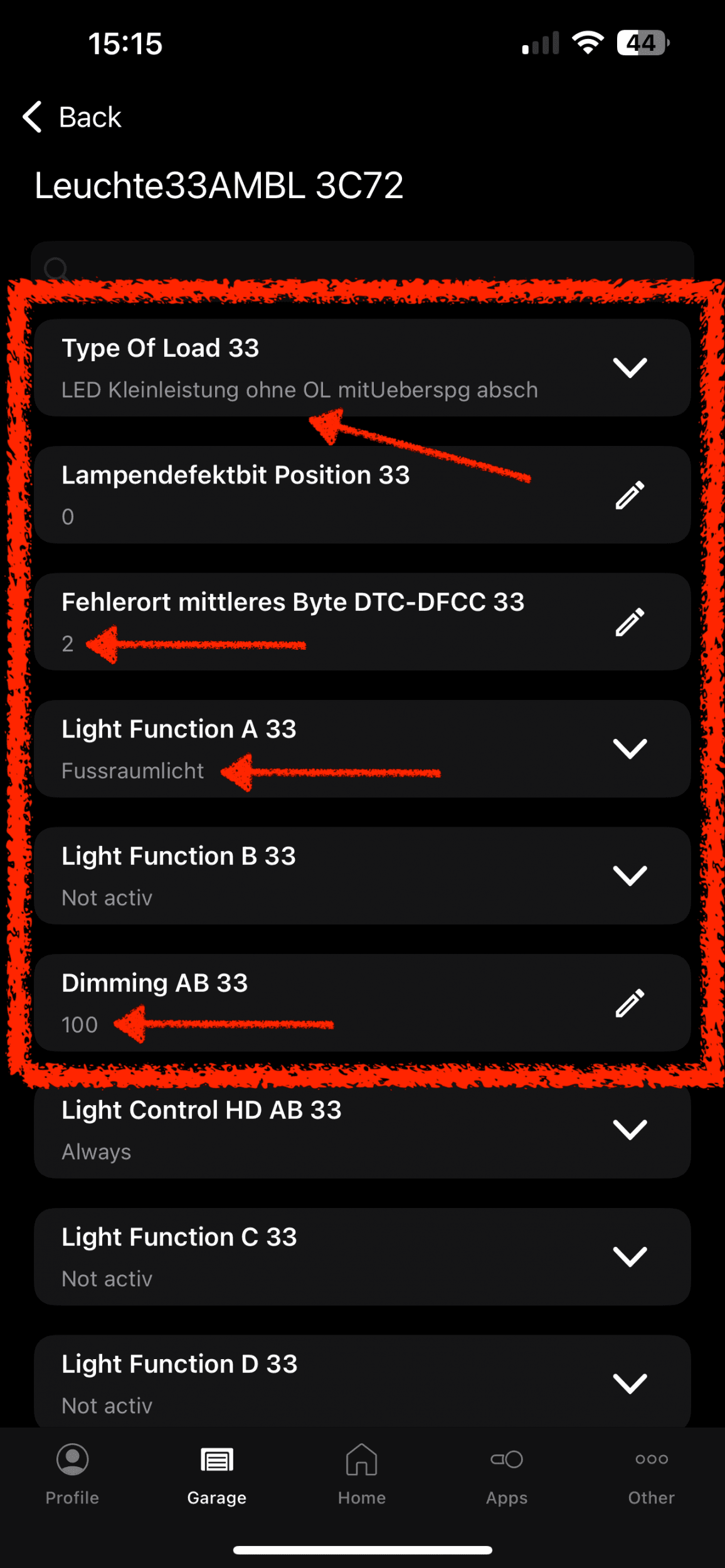

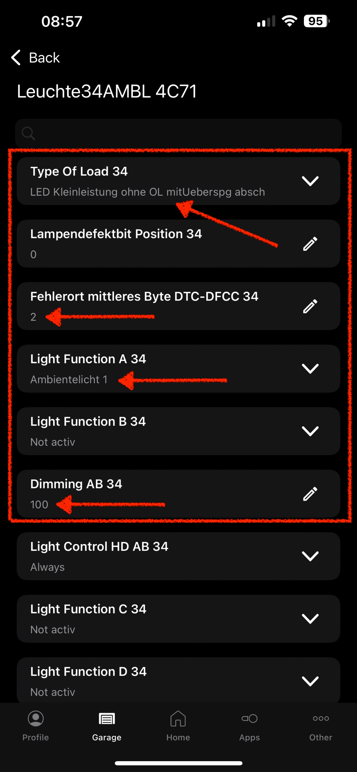

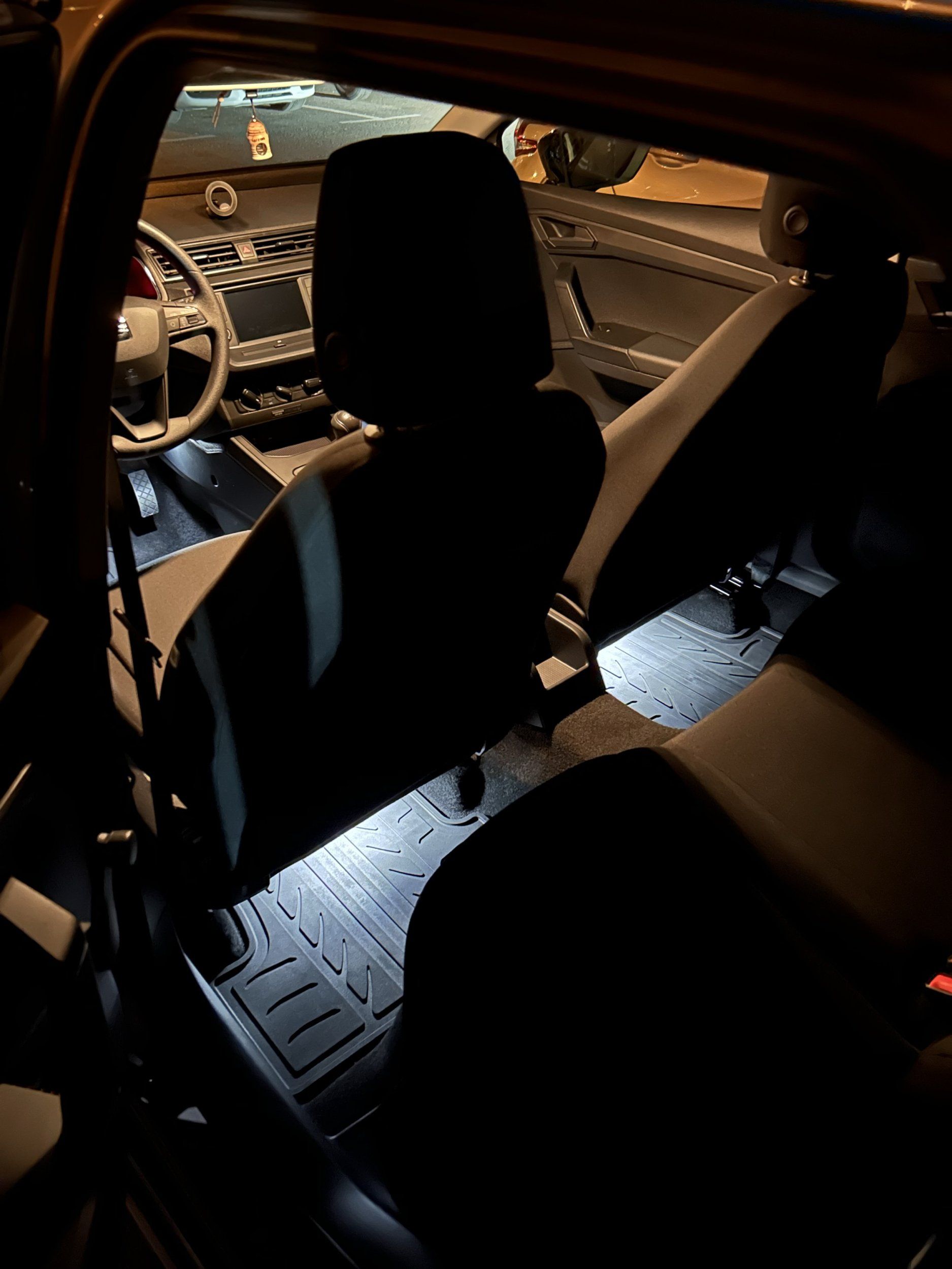

I have already installed footwell lighting and coded an Ambient Lighting menu in the infotainment system, dividing it into three zones with color-changing and dimming functions.
You can see pictures of the menu and footwell lighting in my car:

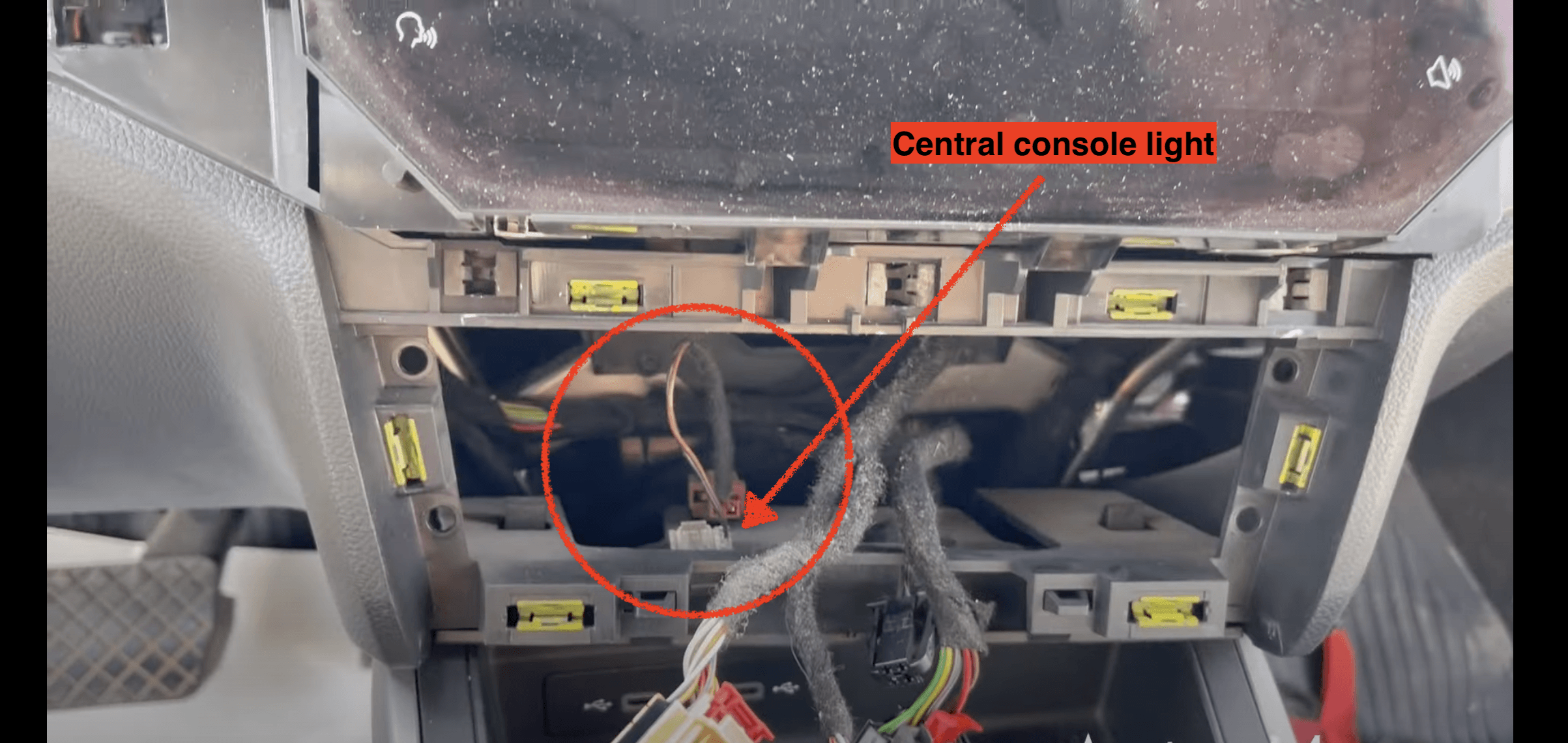

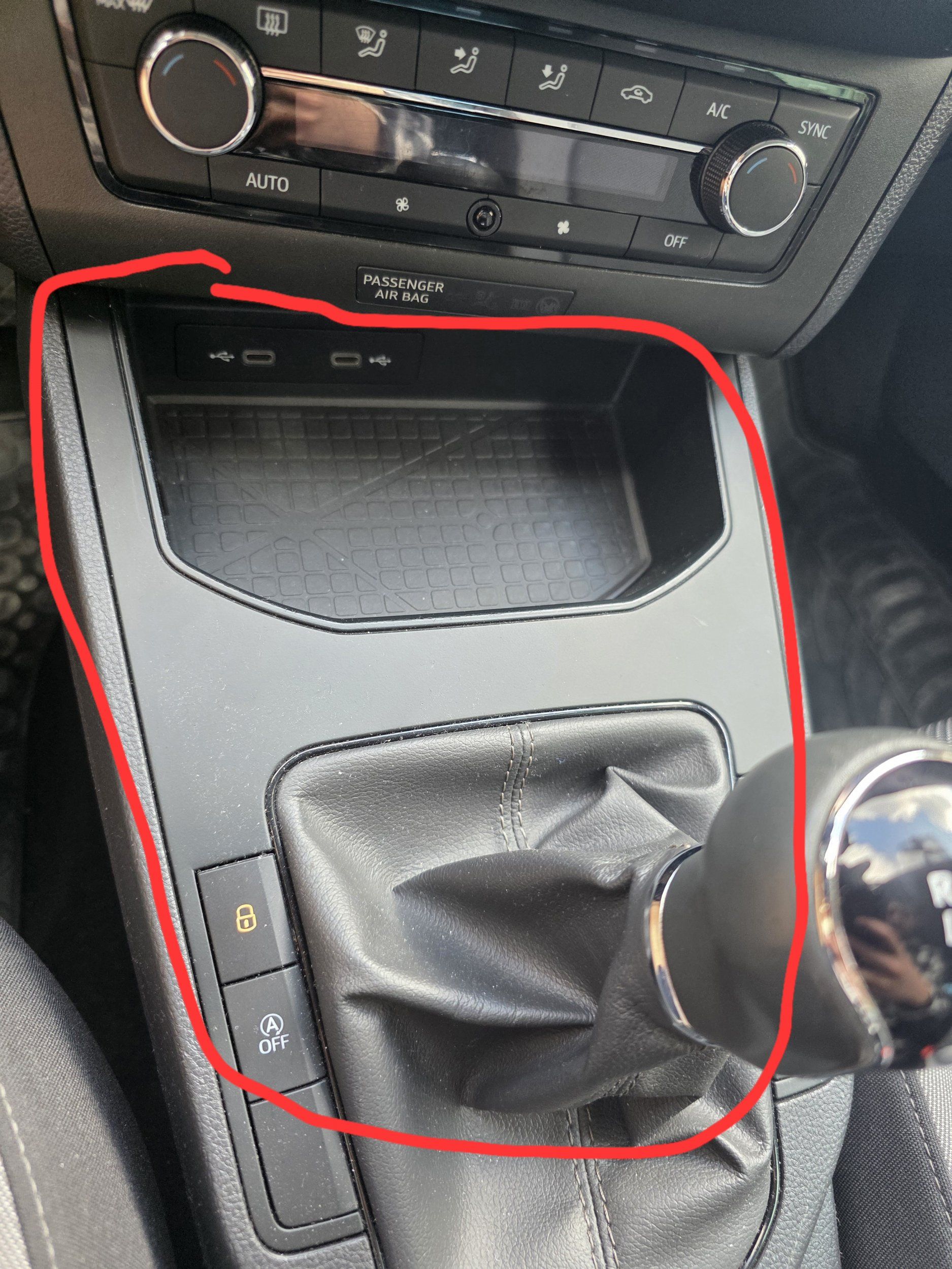

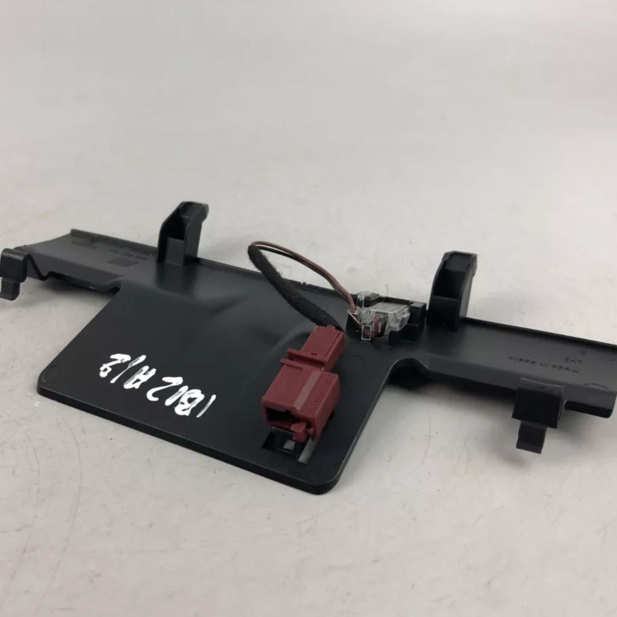

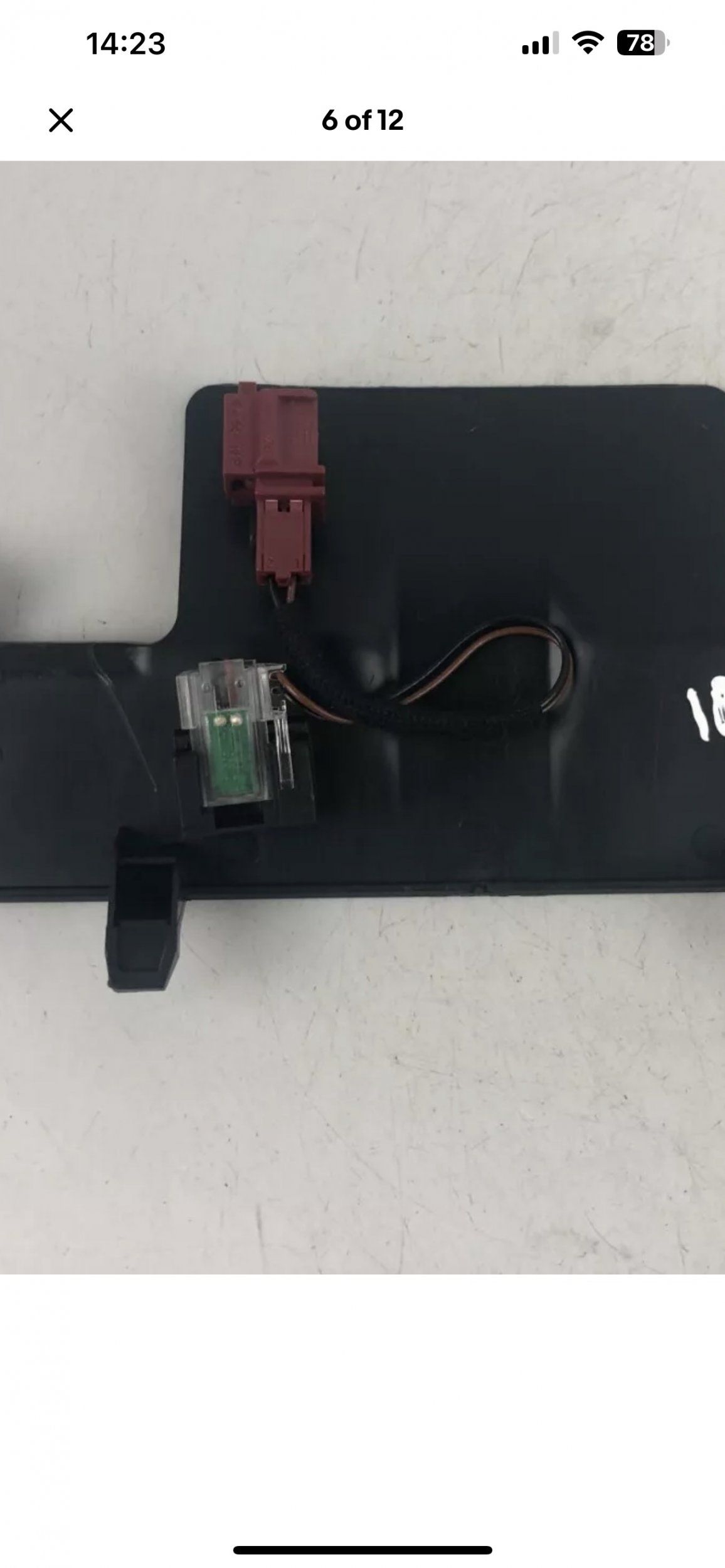

My next step is to install lighting in the center console above the phone storage. I found a part on eBay, and you can see the picture or check the link here

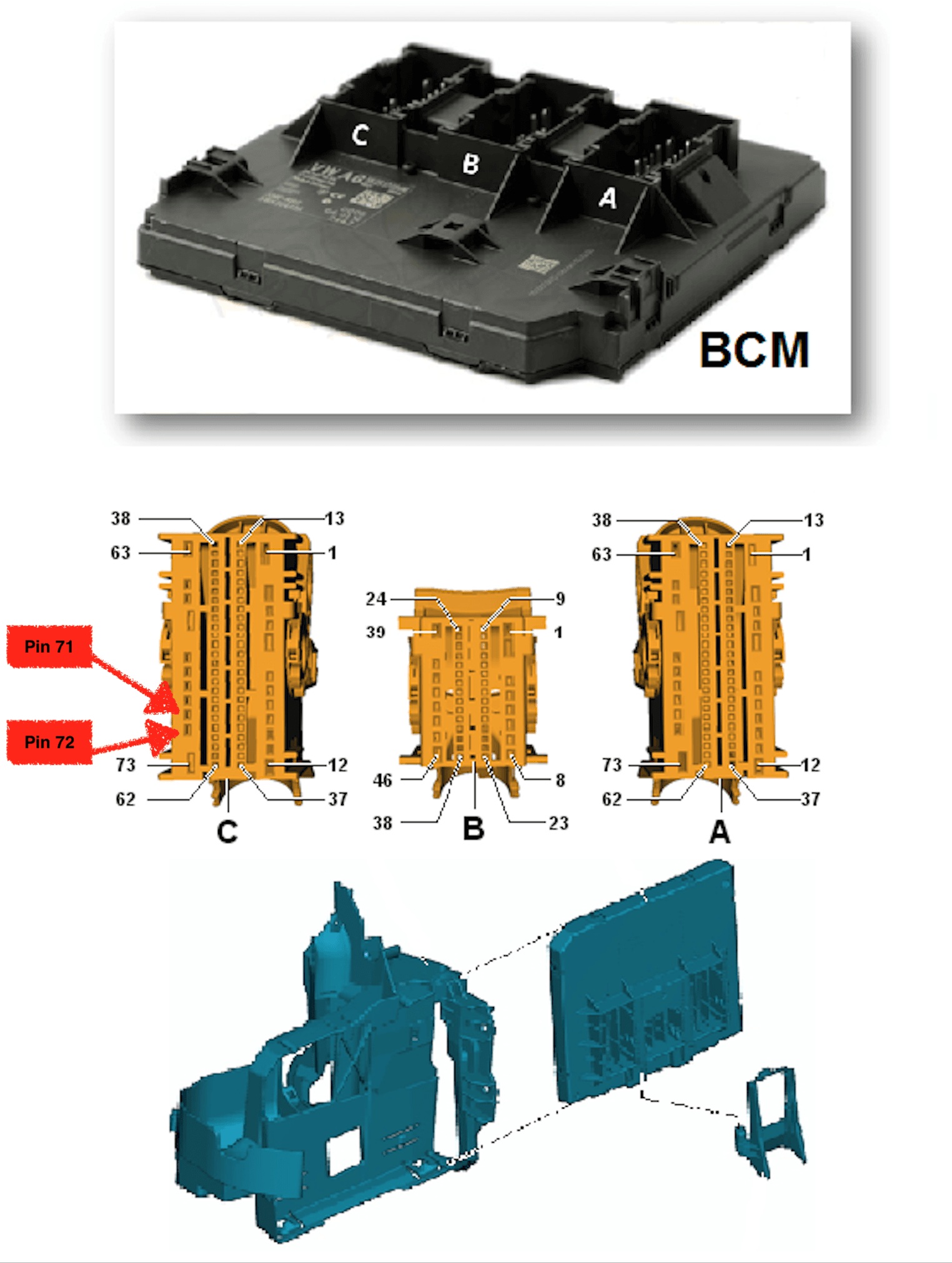

My question is: Does anyone know where this red connector goes? Maybe the cable is already in place and just needs to be connected. If there is no cable, is it wired directly to the BCM? If so, does anyone know the correct PIN, such as the footwell BCM pin is C72?
