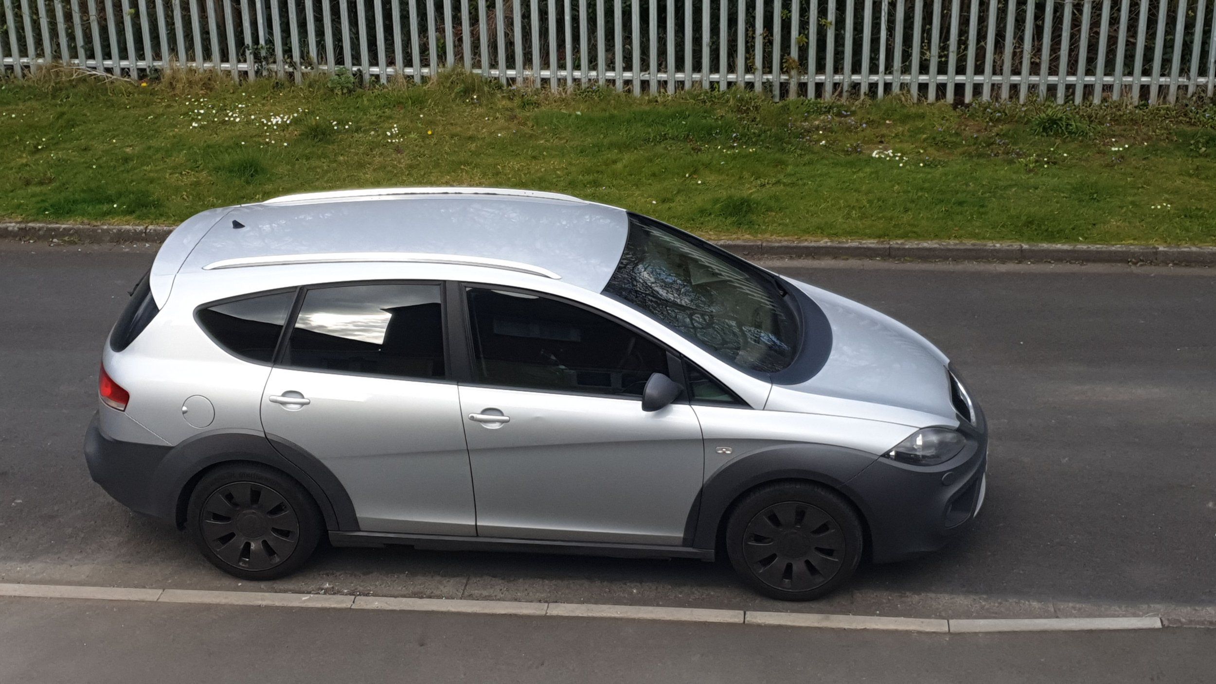

Hi All,
Just a quick parts list to lower a Freetrack with oem equipment.
Original ride height (not exact)
Fr - 84.04mm
Fl - 88. 42mm
Rr - 93.92mm
Rl - 92.94mm
Mk6 Golf R springs:
Part Number: Front - 1K0411105DC - Dots = brown/pink/blue
Part Number: Rear - 1K0511115BH - Dots = orange/white/yellow
(mine were used and had 30k wear when purchased)
The rest of the parts I purchased new through Autodoc app. They confirm all the parts fit, via vin number check before the order is placed.
GAS SHOCK ABSORBER (Rear): 19-127439 BILSTEIN
GAS SHOCK ABSORBER (Front): 22-139191 BILSTEIN
Dust Cover Kit (Front): 910177 KYB
Dust Cover Kit (Rear): 910002 KYB
Top Strut Mounting (Front): 1180S0171 RIDEX
Top Strut Mounting (Rear): 802 339 SACHS

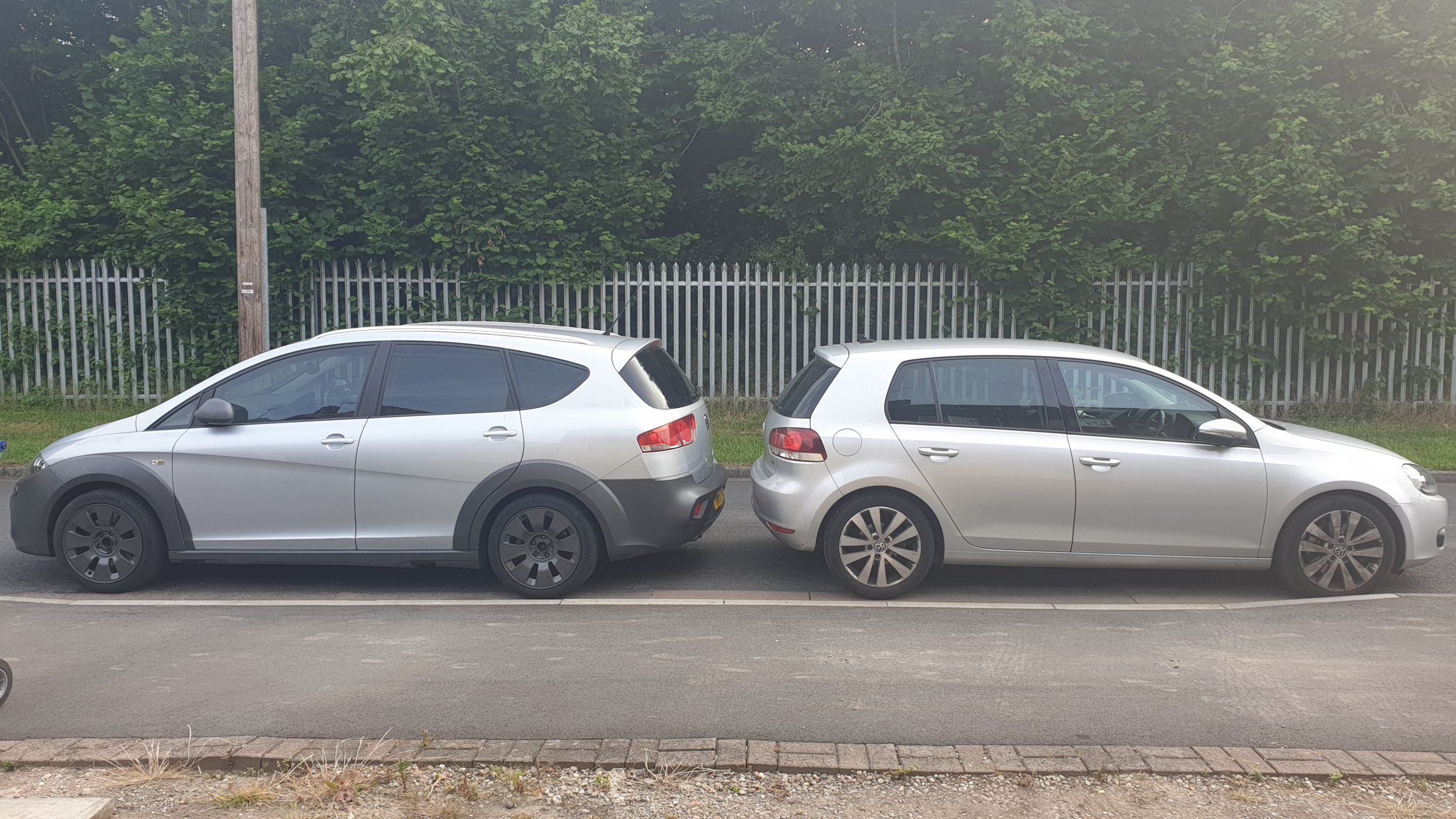

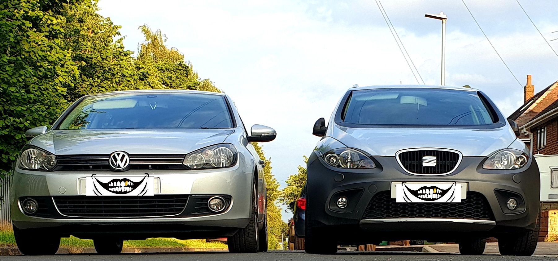

I've probably done about 15k with this set up and the handling improvement is vast. The Freetrack handled pretty well beforehand.. apart from It leaned alot under heavy lateral load.
Next to a mk6 Golf 1.4 TSI 160 GT

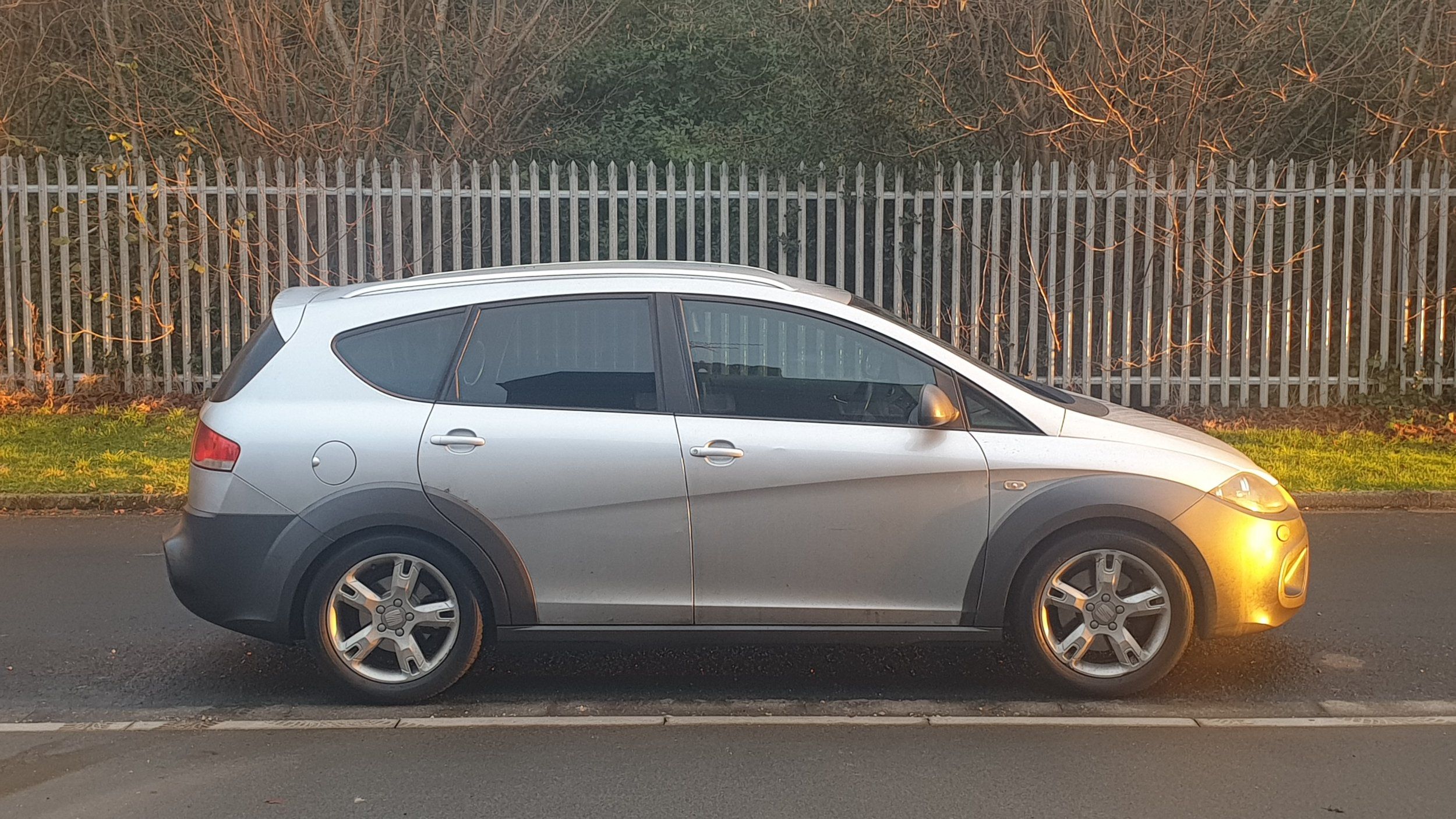

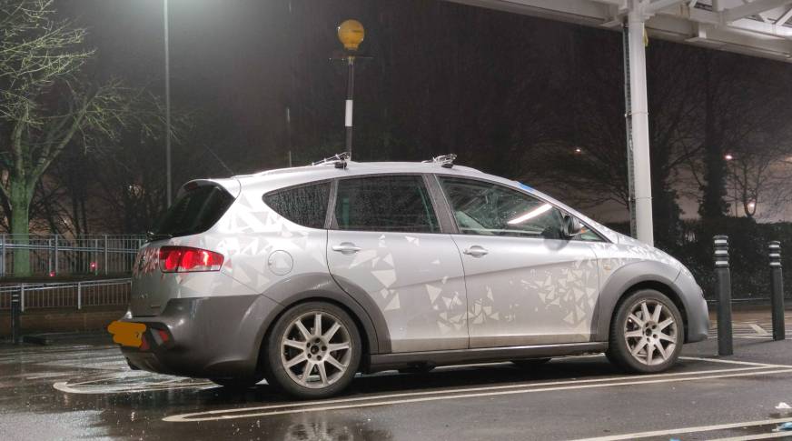

With winter wheels on:
Winter wheels

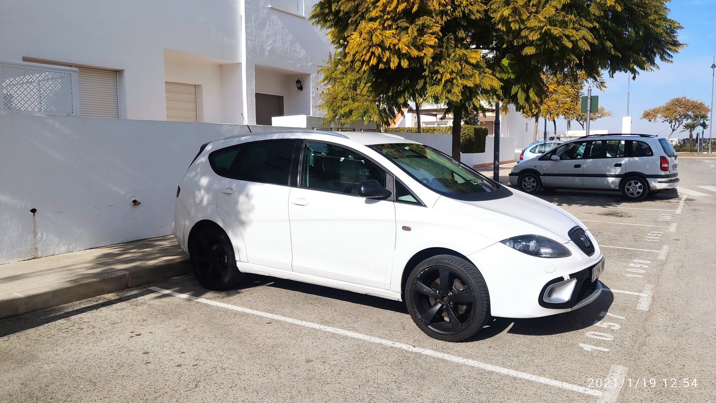

Hi Mendez, I'm new here and to be honest I just registered cause you just saved my life! No car shop could find lowering springs for my Altea, I guess they didn't bother to look deep enough!
I currently have a 19" set of Audi Rotor on it, but altough the handlig improved a bit, I need to lower it in Order to get rid of that awful body roll.
Can you please PM me on the options you know exist for that purpose? Thanks a lot in Advance! Cheers IMG_20210119_125423.jpg

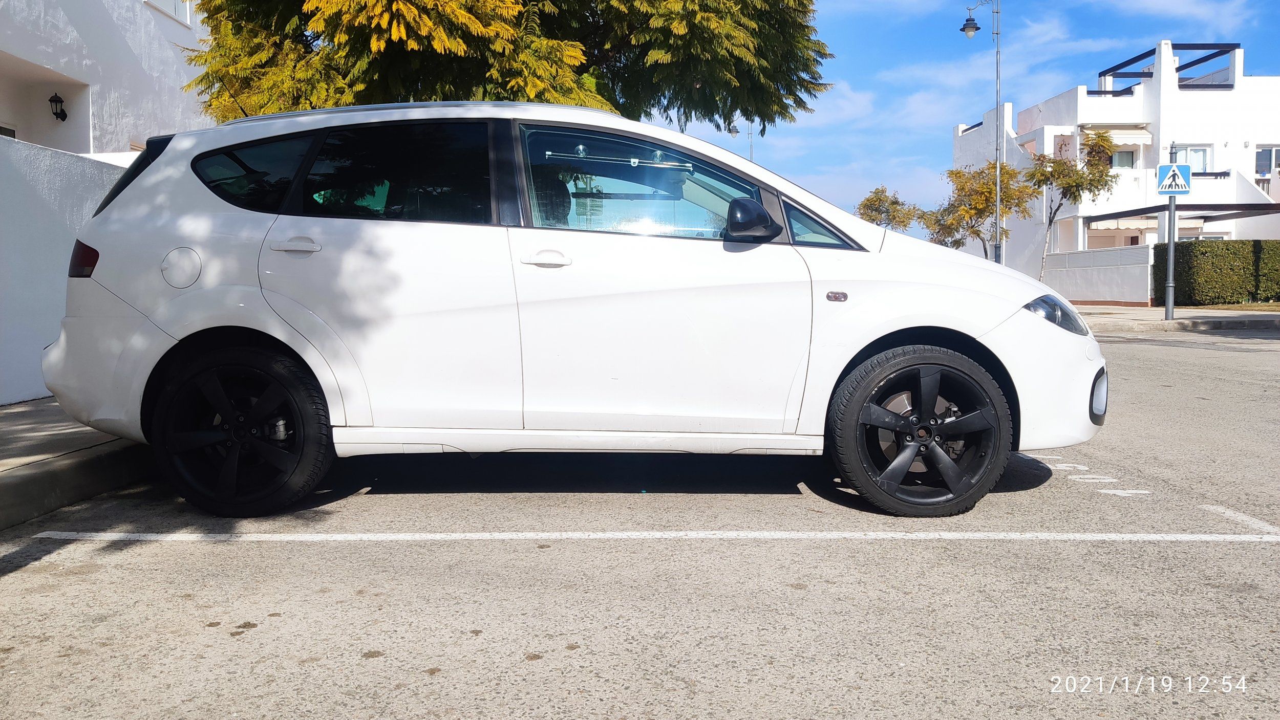

Thanks Mendez, I really looked hard to find a white one, I was very strict; I wanted something with only 1 previous owner and always assisted at SEAT, so it took me about a Year to find one, but it was worth the wait!
The rims are 8.5J with 43ET. I think they were from a RS4, not sure.
Currently still running the tires they came with in 255/35/19, but I'm looking to buy something with 245/40/19 measures as I feel the car to "stuck to the ground" when I accelerate and and a higher profile so I won't feel the bumps as much.

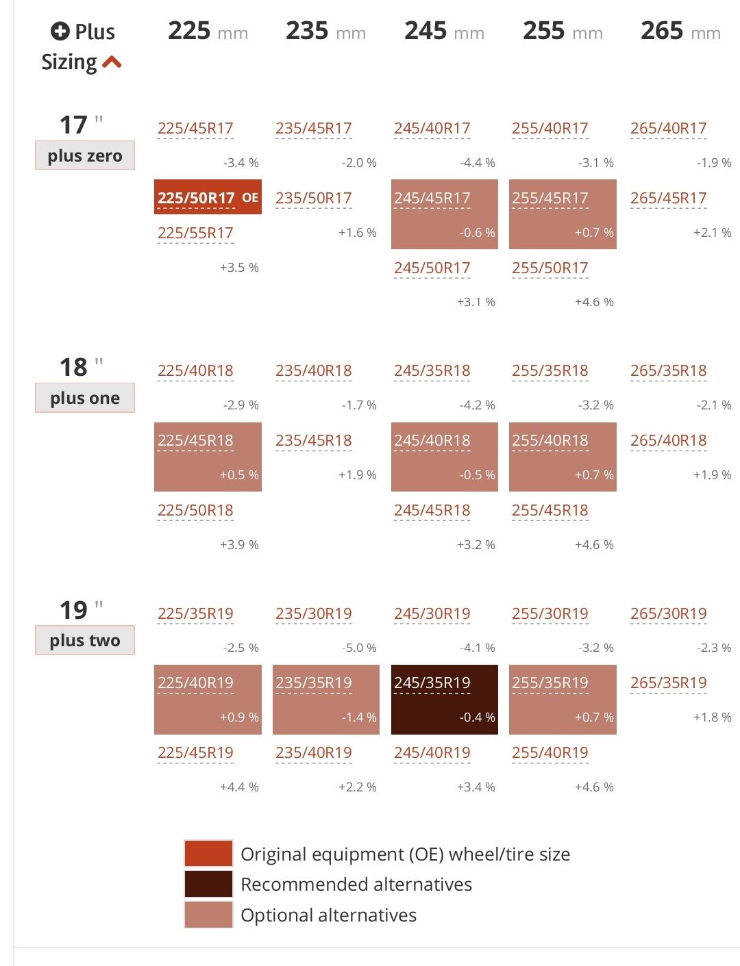

Well, I based my choice on a graphic (see picture)
I got for Plus One and Plus Two rim sizes, only that I upped the tire profile by 0.5 because I thought 35 was very low, but I guess I'll have to check it again.
If your ride didn't lose comfort I really have to take measures to see if I can get away with lowering 60mm hehe

Well, I based my choice on a graphic (see picture) View attachment 21857
You have to take into consideration the width of the wheel too. The standard Altea Freetrack wheel width is 7J and you have 8.5J wheels. Which is 1.5 inches increase in width. If you increase rim size, you have to decrease tyre profile to keep the correct/very similar overall rolling circumference

You have to take into consideration the width of the wheel too. The standard Altea Freetrack wheel is 7J and you have 8.5J wheels. Which is 1.5 inches increase in width. If you increase rim size, you have to decrease tyre profile to keep the correct/very similar overall rolling circumference
Which problems might I have if I get the 40 profile tires?

You would gain 6.9mm in tyre height. (which would mean less arch gap...but also less wheel clearance)

You could also use 245/35/19 (actually your best option for circumference) but 235/35/19 will give a little tyre stretch

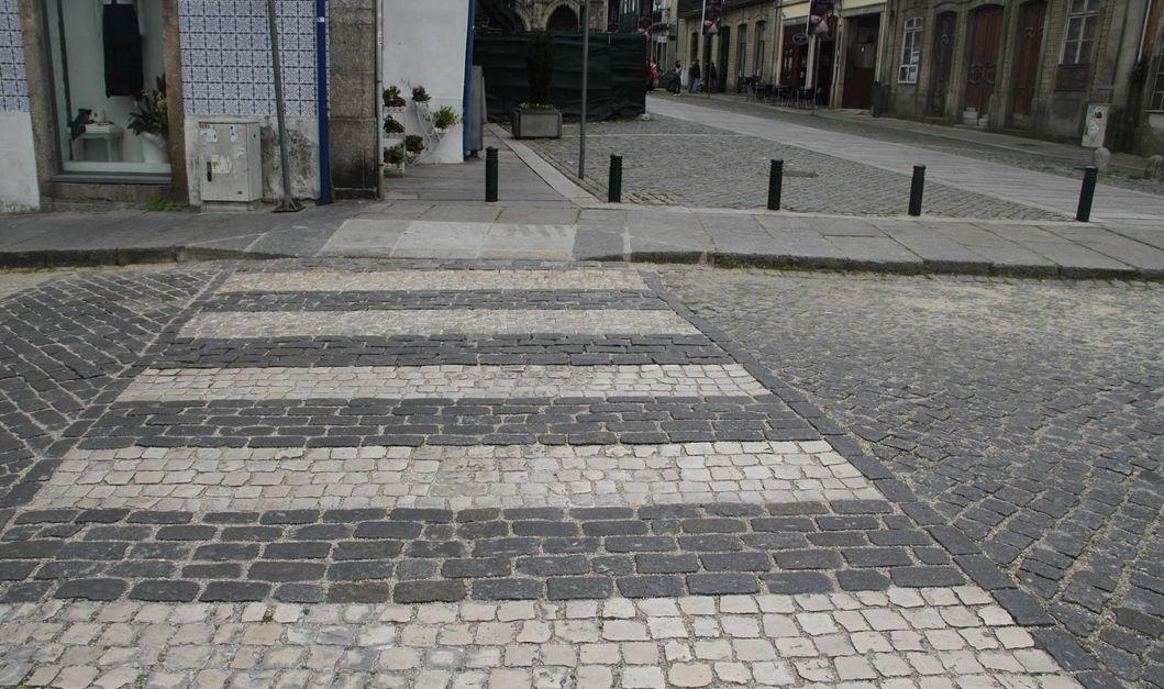

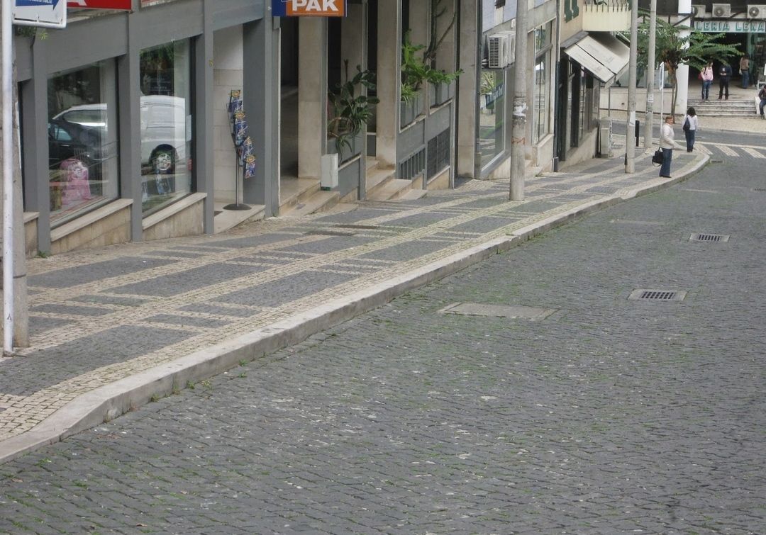

I mean, the roads are not awful, I'll leave you a few pictures here. IMG_20210210_144317.jpg IMG_20210210_144502.jpg IMG_20210210_144411.jpg
But I really can't consider going back to my 17" although I still have them in my Garage. I fell in love with the Audi Rotor at first sight, payed 1450€ for them, going back maybe I should've went for the 18" instead, but can't go back now 🤷🏼‍♂️
About the tires, the confort was the reason I was telling you that I wanted to go with 40 profile even though it's not the apropriate choice, just so I wouldn't compromise as much.
