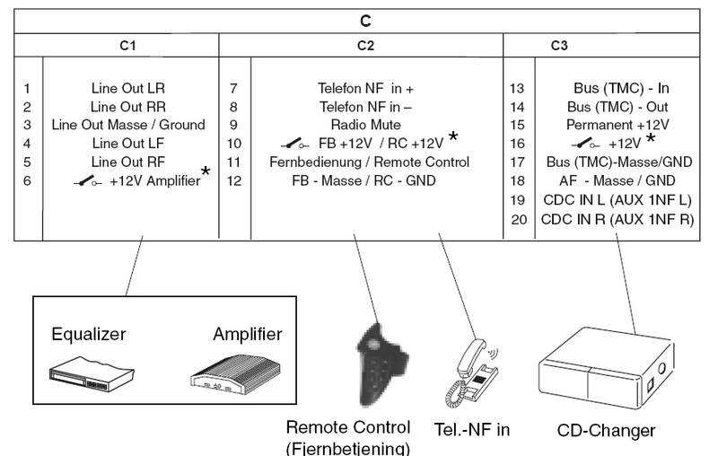

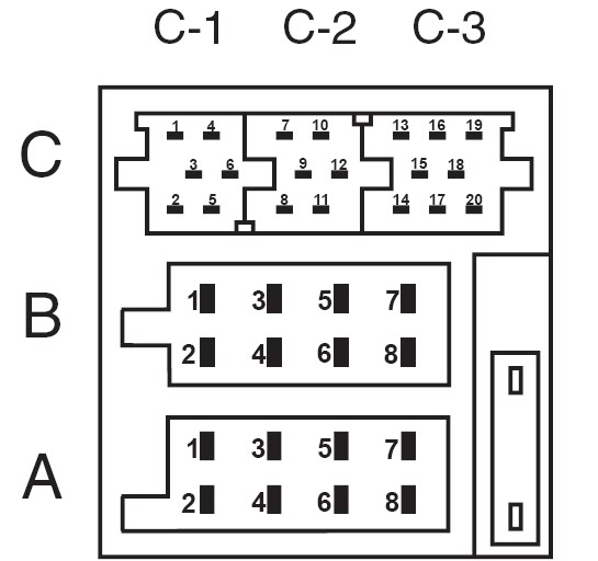

Thanks for the reply! What do you mean by "Tap into", and how do I do that? Sorry, it's probably a very stupid question but I'm very green when it comes to wiring and car stereos
Eoin
Sep 6, 2018
Looks straight-forward enough! For this do i need to split my red cable in 2 and splice into both ground and +12v wires? I was under the impression that the black wire with the ring was the ground?

yes black is ground , red is positive . I found it best to use the radio wiring ground , wire going to pin 8 for the black.

I was doing some thinking about it, and am wondering do you reckon it would work to run the red cable to pin 16 for the power? (Instead of having to splice open the power coming from the battery)
