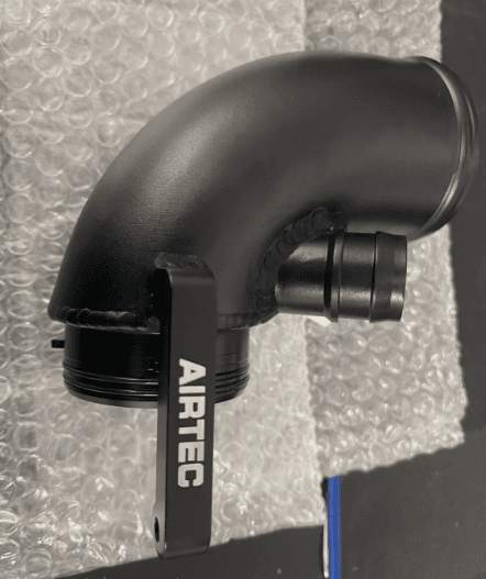

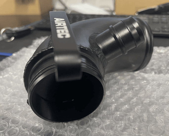

Hi guys,
i've found a turbo inlet for sale from airtec reduced. Mentions it fits the EA888 engine, would the turbo inlet be the same on the EA888 Gen.3b engine also?
I have contacted them and checked there website but it looks like they only have the Gen4 one now so I can't compare the one listed to fit EA888 Gen.3b engines.
Both the 190 and the Curpa's EA888 engines use the same part number in the catalogue (5Q0129635T) so It should fit either!
However I would question why? this will absolutely not be a restriction on your engine (you will not see any performance gains) - and you can't see it, so it won't even to make your engine bay look 'nice'!

Looking at the R600 intake before remapping so thought whilst I'm replacing the intake I may as well do turbo elbow and hoses.
Managed to find a brand-new airtec one for £50 instead of Racinglines £140 one.
