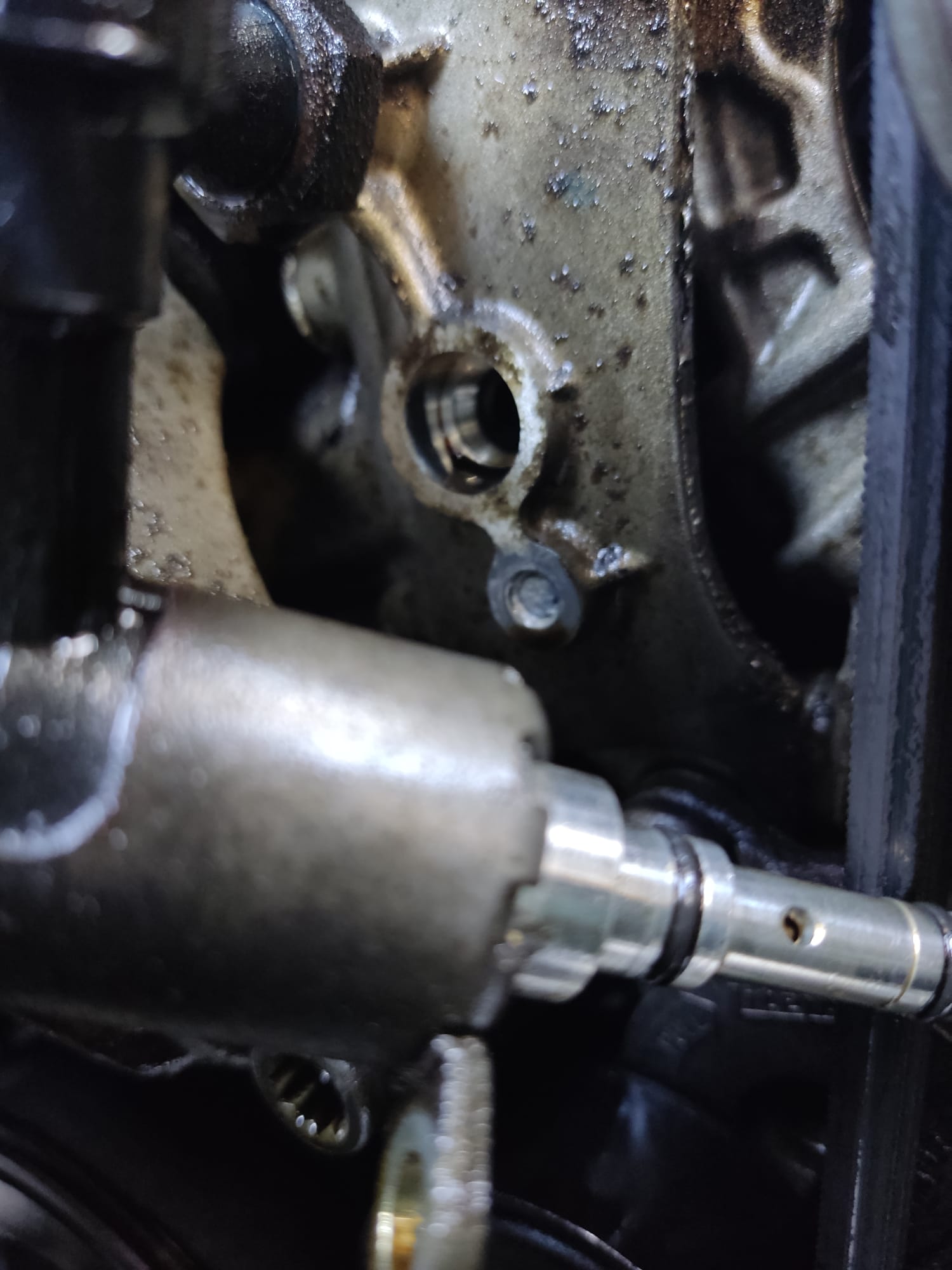

A few days ago, heading down the motorway "Low Oil Pressure" warning flashed up on the dash and advised to immediately stop. Pulled off the motorway and switched off the engine. Called road-side assistance and the mechanic identified that the "piston cooling jet" had popped out and the bolt had sheared off (image attached). We were lucky to extract the bolt shaft and put in a temporary fix (now replaced with correct bolt). Put fresh oil in and started the car.
Was a little lumpy to start with but as oil got round ran really smoothly. I asked the AA Mechanic what could have caused the bolt to shear off like that and he suggested that it was possibly overtightened and as oil pressure built up is just snapped off.

A couple of days later, started the car in the morning an it sounds like a diesel. Lots of rattling and a bit lumpy.
Went back to the mechanic who without any diagnostics said "mate, needs a new engine" and suggested something had broken and caused the "piston coolant jet" to be forced out. That makes no sense to me as after the incident the car ran smoothly for 2-3 days. If there was a "broken" part it would have not taken three days of motorway and general driving to show up (maybe I'm wrong?)
I pulled off the sump and checked the strainer in the oil suction pipe, cleaned it out (was very small amounts of dirt, nothing major). Replaced the oil filter and filled oil. On startup was noisy as the oil got round and then sounded fine for 20 seconds, but then rattle and lumpy again. When revs are up, above 3.5k the rattle disappears and all seems fine, as soon as the revs drop there's a "timing" issue, which I think it caused by the low oil pressure.
