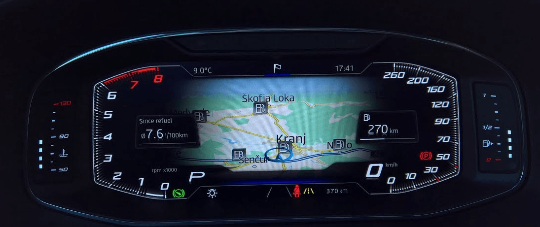

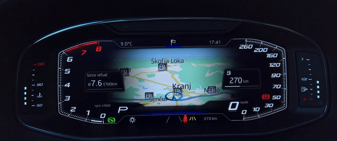

I recently purchased a SEAT LEON FR 5F 2019, which is very beautiful and all but it came with the digital dash and infotaiment system but no built in navigation.
My question is can I add OEM / Factory navigation without physically changing anything but more just "updating" the system with newer OEM code to include this navigation?
Do I need to add a SIM card of some sorts?
Sure I can just "use" apple carplay but that is not what I am after, what I want is the map being able to be displayed in the dash like the picture below, and that is not possible with the carplay or I have atleast not figured out how to display apple carplay maps onto the dash like below, Thank you.
I want something like this completely OEM (picture taken from google)

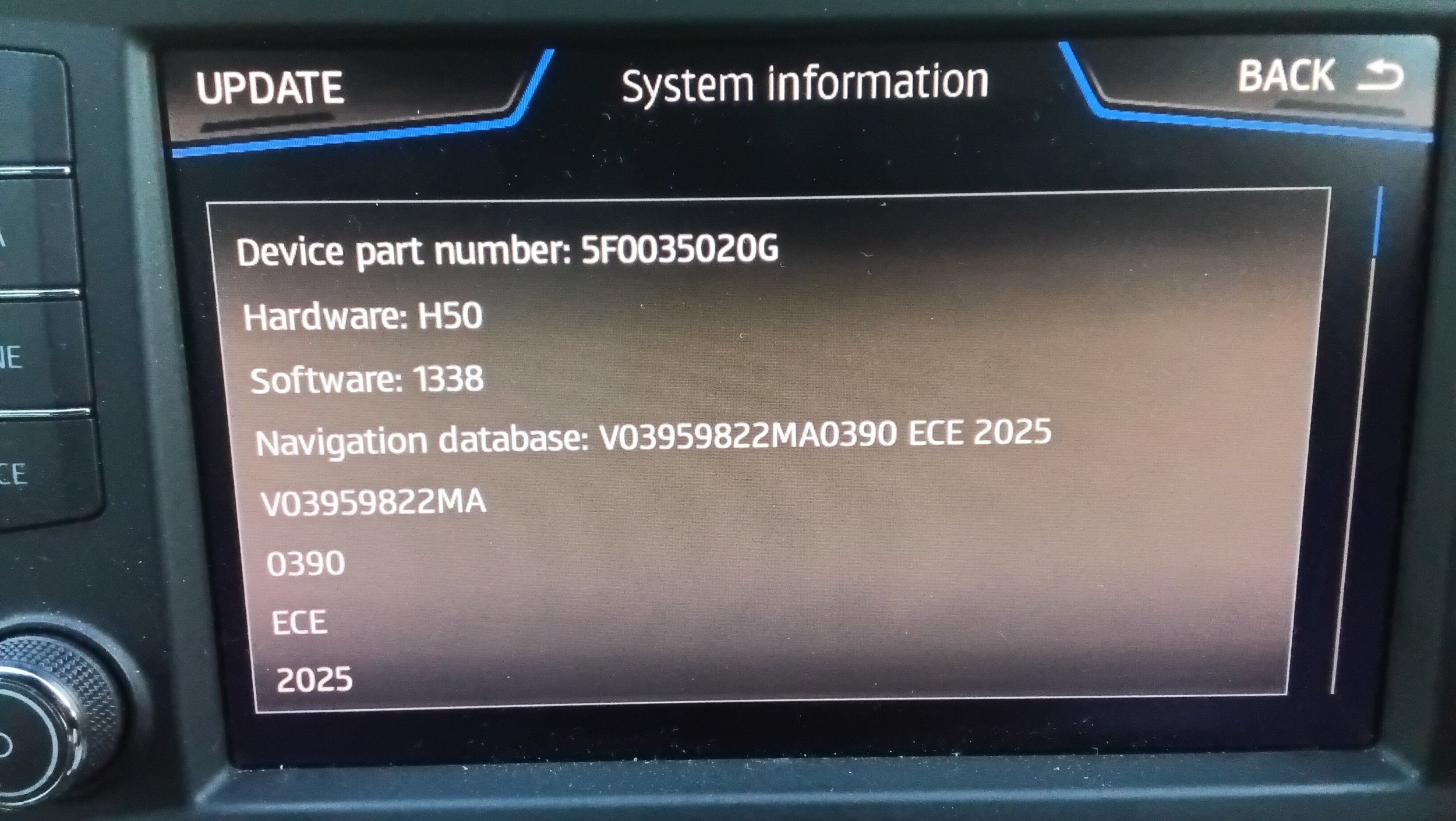

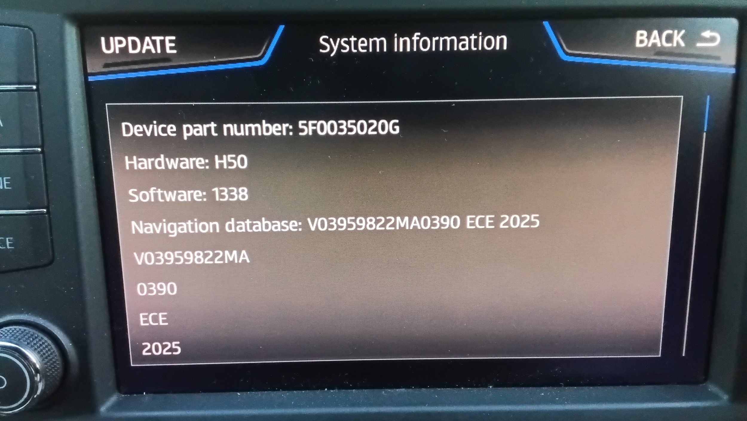

Menu, settings, system information. Top line. That's a mib2 high. Etc. Yours will be whatever that says.

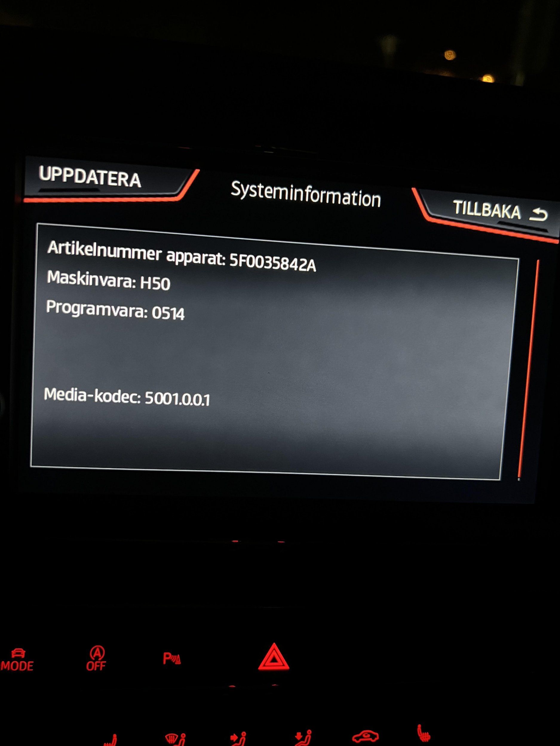

I have looked at my car and the information It has given me are only four rows compared to yours,
Device part number: 5F0035842A
Hardware: H50
Software: 0514
Media-Kodec: 5001.0.0.1
Assuming I have the worst computer in car then and the part number for a new car computer I should buy needs to be:
5F0035874A MIB2 Standard most
5F0035020F MIB2 High most
And obviously pairing it with the optical cable and the antenna/gps receiver
Mentioned by an earlier comment by "PaulusB"

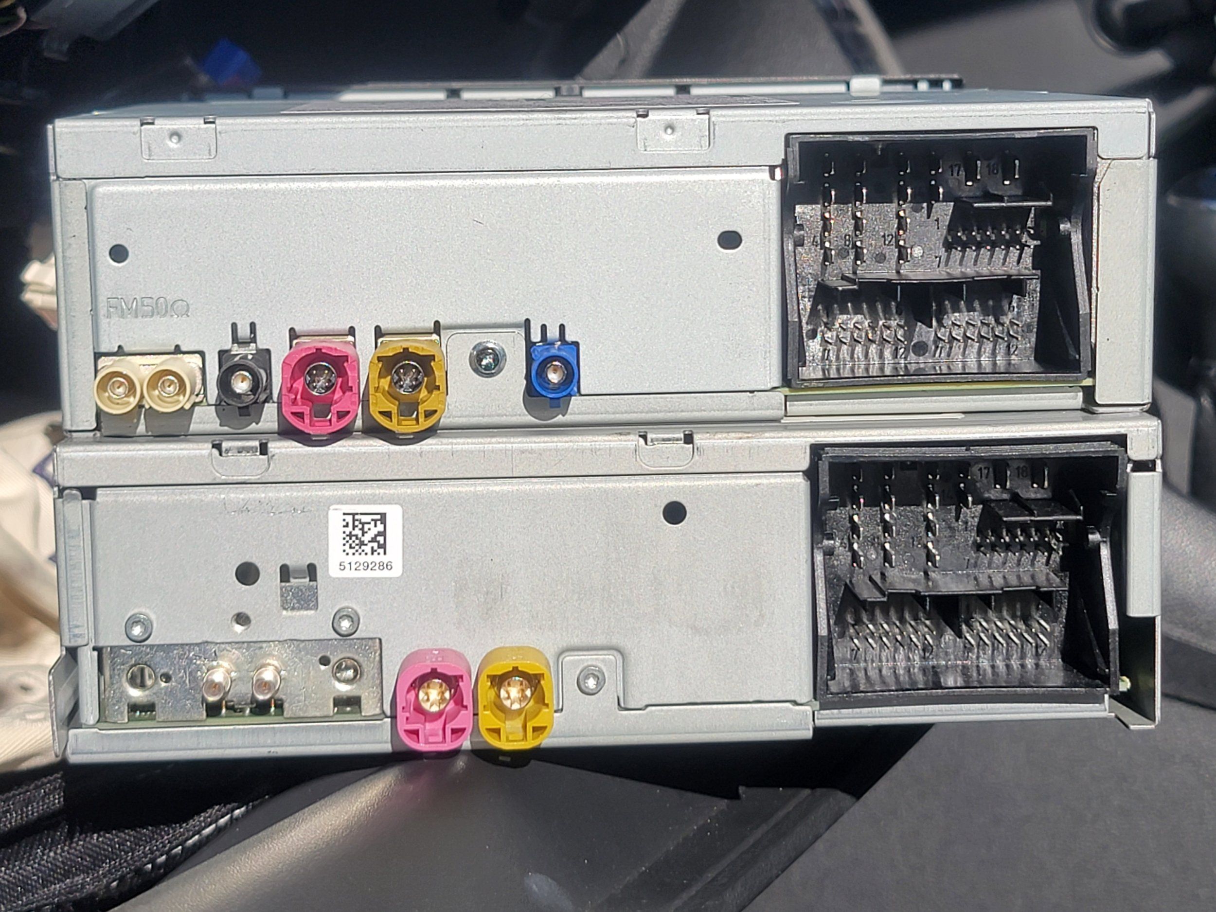

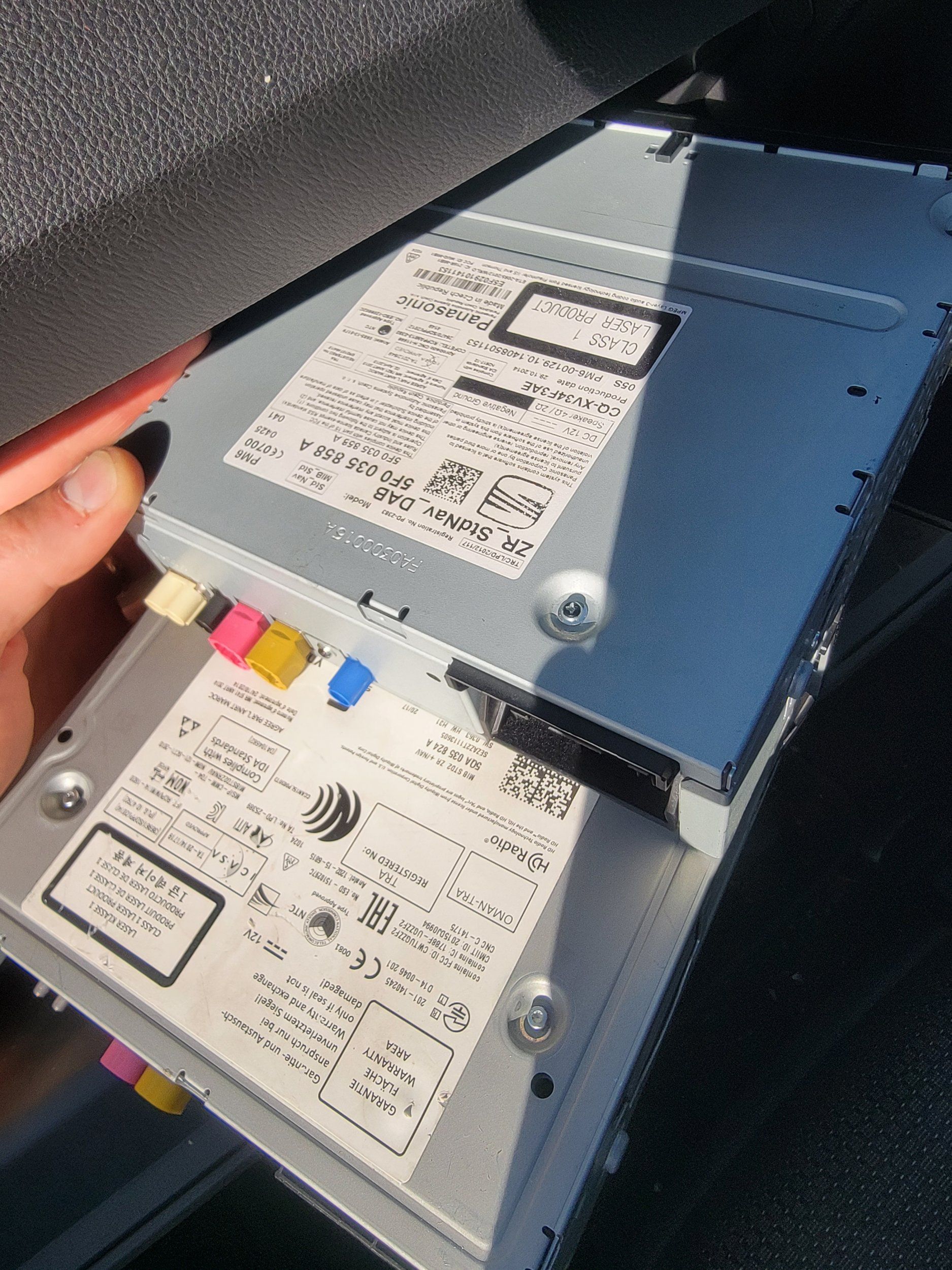

Coming onto this thread as I have a similar issue. I'm doing a MIB1 to MIB2 conversion though. I have seemingly purchased a MIB2 DIN unit without Nav. I'm actually wanting to use Carplay / Android Auto though fir Nav but want to be sure that I'm not making a downgrade here on the rest of the unit....
Pics show rear of unit and model nos.
Existing 2014 MIB1 with NAV 5F0 035 858 A on top.
Purchased replacement MIB2 5QA 035 824 A underneath
The screen MIB2 compatible screen I purchased separately does have a NAV button so this would at best just be non functional.
I got the MIB2 unit just over a week ago and DIN removal tools got delayed in post so only just been able to compare units. I am fortunately just inside the return window on the unit I purchased... Do I need to return it and find a higher spec MIB2 unit?

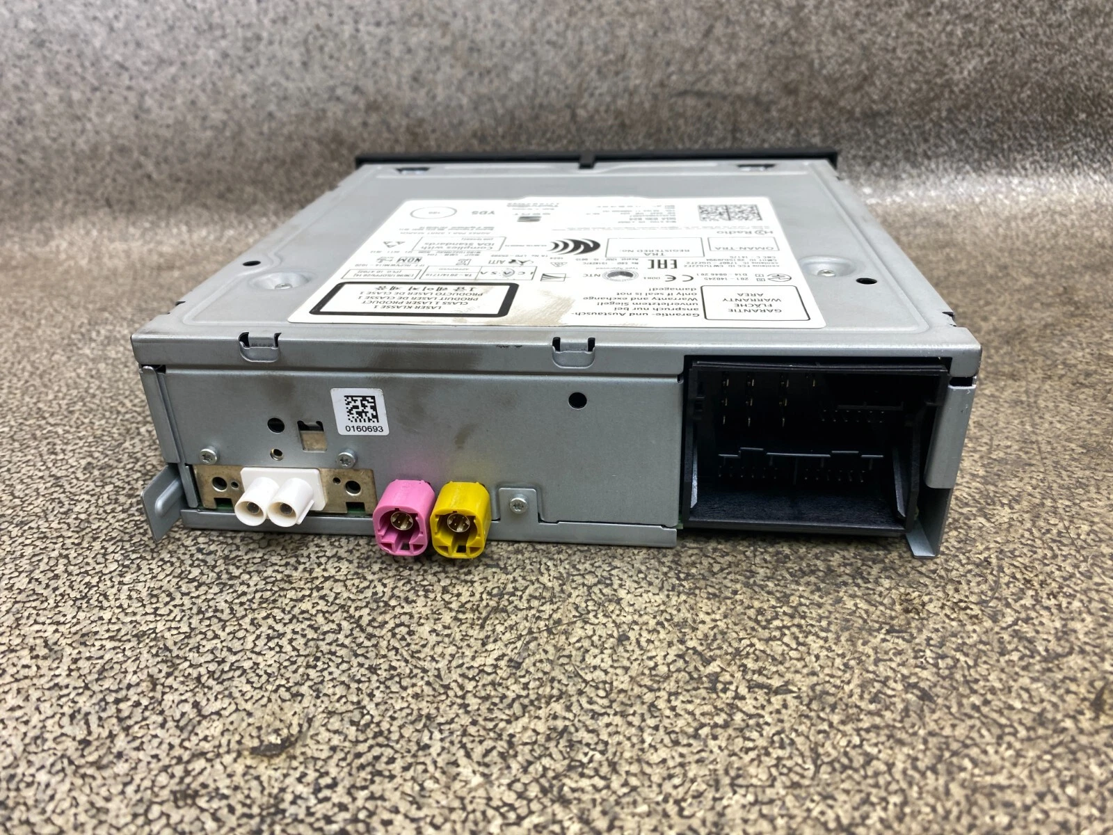

Apr 4, 2025
Found this thread also now.
Different MIB2 model to mine but demonstrates there are def better and worse MIB2 models for benefit of anyone else who stumbles across this... Bit of a minefield!
