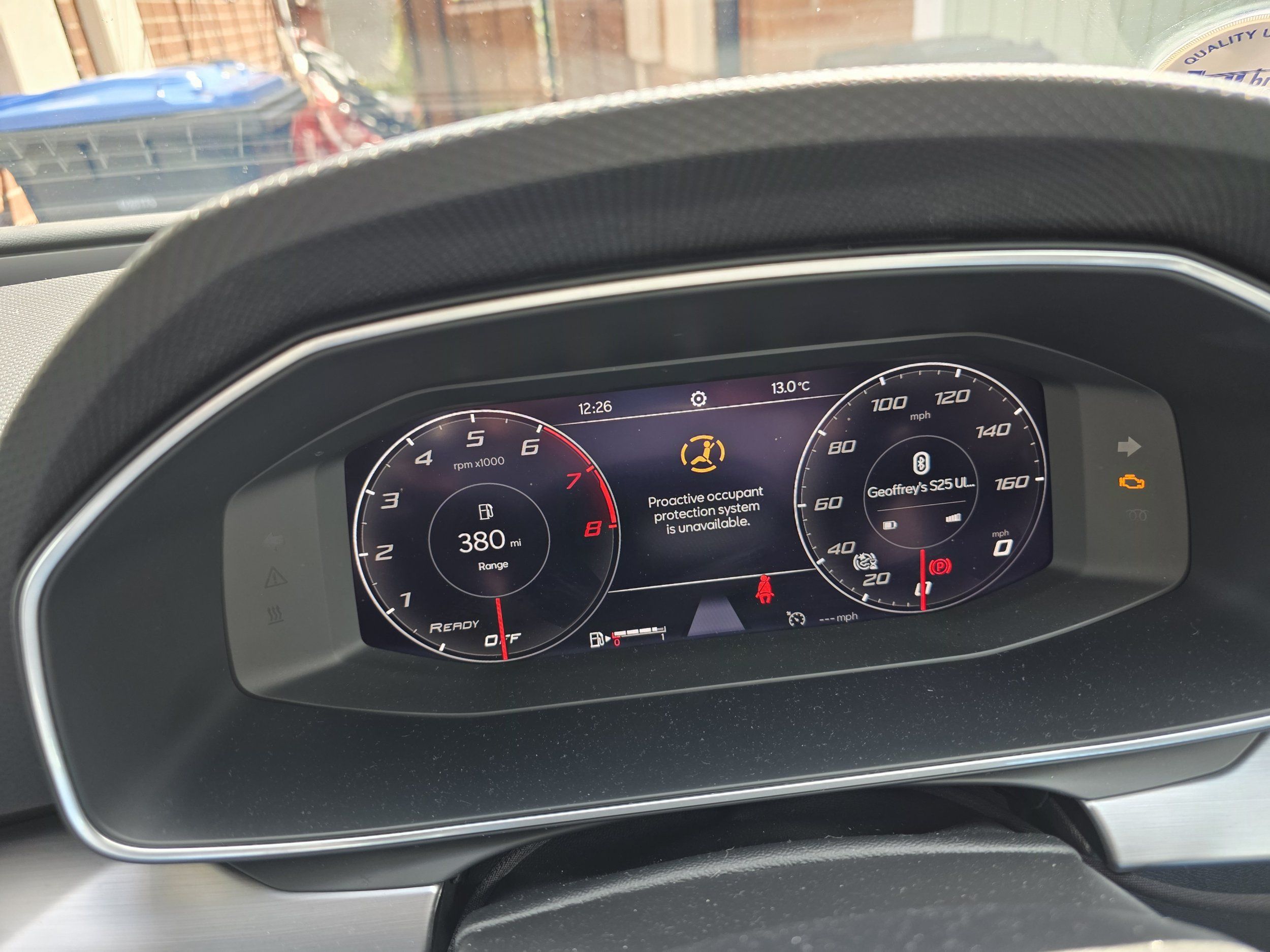

Hi,
I've got a Mk4 Leon but I guess this could be the same for a lot of the range. While driving down a national speed road I got the following warnings on my dashboard pop up suddenly.
1. Front Assist is unavailable.
2. Proactive occupant protection system is restricted.
3. Travel Assist is currently unavailable.
I've turned the car off and on again and the errors are still there. Is there an easy way that I can access the ADAS radar to make sure that it's not out of place for some reason? I've tried pushing it in through the grille but it seems solid and I can't get an amazing connection or much strength behind it.
Thanks for any advice!

Since the MQB EVO platform, there has been a procedure for fastening the seat belt. If this procedure is interrupted too often or is carried out incorrectly, an error will be generated for active passenger protection, etc. This is no joke. You then have to carry out a certain number of correct procedures in order for the error to be deleted. This maybe have triggered the problem for you.
Well, we're quite some way from April the 1st so I think I'm safe! I can't find anything from googling? Is this documented anywhere on here? I did just have a look in the guides but can't see anything.

mein Händler hatte das schon lange vor dem 1. Juli 2024. Er hat diese technische Dokumentation erst nach Rückfrage beim Generalvertrieb erhalten. Was ich aber vergessen habe, war ein Superb 4
Aber ich denke, es wird für alle gleich sein
Ich werde mit meinem Kontakt sprechen
