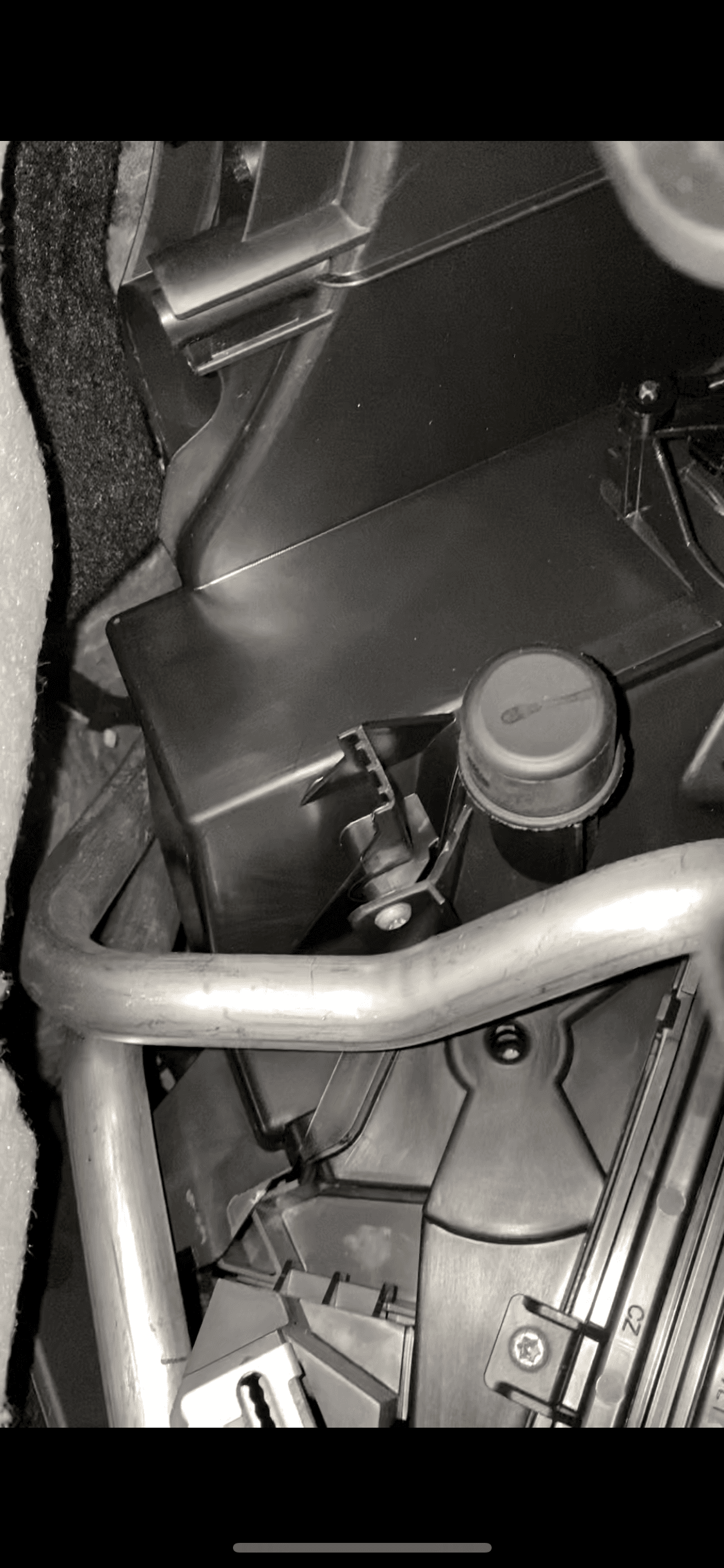

Hi,
can someone help me with where the ac drain pipe is located within the car?
I have taken off the trim on the passenger side and it seems to be blocked off where I feel the ac drain pipe should be (please see picture) although I maybe completely wrong!
any help is much appreciated!

Are you referring to the round rubber bumper in the middle of your photo?
This is not the AC drain - not actually sure what it is! guess its a rubber trim bumper/support?

In other words, the drain will be on the other side of the fire wall, ie in the engine side of that divider sheet of steel, normally obscured by the soundproofing covering in many cars, which is a bit annoying as sometimes they end up deformed when fitted, or due to the way it was fitted - so can end up being choked/closed.
Jul 8, 2021
I have managed to find the condensate drain pipe, as mentioned it is on the drivers side behind the foot rest.
mine has a small tear in it which could be causing the foot wells to be wet, is anyone aware of the part number as my local seat has advised it could be a lengthy wait :(
